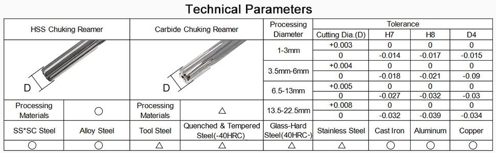

      I want to make a bushing with a 7mm hole specifically to H7 tolerance. I had a look for a suitable reamer and came across offerings from sourcingmap on Amazon which have the merits of being cheap and being on next day delivery. However I can't understand the table of technical info:
      I can't reconcile this with info from other sources which all tell me that 7mm H7 should be between 7.000 and 7.015mm. For example, the entry for 6.5 – 13mm above suggests that for a 7mm mm reamer D will be between 7.000 and 7.005 mm and the H7 column gives a tolerance of +0/-0.027mm. Which seems to suggest the reamer might actually cut under size. Am I misunderstanding the table?
      Perhaps I should steer clear and buy elsewhere ( think I probably will actually, ARC's offerings are only a few quid more and they deliver pretty quickly) but I'd like to know what the table above means. If anyone can elucidate I'd be grateful.

          Methinks they've ptobably got the sign wrong on H7 and H8. Other than that, the values seem close to the standard. Having said that, I've got no idea what a D4 tolerance is.

            As I understand it D is for tap pitch diameter tolerances. Usually slighty greater than the corresponding H number, Always +, larger than nominal.
            How that relates to reamers I don't know.

              I looked up reaming tolerances in a PDF from Phantom (Don't know how to upload this PDF).
              For a 7 mm hole H7 you should use their 7.01mm precision reamer. They don't spec the tolerances, just the reamer size to select.
              D8..D12 are also tolerances, couldn't find D4.
              If you really need H7 then you should buy a quality tool and use the advised hole drill diameter.
              I have reamers from HBM (Netherlands) and most of them are way (+0.03 mm) out of spec.

                            The H7 column doesn't look right to me either – looks like over a thou interference would be within limits on a 7mm shaft!
                            I tend to go by the limits and fits shown in the Zeus booklet.
                            And I don't know if I'd buy from a supplier who thinks Glass-Hard Steel is anywhere near 40 HRc… (?! surprise)

                                    If you look closely at the table there is actually a – behind the 40HRC suggesting steels over 40HRC and the box to the left has -40HRC which would be steels under 40HRC not that Glass hard steel is 40 HRC
                                    The bottom line of the chart shows which of the two reamers is better suited to each material. Above that to the left the HSS reamer has a circle and the Carbide reamer has a triangle. So they are suggesting the carbide reamer for the hard steels & stainless and the HSS one for the easier cutting steels, CI, Aluminium and copper.
                                      So what's wrong with '>' if you think think they mean 'greater than'?
                                      Or in the case of glass-hard steel it ought to be '>>' –  'a lot greater than'.
                                      What you're suggesting is that the table author's familiar with materials symbology some of us would consider arcane, but doesn't know basic mathematical symbology of the sort any secondary-school pupil would be familiar with?
                                      And they can't spell 'chucking' either.
                                      P-lease…!blush

                                        After a bit more research I think I can confirm that D tolerances primarily refer to the pitch diameter of metric taps. Presumably to avoid confusion with H tolerances which, strictly, were intended for holes.
                                        I gather American practice is supposed to be to use GH rather than H for tap pitch diameter tolerance but this seems to be honoured more in the breach than observance.
                                        For practical purposes it appears that D tolerances pretty much follow H tolerances with the same number.
                                        I was unable to find a simple, straightforward explanation on the internet. the more detailed and potentially useful the presentation the more [deliberately?] confusing the explanation.
                                        This link from Guhring **LINK**
                                        https://www.guhring.com/media/InteractiveCatalog/jkko1oebbiy/files/basic-html/page32.html
                                        has one of the less confusing presentations on the second page! I advise having headache pills, or at least a wet towel, handy before reading.
                                        It all begs the question as to what a D4 tolerance has to do with reamers.
                                        The Guhring reference above states that each D limit = 0.013 mm followed by a couple of examples that seem to make no mathematical sense at all.

                                          I think the above table is a load of rubbish. It is interesting that copper is included. At work we broke over 60 1/2" reamers trying to ream holes in a copper block. We gave up and the research project was abandoned.

                                          Looking again at Robin's chart I think the "D" in the right hand column is a typo.
