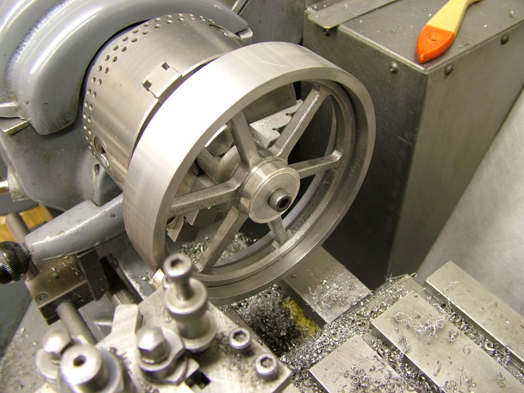

                            Provided the flywheel fits I'm more likely to hold in the 4-jaw with the jaws bearing on the inside edge of the rim to get that running true then turn OD, face rim & hub and bore. Always leaving the boring until last as if something is going to move then it will be while machining the rim which will then throw the bore off.. If it's a good casting then I may even use the 3-jaw

                                      Indeed Ramon as I said I tend to use the chuck mostly but a question was asked about cutting into the faceplate. Also depends on the lathe being used, when I did my 10V on the Unimat 3 it had to go onto the faceplate. The other thing to consider is if it is a variable speed lathe then they are better run faster than a Myford as they suffer on larger diameters with no backgear.
                                      Couple of 10V size flywheels in the chuck for good measure
                                      Regarding the hole, I always try to bore it unless very small eg 6mm or less.. A drill can wander particularly if it hits a hard spot or void in a casting and the reamer will follow the wonky path. I also find I can get a better fit by reaming as I tend to only have 1 reamer for each nominal size so don't want as loose a fit as I would in a bearing.
