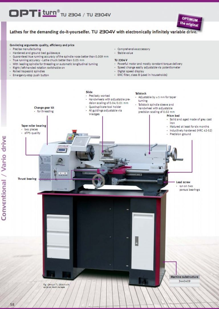

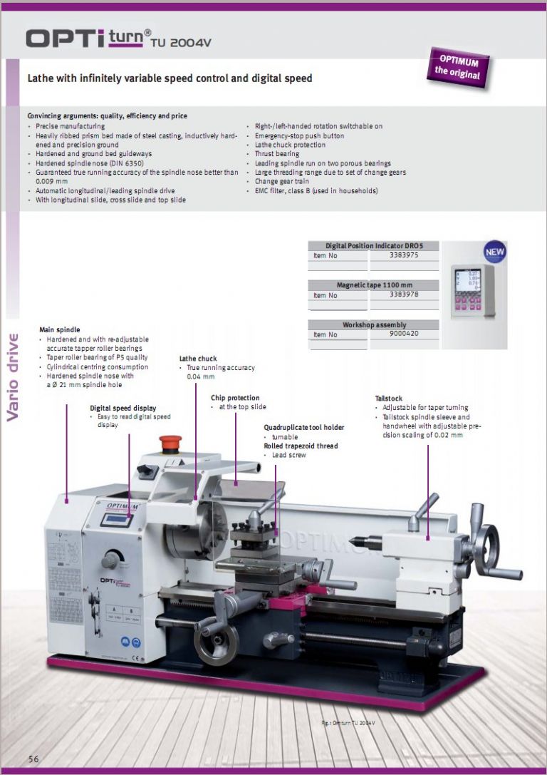

                  Opti put taper rollers in them – following bad press I feel they should get some good press because I suspect all makes are more or less the same especially at the baby end but they vary design wise, Sieg for instance.
                  I just picked the next 2 up from baby. They don't give anywhere near as much detail on the baby,
                  Next one gives the aged bed
                  However if any one wants easily changed feed rates and the 1in spindle bore they need to go for the 2506 or the even bigger 2807. These go down to 30 rpm. No screw cutting indicator though. These seem to be entirely missing from continental lathes who ever makes them which I have always though is a little strange.
                  I'd more than guess the price differences would be far less if all sizes had the same features.
