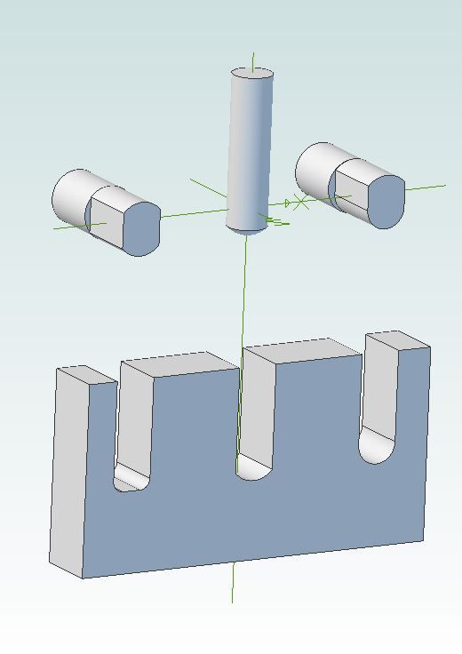

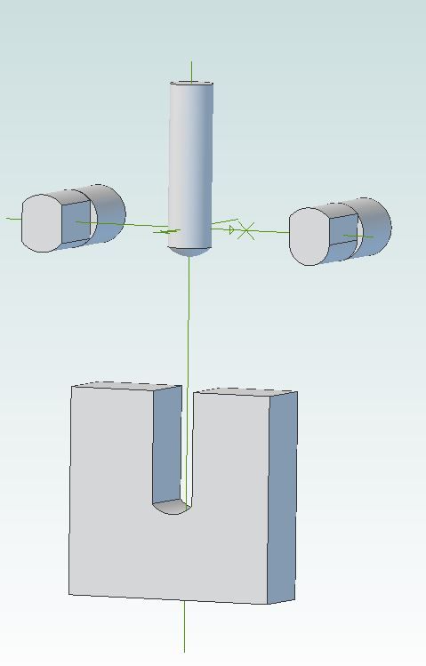

                                    #340737
                                      So on the left is the rod with the flats machined on it.
                                      Piece of 12mm plate with Robin's desired 5r at the End
                                      Middle his suggested tool profile which would do the job
                                      On the Right is an option that would work leaving the 7.5dia end radius (if he can find a 7.5mm cutter) and one edge of the flat filed to match this radius, slightly less resistance to rod twisting.
                                      #340739
                                        Thanks for the illustration, Jason
                                        It clearly demonstrates the wisdom of HOWARDT's comment.
                                        'though presumably there is/was some reason for it to be designed that way.
                                        P.S. … if the proposed slot shape is required, it might be easier to broach the end detail.
                                        [ as already suggested by previous posters ]

                                        #340741
                                          Another option may be to "square off" the bottom of the slot with a LS 3mm dia cutter then the 10mm shaft dia will but up against the flat and no stress raisers in the bottom corners of the slot if that matters.

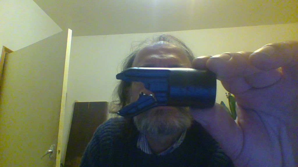

                                            Thanks for replies – and especially to JasonB for taking the time to make a drawing which exactly illustrates what I want to do. As to why I want to do this, which Hopper quite reasonably asks, I think the best answer I can give is that I haven't got an engineering background and learn new stuff by taking on projects beyond my experience then try to figure out a way of doing it. Sometimes that means over-engineering – I think of a solution, realise that I don't know how to implement it, and then it becomes more about 'how would I do this' than getting the job done.
                                            The job in hand is to replace the front wheel mountings on a three wheel buggy – as Hopper suggests it probably isn't worth the candle to get an exact fit, but I'd not thought of the broaching approach so I'll probably give that a go because I've never done it before…

                                                Posted by Hopper on 11/02/2018 02:39:29:
                                                I think instead of over-engineering the radius on the slot I would be looking at over-engineering the choice of material to something stronger, eg steel.
                                                As the one in the photo looks to be plastic Robin looks to have that covere dby making an aluminium replacementsmiley
                                                #340925
                                                  Posted by JasonB on 11/02/2018 07:26:15:
                                                  … the one in the photo looks to be plastic
                                                  That would explain a lot about the slot design:
                                                  It is a simple matter to mould the shape, but machining it brings those 'design for production' issues that HOWARDT mentioned.
