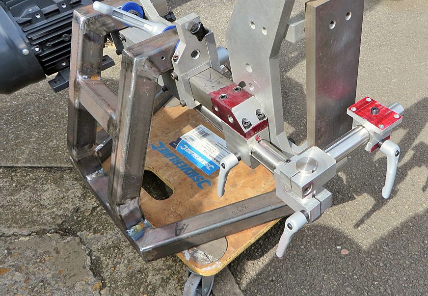

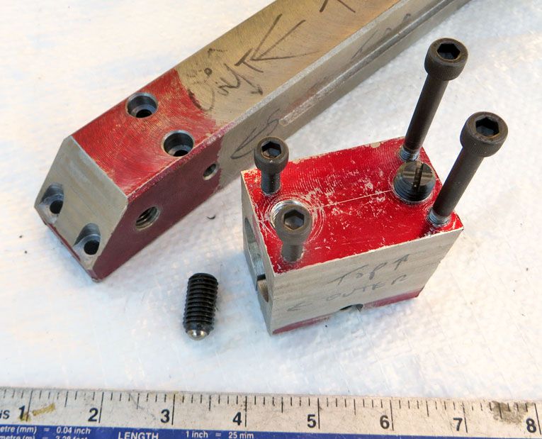

      Hi All,
      This project is still ticking along slowly. Finally got a new motor but have had to go with a 24mm shaft instead of 19mm so the hub will need altering, also the large drive pulley will need taking out a bit to allow room for the key way.
      I am not able to machine this because of size so it will cost a bit to have done. Also I do not think that my S7, (and my skill!) are up to the accuracy need to avoid run out on such a large diameter pulley.
      All now away being done for me.
      I have however made progress on the outboard end parts; machined the parts to take the main 30mm stainless rod that will carry the table:
      This holds the two 12mm spring plungers that will engage in the 30mm table rod to enable indexing at vertical and horizontal table positions.
      Next job it to mill the two circular grooves to take these plungers.
      Hope that folks find this of interest, if not let me know and I will stop!surprise
      Cheers, Martin

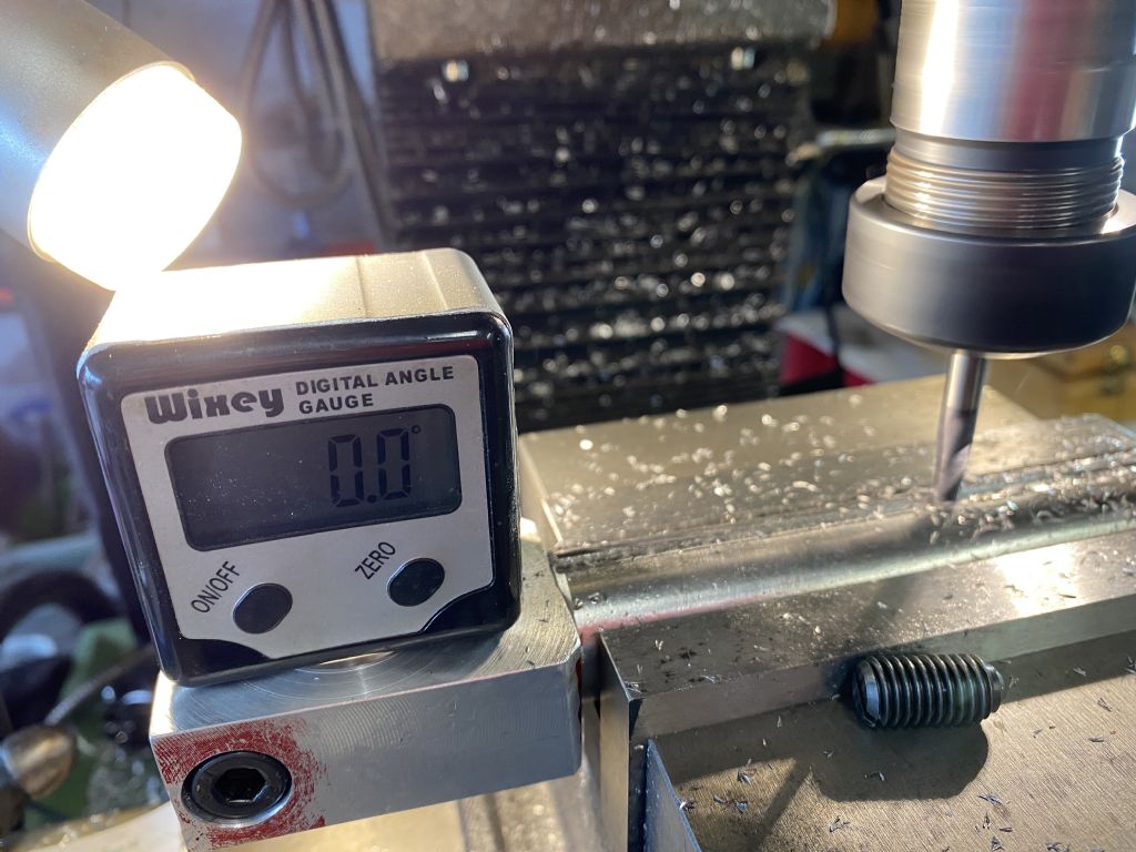

                  Hi All,
                  Clive, the 2000 is belt length (by 75mm)

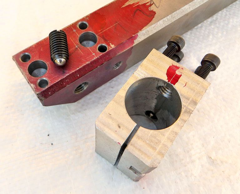

                  here is today’s bit, starting on the indexing of the table support bars that take the 6mm and 8mm spring ball plungers.
                  I spent a lot of time resetting the vice to be dead square and level for this operation as it is crucial to the table geometry.
                  Used a 6mm solid carbide ball nose cutter and played around with speeds and feeds, I get the impression that one must work the cutter hard in stainless (304)?
                  cheers, Martin

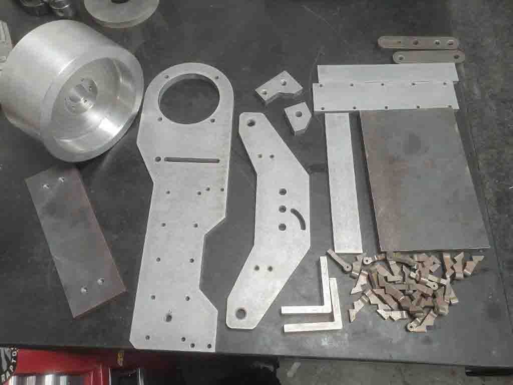

                      Posted by Martin King 2 on 12/06/2021 17:22:08:
                      Hi All,
                      Well here goes!
                      I have a need for a fairly powerful belt linisher and they are very expensive. There are loads of different build threads available on the 'Net and YouTube. I looked through and came across this one by Phil Vandelay in Germany. It seemed a well engineered project that allowed horizontal and vertical use, probably a bit over engineered truth be told.
                      Link to first video here:
                      I'm a bit late ,I watched this series yesterday on YT awesome build
                      After looking at the series of three videos several times and realizing that there was no way that I could cut the very thick 15mm materials with what I have available i decided to get the larger parts water jet cut. The large drive pulley would also be too large for my Myford so I decided to get that machined also.
                      I coughed up the dosh for the plans and was delighted to see how comprehensive they were.
                      I pick up the water jetted parts on Monday morning so will start the project when a few more bits including the motor have been sourced.
                      Here are the parts awaiting pick up:
                      I will try and remember to take photos as I (slowly) progress, quite looking forward to this as it will stretch my skills to the limit!
                      Cheers, Martin

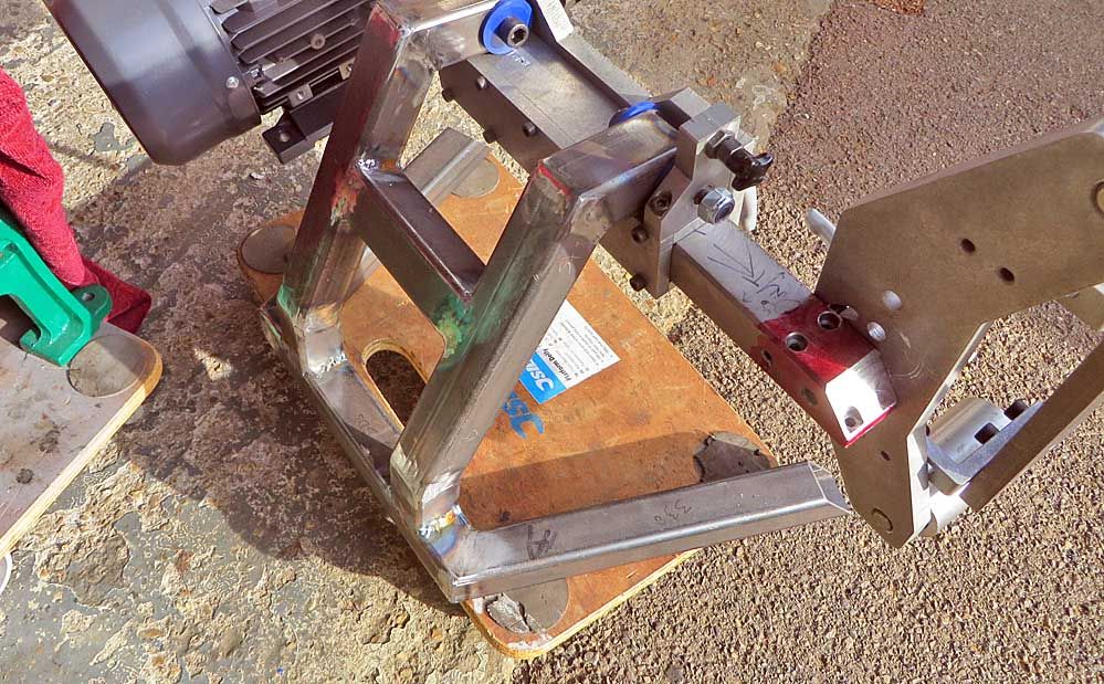

                        Hi All,
                        This project has been on the back burner for a while as we have been very busy with other items.
                        However I finally got around to having a go at TIG welding up the stand frame. This went well for the most part but I had to be careful to do all my tacking at opposite sides of each part to avoid distortion as much as possible.
                        Most of the welds came out OK but one or two burnt through the tubing and accessed non argon shielded air which caused some dirt etc to get in the weld.pool. Also I have not yet tried the foot pedal so sometimes the job gets too hot.
                        The other tricky part of the stand was getting the top and bottom sections dead level; this was achieved by only tacking the back section so that the upright could be levered into position with a digital level, then firmly clamped and the front then tacked. This worked out well.
                        It was also useful to be able to use the main body frame as a means of setting the main fulcrums inline. The machine now operates both vertically and horizontally quite accurately to my surprise! Some balance issues to sort out as the front end gets the parts added when made. This is it so far:
                        I am going to cold blue all the steel items and will probably leave the alloy as is unless there is some kind of blacking product for aluminium? Anodising is way too expensive!
                        Cheers, Martin

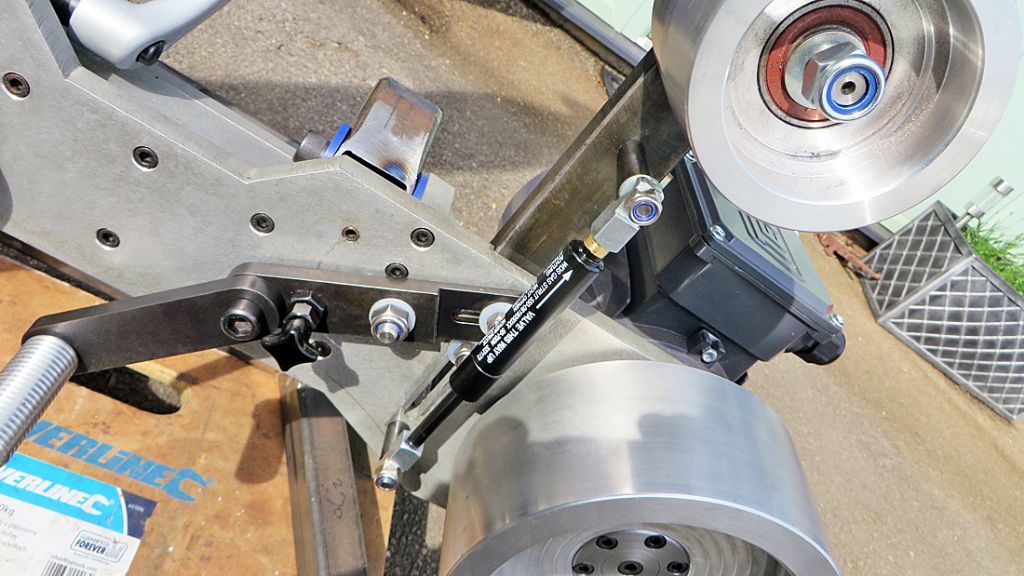

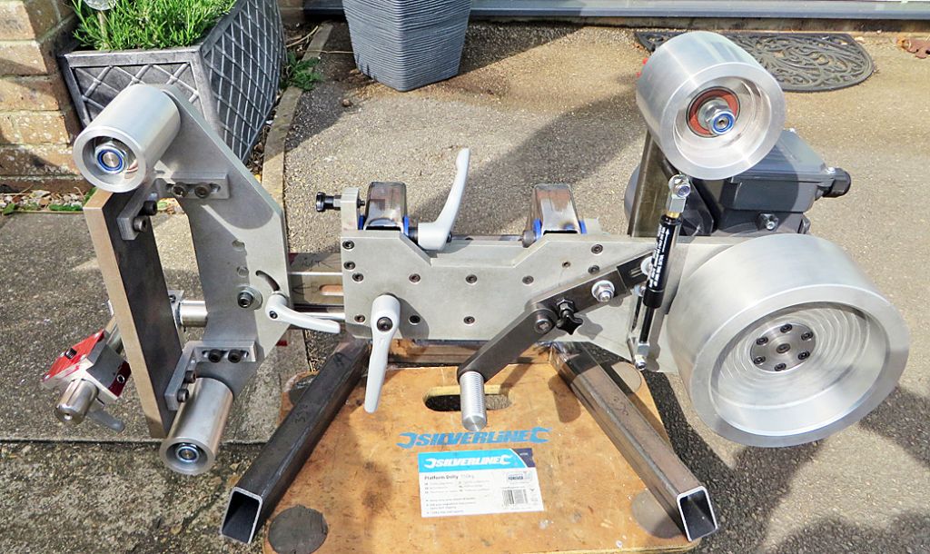

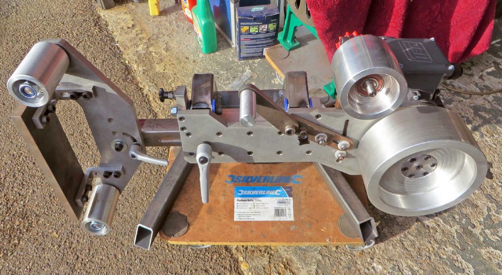

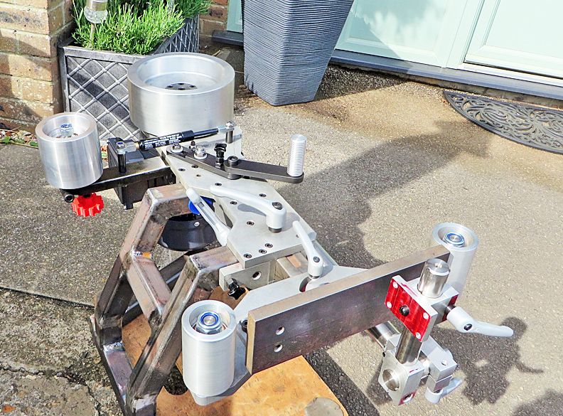

                            Hi All,
                            Still making progress on this project, albeit pretty slowly!
                            Just finished struggling with the fitting of the gas strut which is supplied at nearly 4 times the pressure I need.
                            You have to put it under load then slowly release some gas a bit at a time until it is working as you want it.
                            Holding it is a safe and controllable manner was a bit iffy on my own but eventually I used a small sash clamp and lots of gaffer tape!
                            These are the table rotation controls:
                            Table still to be made, will have a go at the 2 Tee slots wh
                            ich I suspect will give my mill a real workout!
                            Here it is in Horizontal mode:
                            I see that this is apparently not of much interest so will only post more when it is done.
                            Cheers, Martin
