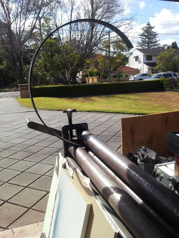

                                              I am absolutely gob smacked as I had originaly thought about buying a ring rolling machine but did not ralise that they were CNC controlled and cost millions of dollars.
                                              As I cannot afford such an expensive machine, I will have to manually bend a piece of 15 x 5mm flat bar into a ring with a press or by banging it around a piece of old pipe with a hammer and weld it together.. Probably use 16 x 8mm flat to allow for a machining tolerance.
                                              Can anyone advise me if this would work ?
                                              Paul.

                                                  Posted by Paul Lousick on 26/08/2020 08:28:14:
                                                  Paul.
                                                  If at first, you don't succeed… use a bigger hammer.

                                                  Nicholas Farr
                                                    @nicholasfarr14254
                                                    Paul.
                                                    Hi Paul, you probably could do it by progressive bending on a press, if you can control each press depth to be the same and unless you used a clevis type pressing tool, you'll have to do it in two halves. 8mm thick may be a bit too much to hammer round on a piece pipe to get a good shape unless you can heat it to red heat. Rolling is always the best way to do it, and once it's welded and the weld flushed down, it can be returned to the rollers and a little over bend pressure applied to get a good circular ring.
                                                    Regards Nick.
                                                    #492743
                                                    Paul Lousick
                                                      @paullousick59116
                                                      Thanks Nick, But is was a tongue in cheek reply to the post made by Hopper on an earlier post. laugh
                                                      Paul.
