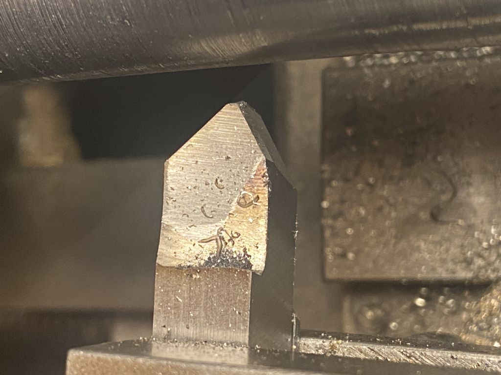

        Hi all
        In the end I got on OK with turning brass and have managed to make a couple of components for my milling machine,
        The next thing I need to make is one of these,
        I’ve had a 316 stainless rod lying around for ages, which I bought for a different project before I got my lathe. I thought it might be suitable. But when I tried to turn it, it basically rubbed out the tip of my HSS bit. So I sharpened it, and it worked for a while, even gave a reasonable finish. Then it happened again, and again…. And every time I grind it, the tip gets lower due to the back rake, now I can’t reach centre with it! I think I’ve ground 3 separate bits so far and the same thing keeps happening.
        Any tips? Chuck away the 316 and get something else? I hear it is tough stuff.
        thanks
        Steve
        Edited By Steve355 on 15/10/2021 10:30:58
        #566897
        Anonymous
          Some stainless steels can be a pain, but 316 is lovely to turn. However, it work hardens at the drop of a hat. So one needs to use decent depth of cut and feed rate (4 thou/rev or more) and never let the tool rub. The tool shown seems an odd shape? i'd use a standard knife tool.

          Tony Pratt 1
            @tonypratt1
            Stainless IS completely different to brass, feeds & speeds need looking at also you need to keep the tool on centre height.

            Steve355
              @steve355
              Thanks Andrew
              I made the tool that shape cos it will need to get into some shoulders.I actually tried several tool shapes.
              What if the tool has *already* rubbed and hardened the steel?

              Brian Wood
                @brianwood45127
                Try carbide tips Steve, not at high speed and keep the feed on, don't allow the tip to dwell as that induces work hardening in the material.
                You should get a decent finish straight from the tool and stringy swarf, which is sharp and bitey!

                Steve355
                  @steve355
                  It’s 1 inch diameter – ish and 300 rpm. Which is apparently 80 SFM.
                  #566905
                  Anonymous
                    Posted by Steve355 on 15/10/2021 10:57:09:
                    That's a bit on the fast side, even the professionals only recommend 70fpm for 316 and HSS tooling. Drop it to 50/60fpm.
                    Andrew

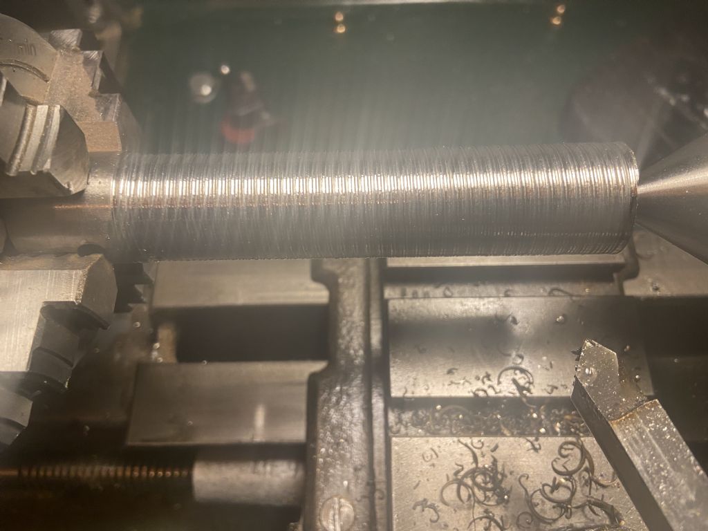

                          So… managed to find a bit more time for this today…..
                          Turns out that in fact I had miscalculated and previously I was turning at 600rpm = 152 fpm so way too fast for 316.
                          I dropped the RPM to 200 = 50 fpm and it is cutting consistently and properly, without wearing down the tool bit in seconds. Problem is ,now I am getting a nice screw thread. See pic.
                          I’ve increased the nose radius, made little difference.
                          I could increase the speed, but then I’d be back to where I was before.
                          if I reduce the feed rate but I’m concerned it would wear down the tool bit again.
                          In fact, my lathe doesn’t seem to have any other speed between 200 and 600. 600 is the slowest main gear speed and 200 is the fastest back gear speed, as far as I can tell.
                          Any thoughts?

                          Emgee
                            @emgee
                            Change your feedrate to something around .004" per rev, looks like your feed is on thread cutting rate.
                            Emgee
                            #567199
                            Steve355
                              @steve355
                              Ahhh I get it. That’s why the change wheel chart has 114.4 and 171.6 TPI. I was wondering why on earth anyone would want to cut a thread that fine!

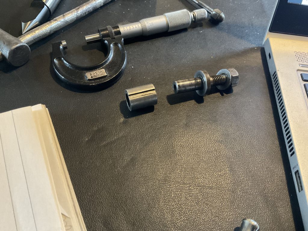

                                Steve355
                                  @steve355
                                  It never ends 🥺
                                  So to do proper power feeding I need to use a full complement of change gears. But the little arbor to attach the second set of change gears to the quadrant is missing. It’s a Zyto lathe but uses Myford change gears – but I can’t obviously find a Myford part that matches.
                                  Luckily it looks pretty easy to make, even for me. I can’t do the slot for the key, it in the short term that probably won’t matter.
                                  Can someone please recommend a suitable type of metal to make it from?

                                  Tony Pratt 1
                                    @tonypratt1
                                    Mild steel will be fine, the key slot may be needed depending on your set up?
                                    Tony

                                      Richard Millington
                                        @richardmillington63972
                                        If you are going to mount two gears on it for one to drive the other then you will need the slot.
                                        You could file the slot for the keyway, or clamp the tube on the cross slide on a small V block and put a small milling cutter in the chuck.

                                          Tim Stevens
                                            @timstevens64731
                                            You need to be a bit careful what you order, Steve. There is a lot of 'construction' steel about which is used for building roofs, etc, and it welds wonderfully but is difficult to machine in hobby workshops. If you order 'bright mild steel, leaded' you will pay a bit more but you'll get what you need.
                                            And leaded means it has metallic lead in the recipe, so it machines nicely. Pronounced leddid, not leedid.

                                            Clive Brown 1
                                              @clivebrown1
                                              The slot isn't essential. All that's needed is a half-height key to connect the 2 change-wheels. Out with the hack-saw and files.
