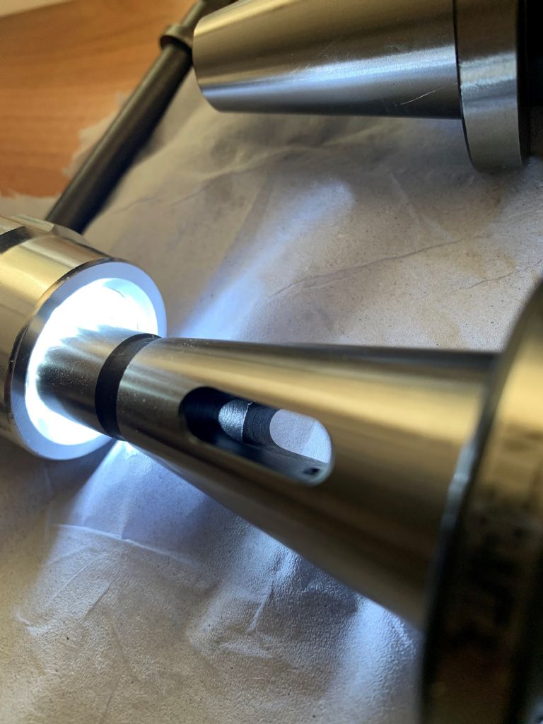

                                                    I decided to visit the warehouse to have a look at the said products.
                                                    Took some pictures which are presented below.
                                                    You were right about the tang type adapator. the hole is indeed around 6mm, so impossible to get 3/8" Whit drawbar through it:
                                                    On opening the box which was supposed to contain ISO/INT30 to MT2 adaptor (drawbar type), I discovered that we had BT30 type instead!.. Left message for Ian and team to check the stock in our warehouse next door on Monday.
                                                    BT30 will fit INT30/ISO30 taper, but INT30/ISO30 will not fit in BT30 taper mills. So in your case, the BT30 adaptor will be fine. However, after checking our stock, Ian or a member of our team will give you a call to see how you wish to proceed.
                                                    Then I put in a MT2 boring head arbour into the BT30- MT2 drawbar type adaptor, and used a 3/8" drawbar to see if it will go through without difficulty… and this was fine.:
                                                    Thank you for raising my curiosity.
                                                    Ketan at ARC
