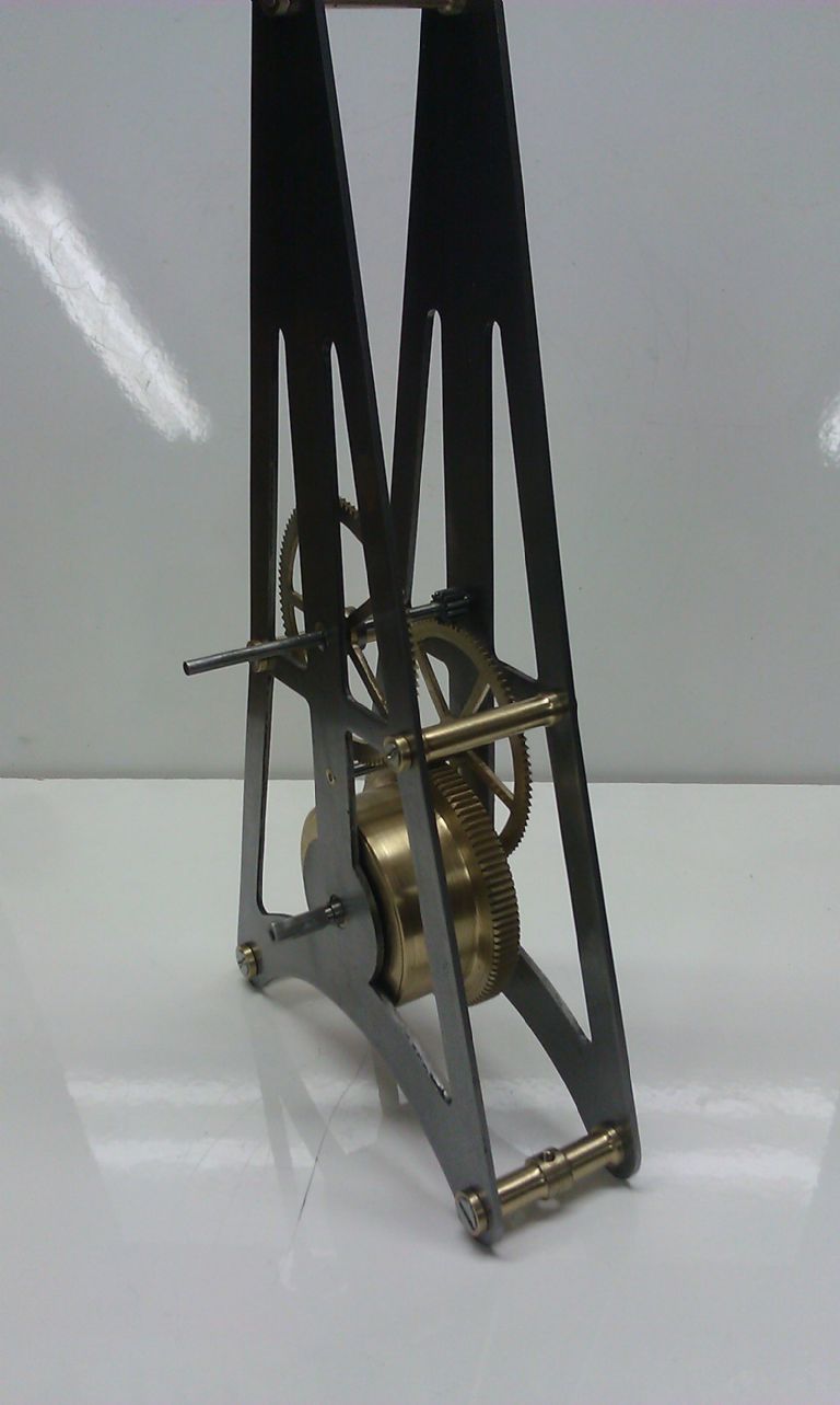

            Mogens Kilde
              @mogenskilde92996
              Hello Folks
              As Mr. Eberhardt has started this topic, I simply have to show my progress on making the very same clock.
              Previous you all have been kind to give me some feedback on the tool making for the project.
              In the building proces I have made metric design of all parts, as you might see the next step is the ThirdWheel section.
              So far the project has been very interresting, so I would like to thank Mr. Parslow for his design of this clock.
              Mogens

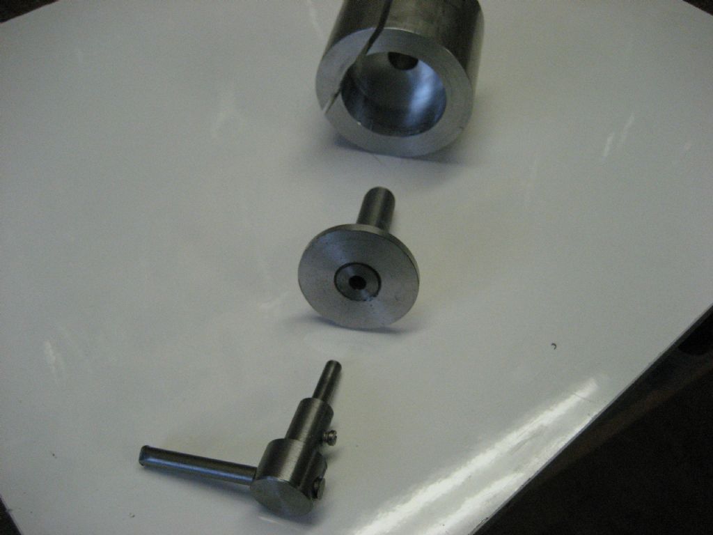

                                                    #107338
                                                    Mogens Kilde
                                                      @mogenskilde92996
                                                      Hello folks
                                                      Just wanted to show my tool for winding the main spring
                                                      Hope the photos tell the function, otherwise you just ask, I'll be happy to answer
                                                      Regards and a hope for a happy new year to all of you
                                                      Mogens
