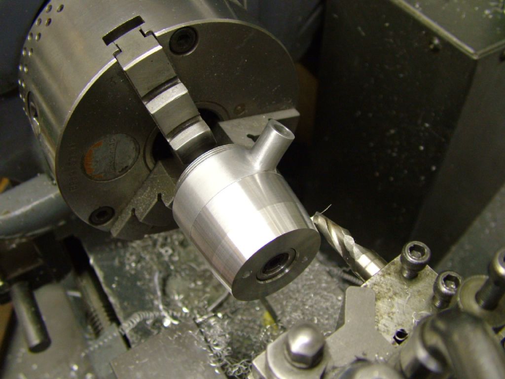

                                        A small boring bar can be made from a worn slot drill – I have an image somewhere so will try to find it for you.
                                        Tug
                                            The flutes on a slot drill are ground back to leave just one tip and that is then used as a short boring tool.
                                            (The reason this is cutting backwards is that the part being turned is screwed onto the rear part with the inlet tube)
                                            Old slot drills and three flute end mills make ideal 'home made' cutters if you are up for using an off hand grinder
                                            Hope that helps – Tug

                                              Posted by Ramon Wilson on 18/07/2023 16:43:29:
                                              How is the one in your picture held in the toolpost, Ramon? In a square profile holder with a slit?

                                                    Bill, It's held in a Myford QC holder for boring tools – the type that has a vee groove machined in the lower face.
                                                    Margaret – Good luck with your taskyes If you can learn how to use an off hand grinder to shape HSS then you will have a huge 'extra' to call on in future. Just bear in mind you won't necessarily get it right at first but keep trying and you will. Also bear in mind it's only the very tip of the tool doing the cutting that has to be right – what's to the side and behind it is just support
