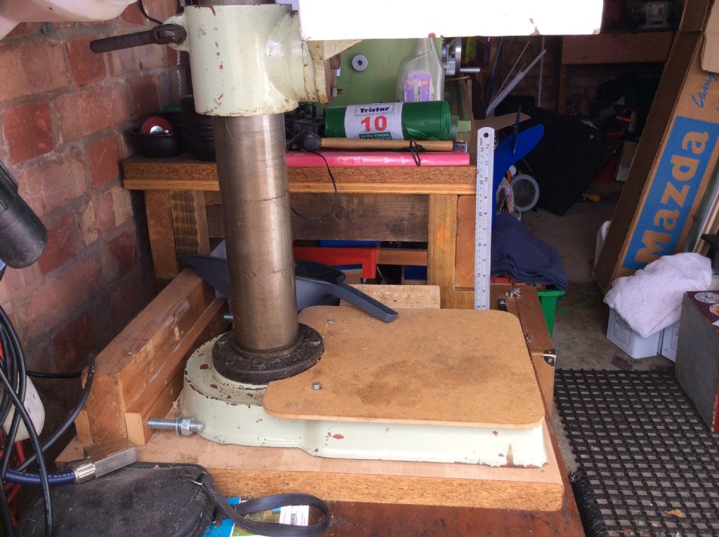

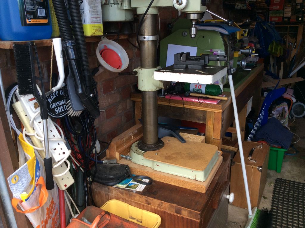

                                img_0347.jpgThought a couple of pictures would help show what I have. Brings working height of the drill table roughly same as lathe cross slide. It's 11 inches lower than the lathe bench and suits me!mimg_0345.jpg
