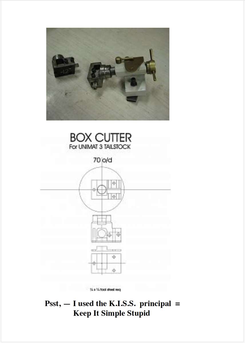

            Box tool, box cutter, running down tool are, I see, different names for the same thing. The OP’s lathe picture unfortunately does not show the business face of his cutter but presumably the rectangular plate has an orifice that shaves down the barstock.
            Its not clear from the OP’s setup whether the lathe motor is reversible and/or whether the bar diameter reduction and thread cutting are done under power (or how bolt length is controlled) but since cutting forces must be very low, anything that could speed up making parts in 100’s is worth considering.
            For the diameter reduction why not have a hole near a corner of the plate (without its box) for a pin in a ‘clevis’ mounted on the cross slide/carriage so that the plate can be swung in and out of position. I know feed would then be by the leadscrew but if, rather than the plate being trapped in a close fitting clevis, it was free to move (say 6mm) in the Z direction it could probably be fed by finger pressure up to a stop.
            Once retracted and swung out of the way a tailstock mounted die can be employed. For 12BA I would be looking to mount the die in a homemade knurled holder floating on a shaft in the tailstock that keeps it in alignment.

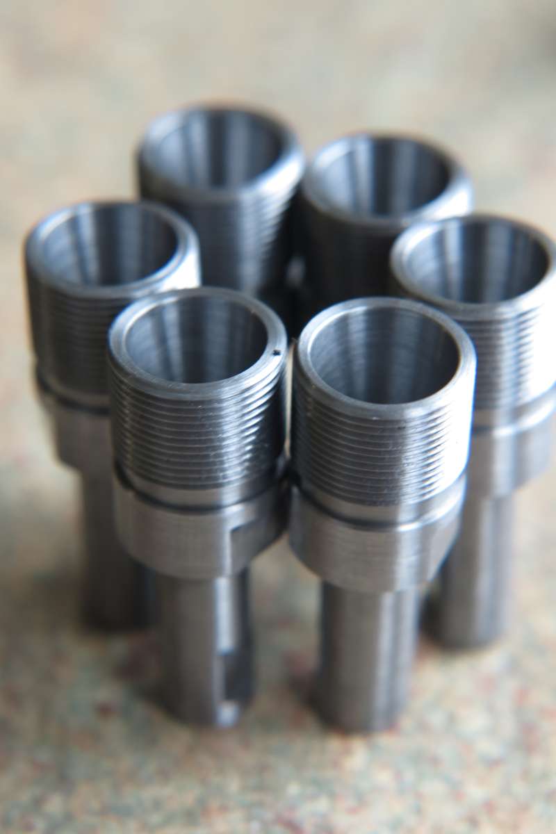

                Howard says it all thats how I made the one in the above photo took less than 3 mins.

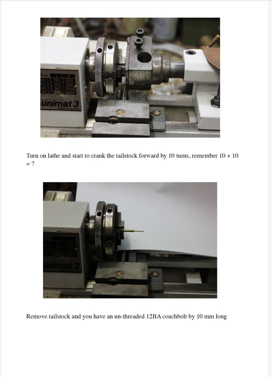

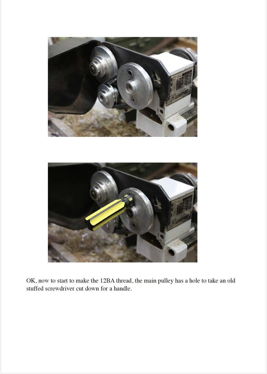

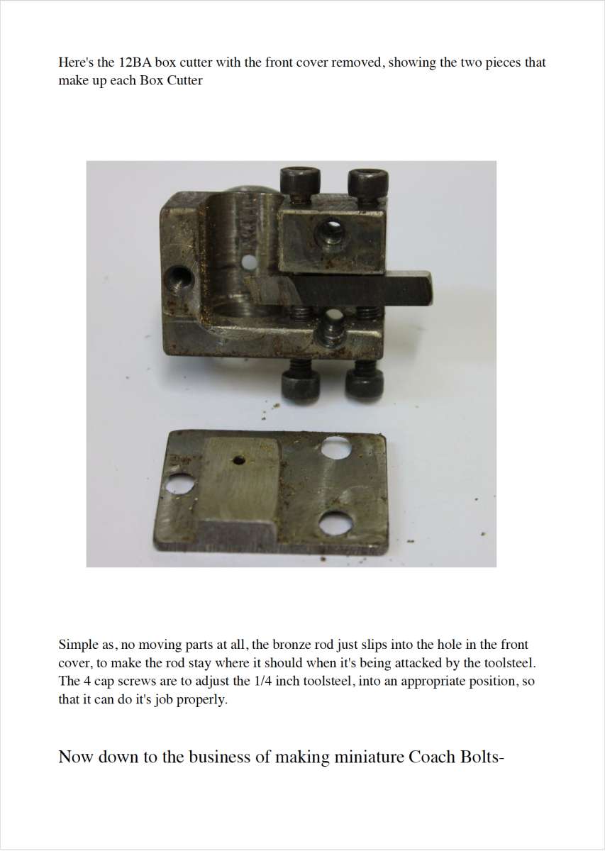

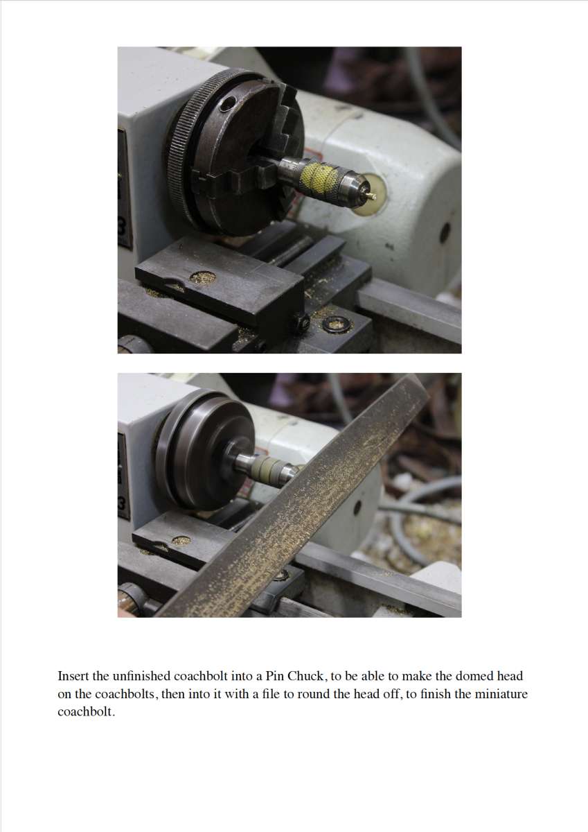

                  Graham Green 3
                    @grahamgreen3

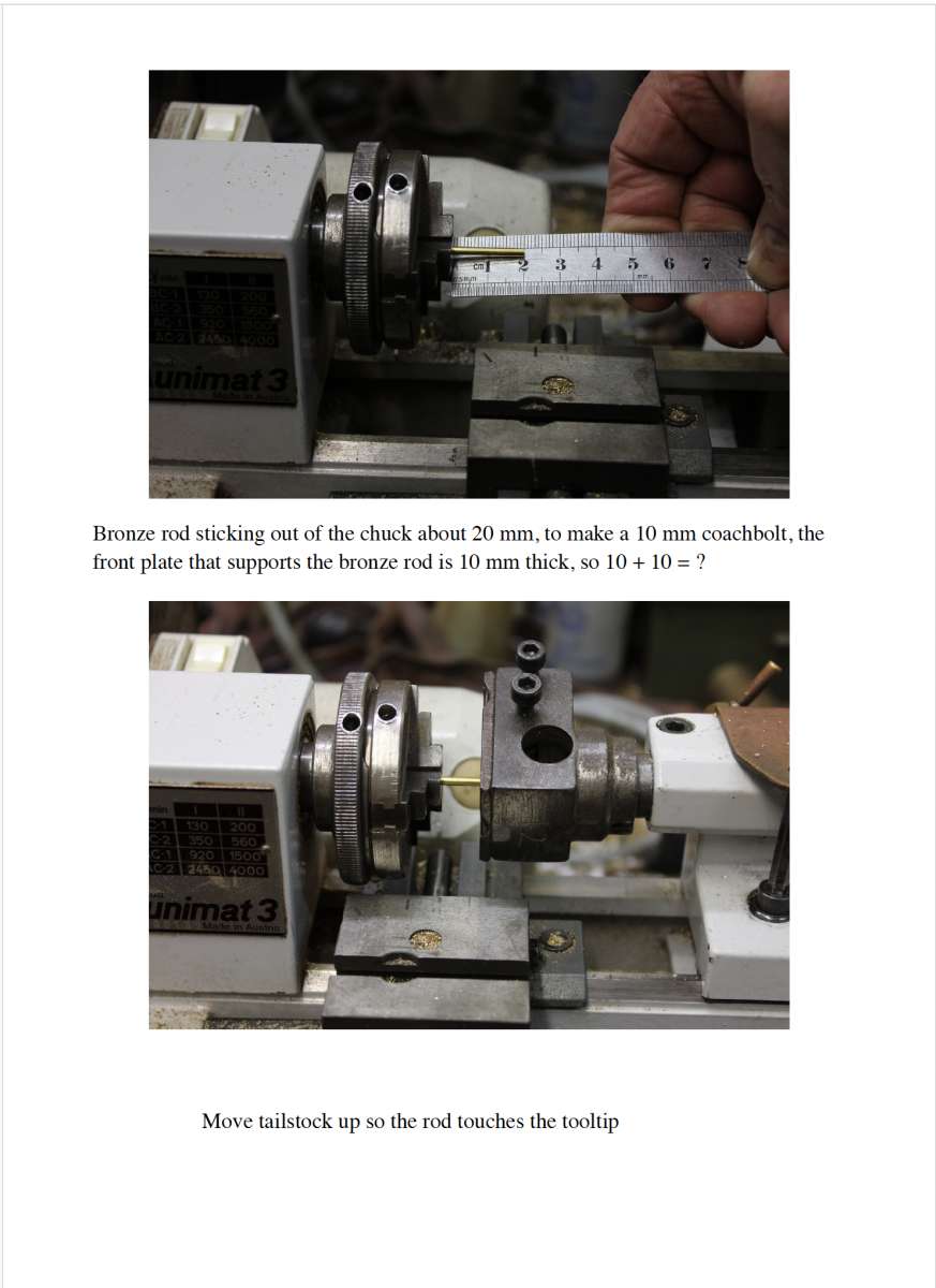

                    What most persons on here DO NOT SEEM TO understand is that the Box Tool is screwed onto the tailstock and would have to be removed,  for the Tailstock die holder to be then , either threaded onto, or pushed into the hollow of the tailstock. VERY TIME CONSUMING DOING THOSE OPERATIONS. The way i have been doing it is quite time EFFICIENT with the CORRECT 12 BA DIE.  That is why I am after that particular sized 12 BA die.

                    Graham Green 3
                      @grahamgreen3
                      On Ian P Said:
                      So that would be five hours to make 100
                      Graham (OP) mentioned quantities of hundreds, methinks some job specific tooling is called for.
                      So far this thread has only discussed the threaded portion of the coachbolt, goodness knows how the squared section under the head is done-:) but I could see doing the domed top with a combined parting and form tool.
                      Ian P

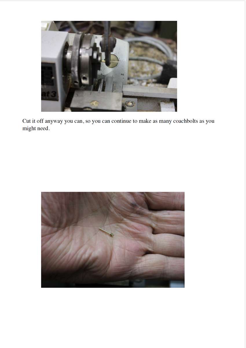

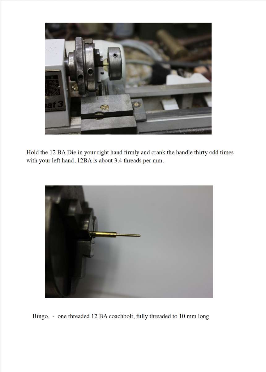

                      Is there any way of ADDING a PDF to a post on this forum AT ALL ? If I could add a PDF,  then it shows what I actually do to make 12 BA screws and why the HAND HELD die is what’s required for the amount of screws I need to make.
                      #755866
                        Graham, if you go to your profile – gallery – create a gallert and set type to document then you can put a pdf into that.
                        As I suggested earlier an adaptation of the end of teh box tool to allow a dieholder to be slipped into place would save unscrewing it.  Having seen the tool since you have a lot of box to play with so it could fit to the end or swing into place a bit like my tailstock tool. At the most you would just have to slide teh tailstock back and lock it which is a lot faster than completely removing it from the nose thread.
                        When you say handheld die do you just offer it (and diestock?) upto the work? Simply applying pressure with the front end of your box tool would go a long way to reducing wobble as the die will be held against a flat surface so unable to wobble.
                        And my other tooling suggestions included an option for doming the head so it has also been mentioned.
                        If they are anything like the coach bolts that I make for models then the square under the head is not really needed, they seem to pull up tight enough without turning.

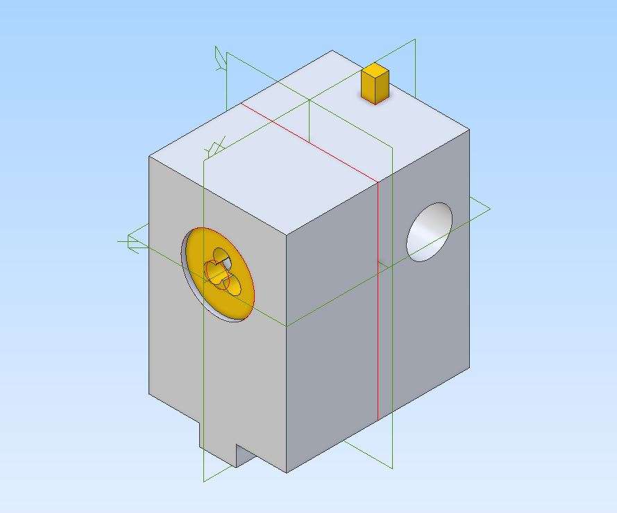

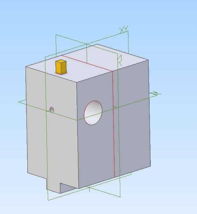

                                I drew this before seeing your PDF. It still applies but can be even simpler. Prompted by mention elsewhere of pultra and their capstan units came to mind
                                Take a block of metal, machine two rebates along the bottom edge to form a spigot that is a close fit in the slot of the cross slide. Or simply screw a strip to the bottom if that is easier
                                Bore or drill a 6mm or so hole right through, counterbore to take a die 5/8″ diameter would do, add grub screw holes if needed to adjust die.
                                To use simply slide the tailstock with the box still attached to the right. Place your die holder into the slot and simply offer up to the rotating work. Cross slide will just need to be set to correct position for the first one.

                                I had included a simplified box tool on the other side of the block but may not be needed if you keep the existing one but would save having to keep moving the tailstock. Load is light and it would cut just by hand pressure to a preset stop.

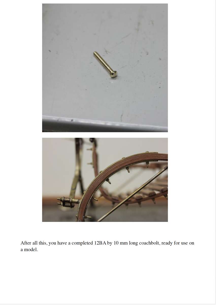

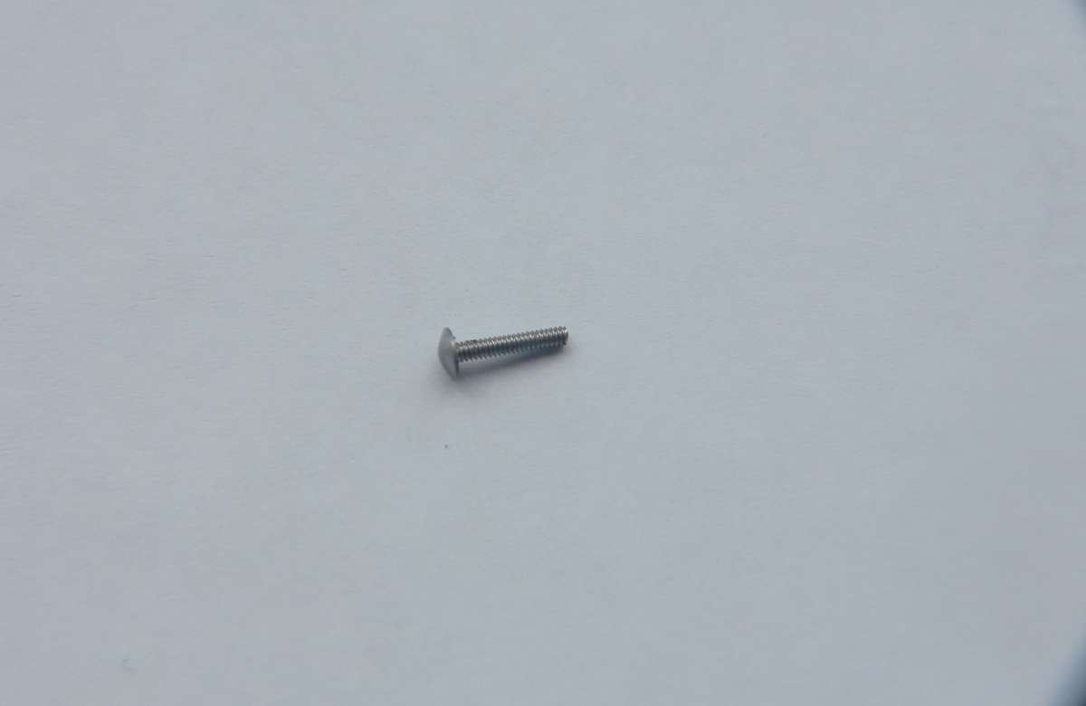

                                      Proof of pudding or concept as the engineering types here may call it.
                                      Well used jig piece that was milled to a sliding fit in the U3’s topslide approx 8mm wide. I then held a spotting drill in the U3 chuck and slid the block onto it which marked the position. It could be clamped to the topslid eand actually drilled and counter bored in situ but I moved to my mill. Located spot mark, drilled 4mm hole and then use d a couple of end mills to plunge 6mm deep x 5/8 to suit the die. Luckily the hole split a tapped My hole so I put a grub screw in there to stop the die turning. Die is 1/4″ nominal thickness and about half the back is hollowed out so approx 1/8″ length of tooth. 20 mins work (bit longer if all done on the U3)
                                      Turned a bit of 1/8″ brass to 1.25mm and gave it a go just turning the pully by hand. Light downwards pressure and gentle towards the work and off it goes. Also did a longer one. No facing or chamfering of the bar, just the sawn end but at that size a quick lick with a file will do.

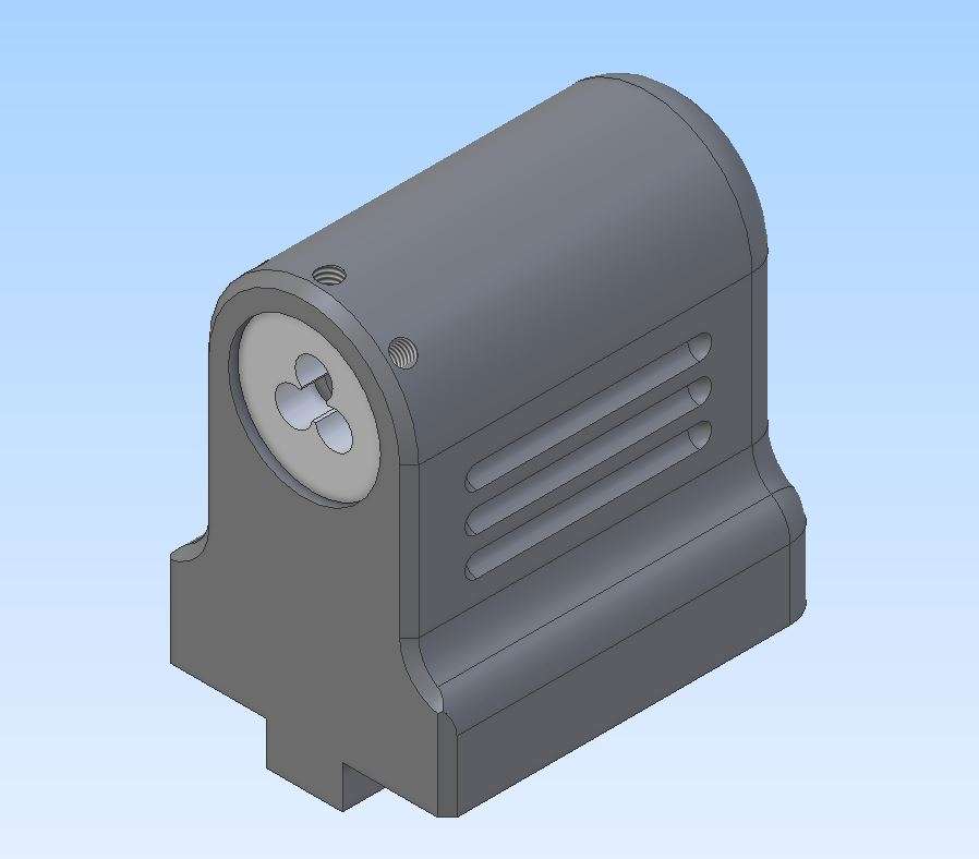

                                            #755962
                                              Having proven the concept I’ve tarted up the 3D model.
                                              final block
                                              A bit more finger friendly and the flair at the bottom gives something to push down against which will help if you have oily fingers as will the grooves in the side.
                                              Further options would be to make the key at the bottom from a separate piece held with two CSK screws. You could then remove it and if a couple of extra tapped holes were added to the top then a piece of round HSS could be held in the body enabling it to be used a bit like the Eccentric Turnado for free hand work.
                                              As for repositioning the cross slide use could be made of the through hole if a piece of suitable bar were held in the chuck then just mve the slide in and out until the block slides over the bar. Or to save removing the die for each session make a spacer block that can drop in between the front of the slide where the carriage where the cross slide screw goes and the actual moving part of the cross slide.

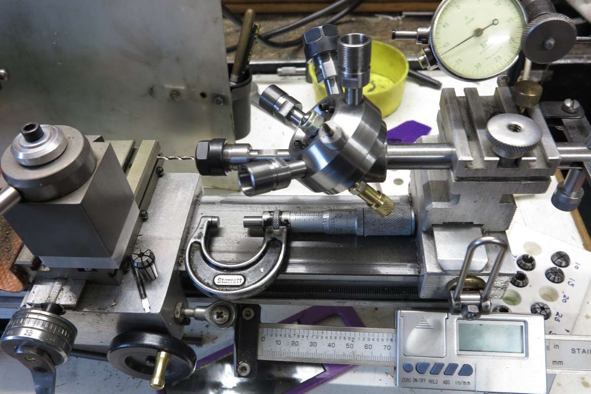

                                                Ian P sorry for the delay in answering but the tailstock turret is to my own design and most of the rest of the bits and pieces. The turret uses homemade ER16 collet chucks.IMG_5946
