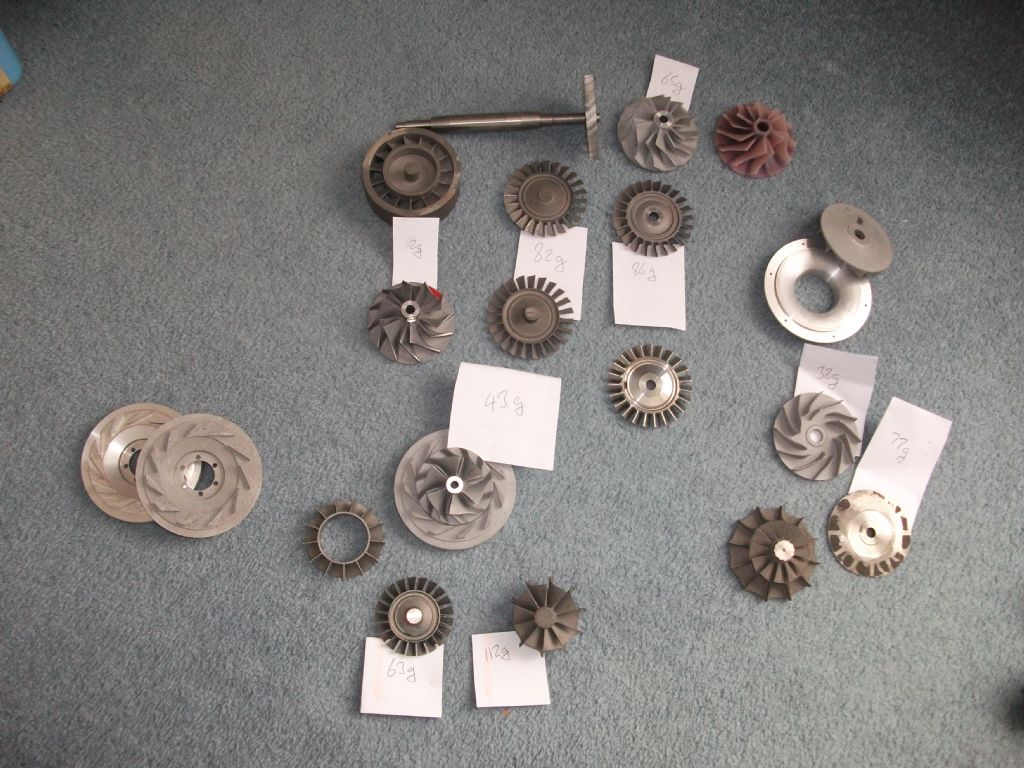

    I used to be a member of the GTBA but let it lapse when they went on line only
    as back then i had no internet connection , i still have one of the original GTBA
    commissioned turbine wheels seen here in the photo along with a Wren
    MW 54 wheel also there is a 66 mm wheel and stainless cast NGV
    also from Wren. Since they disappeared these parts i guess have gone.
    Some of these parts are seen here ,on the left Some Wren mw 54 parts
    a bought turbine wheel , milled NGV centre from 316 ss , compressor wheel a
    free-be from a collection of them, 3 off part machined diffusors.
    Towards the centre top some milled 718 turbine wheels and the GTBA and
    Wren wheels ,on the right some FD 3/64 parts , in the lower half a nearly
    reclaimed disc of inconel most probably 713 from a scrap radial
    inflow wheel.
    I seem to remember that before the availability of cast turbine wheels
    inconel slices about 6 mm wide were around the £35 mark ,that was over
    20 years ago , by buying a length of inconel bar brought that price down to about
    £8 to £10 ,of course you still have to slice it up by whatever means and the mill
    the blades.
    That is why that i said it would be a better option to buy a ready made wheel
    as the real cost is only the difference from buying the material and the tooling
    and the time minus the cost from the ready made item.
    With that in mind the home made compressor wheel milled from the solid
    seen here and in previous photo's is a similar situation the aluminium blank
    probably about £5 or £6 plus all the work to get to finished job when you can buy
    a new cast wheel for £14 + vat and free shipping does not make it really
    worth while.Although i have to say that you do learn a lot in doing something like this
    also as i wanted a reverse rotation wheel it is a simple matter to change
    some of the axis polarities to be able to do this ,in the photo here is a wax
    test cut reverse rotation wheel alongside the aluminium one.

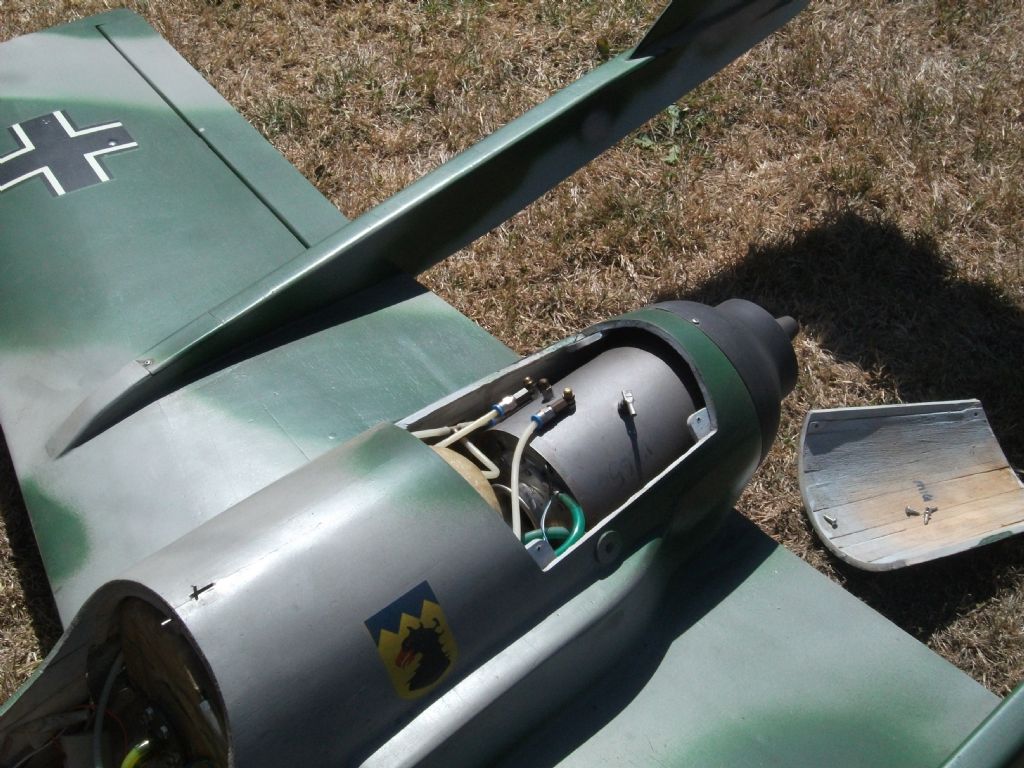

    The last photo here shows the much modified Shreckling FD 3/64 engine
    installed in an airframe ,you can just see parts of the fuel tank in front of the
    engine ,its bigger than the engine,the model has never been flown.
    Most of the parts seen here were made 10 to 15 years ago.
