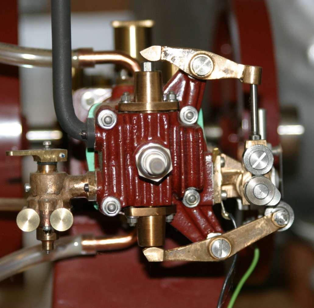

        I don’t think there is anything particularly difficult about the Wyvern.  3 points you might like to consider come to mind:
        Wyvern was designed to made in cast iron but the Hemingway castings, apart from the fly wheels, are aluminium.  The design for the exhaust valve seats directly in the casting which most builders seem to think isn’t a good idea in aluminium so use an insert similar to the inlet valve.
        You might want to consider using an O ring rather than cast iron piston rings for better compression.
        Cheap and readily available ball bearings can be used for the cam followers.

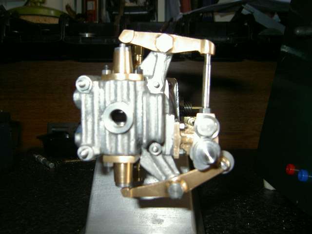

            MichaelR
              @michaelr
              Rod mentioned in his post about the valve seats for the Wyvern, I modified the cylinder head valve arrangement by using valve pockets and making the exhaust valve the same as the inlet valve.
              Hope the pictures help.
              Valve PocketsValve Gear 2

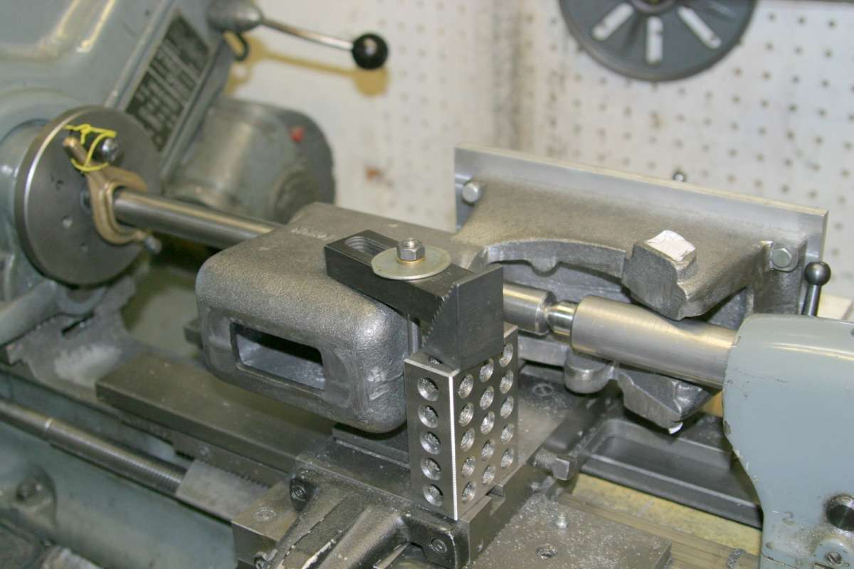

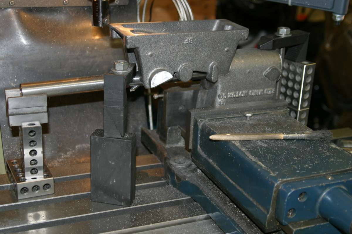

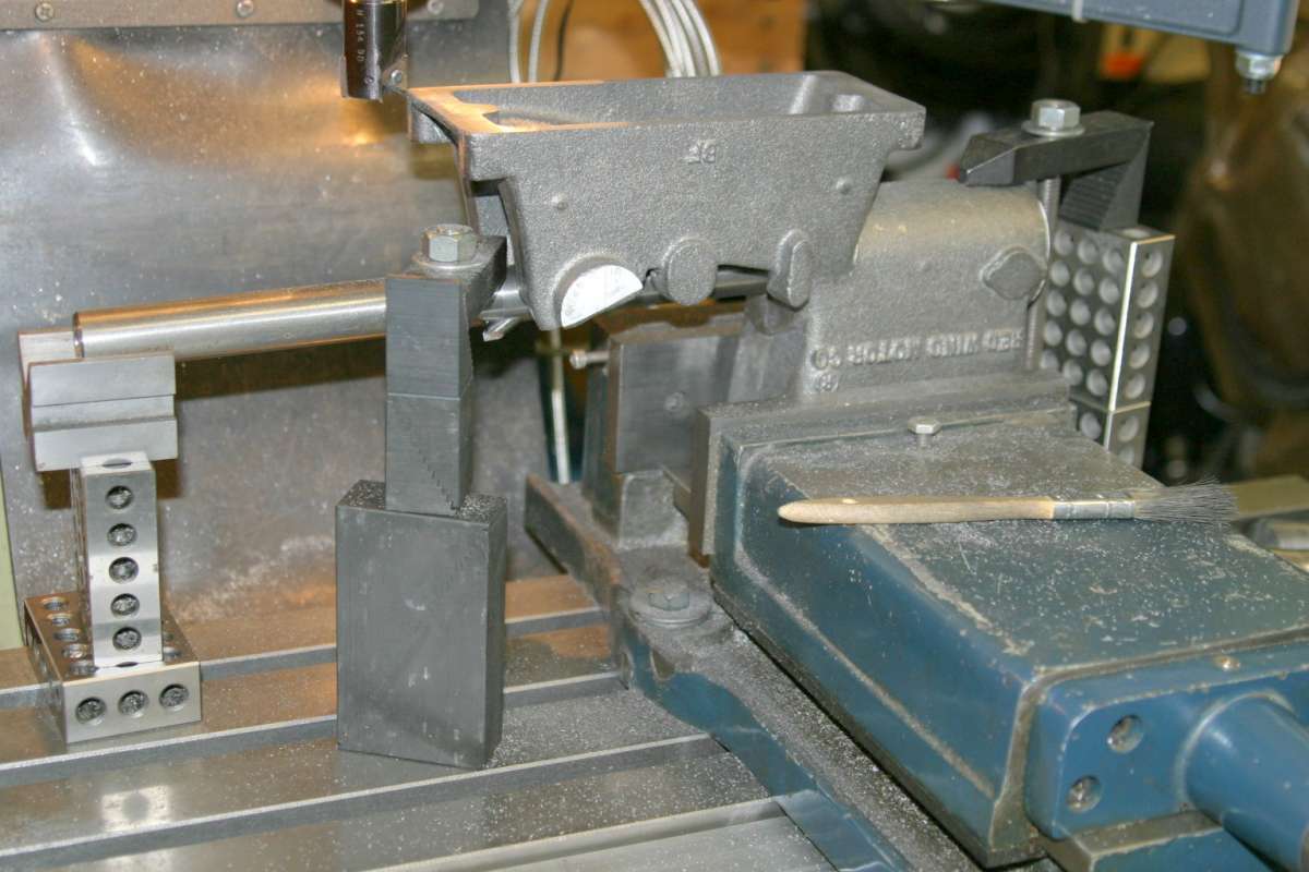

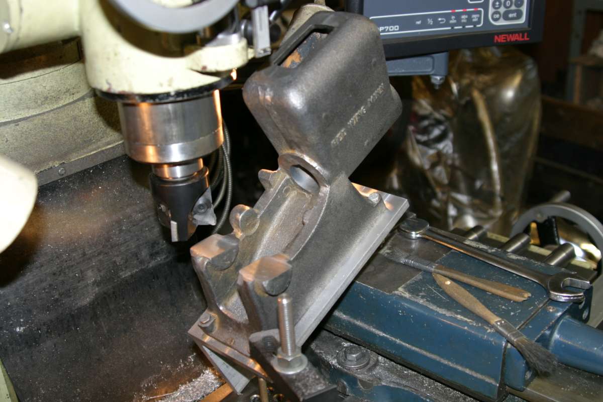

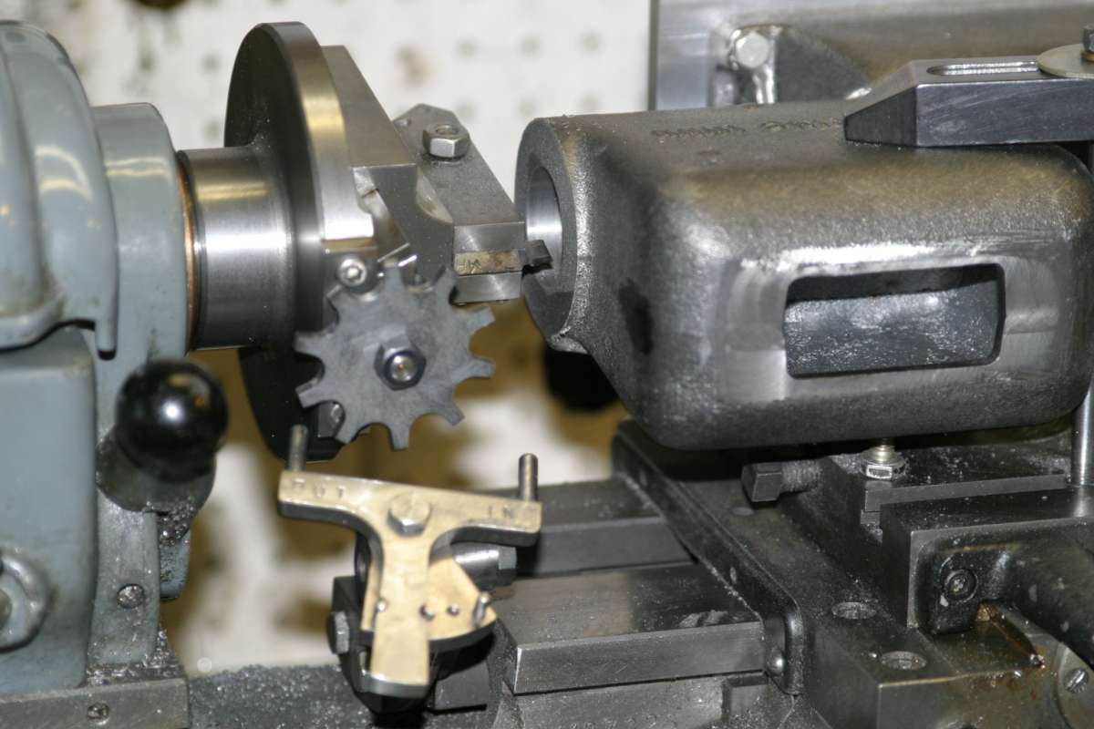

                    John Purdy
                      @johnpurdy78347
                      I have built both the Wyvern and the Red Wing and would say they are both of about the same degree of complexity as far as machining goes.
                      On the Wyvern I also used the separate exhaust valve guide which required a sightly modified flange and mounting at 45 degrees to the cylinder axis to allow for the mounting studs.
                      The one potential problem with the Red Wing is that the cylinder/hopper/engine bed is all one large iron casting and requires some careful thought and ingenuity in setting up for machining, depending on the facilities you have available.
                      Exhaust Guide
                      Boring
                      Facing
                      Bearing Seats
                      IMG_6212
                      #799352

                        #799406
                        John Purdy
                          @johnpurdy78347
                          Dave, would be glad to help any way I can, just PM me here.
                          I just noticed that the last image in my previous post didn’t show, got replaced by the text “IMG_6212”.
                          So here it is.
                          Bottom
