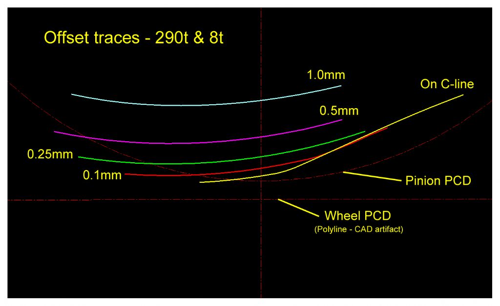

        Nevertheless, I have been enticed by my own curiosity into the inner sanctum of cycloidal gear teeth and how they mesh or don’t.
        According to BS 978:Part 2, found via the good services of Meadows & Passmore **LINK**
        Thornton **LINK**
        (and others.), cycloidal wheel and pinion teeth look like this …

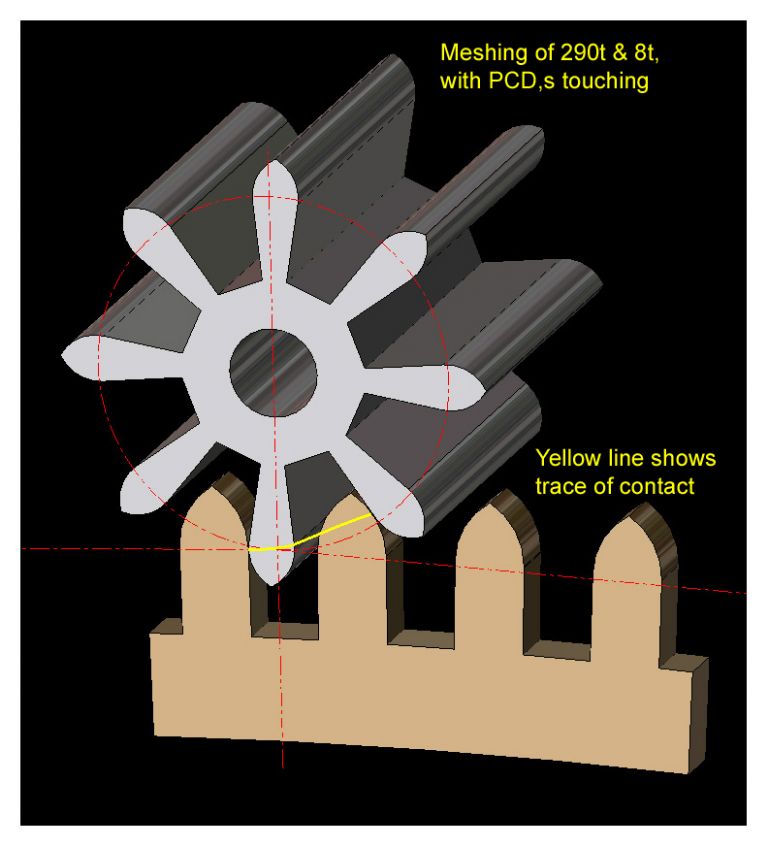

        The trace line in yellow (via my CAD package) required that I rotated the 8 leaf pinion through fifteen x3° steps, and follow the pinion leaf (tooth) with a wheel tooth.
        Using the same laborious process, I chose to decrease the depth of mesh from the ‘PCD coincidence’ by 0.1mm; 0.25mm; 0.5mm; and 1.0mm.
        If this interests anyone, I’m prepared to add more results, including the Excel graphs of the corresponding pressure angles. The latter revealed some odd and (to me at least) somethings rather unexpected.
        Sam smile d

          Sam, please don't keep us in suspense! What direction was the pinion rotating?

                      The big brass thingy (large wheel) pushes the little steel thingy (pinion) to the right.
                      As can be seen here, and when I get around to it, you'll see how the points of contact trace unexpected(?) paths.

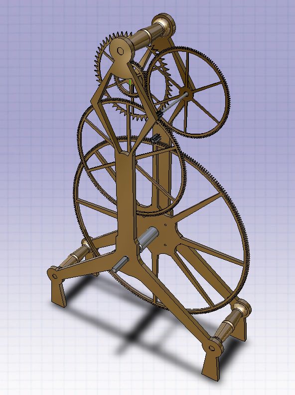

                                More explanation is required with regards to the direction I was taking. For a start, I'm no expert in gearing or clocks. It just so happened from an earlier post and my choice to respond, that I began pondering how the teeth of John Wilding's large wheel skeleton clock would actually mesh at different depths. Like Topsy, 'It just growed'.
                                Before grasping the significance, I had generated the wheels and pinions for the clock. In particular, the large wheel with 290 teeth, and its corresponding pinion with 8 teeth (leaves). Similarly, the 198 tooth wheel, and the 7 tooth pinion joined the gathering collection.
                                Here is my rendering of the gear train in position …
                                I’m still preparing additional diagrams, so watch this space.

                                  Continuing with meshing about with cycloidal(?) teeth, here are two more images and their respective contact traces.
                                  Shown close up, they indicate how the teeth mesh while reducing the depth.
                                  My guess is that at the 1.0mm offset, the teeth are likely to jam or at least wear quickly.
                                  In this next image, I have superimposed all five traces for comparison.
                                  The relatively straight-line section of the ‘On C-line’ trace occurs where the flanks (sides) of the teeth and leaves make contact with the opposing tooth radii.
                                  At this level of magnification, the CAD package presents large arcs as polylines. It was rather confusing at first while trying to determine why the PCD’s failed to coincide. They are touching in the original working file.
                                  Some of the data I gathered makes it quite clear that the velocity ratio (thanks John) varies thus giving rise to varying torque.
                                  This may seem insignificant, but at the slow speeds of the large and centre wheels, the torque variation could have a noticeable effect on sensitive escapements, e.g. John Stevens’ English lever mechanism. I suspect that this will not be so noticeable with Mr Wilding’s large wheeler.

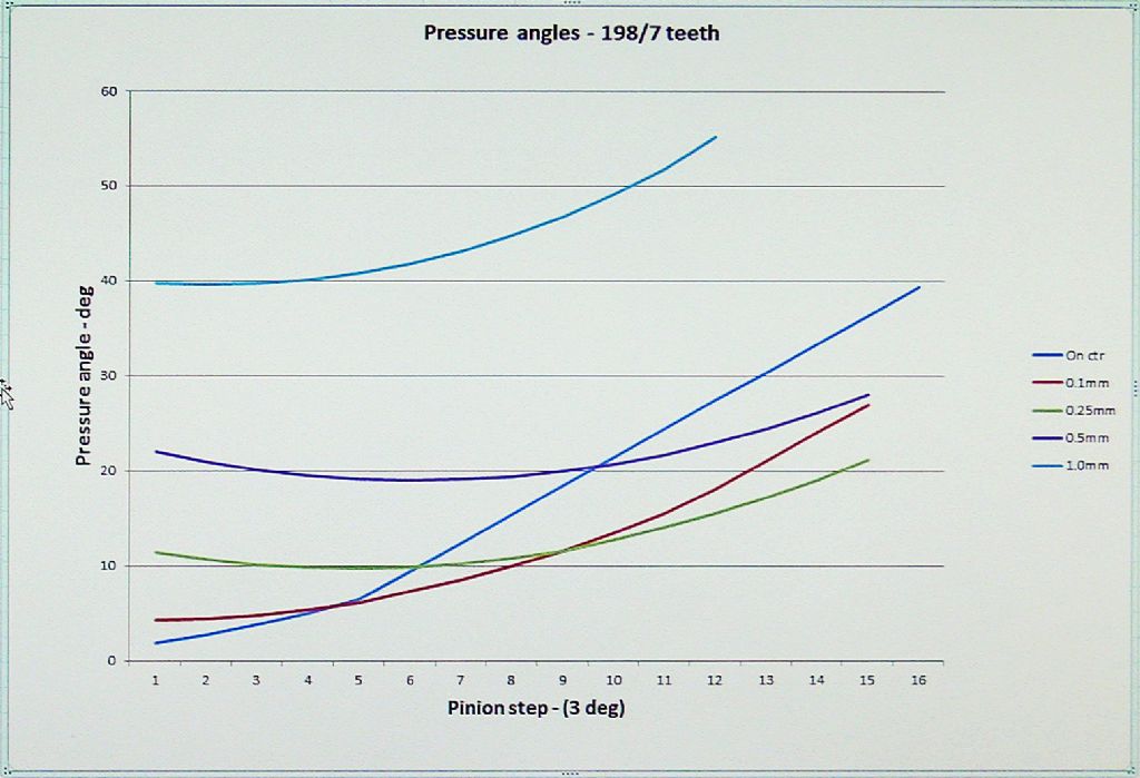

                                      Having, over the past few weeks completed the (depthing) exercise including the other pair of (198/7) wheel/pinion ‘gears’, I still feel the urge to offer it here. It just needs to be in a presentable form.
                                      What I wasn’t expecting was this rather odd set of pressure-angle curves.
                                      It was surprising to see straight lines and a comparatively sudden change of direction, not to mention the cross-overs. So, I laboriously repeated the complete exercise with greater accuracy. This time, any errors I had made were likely to be ‘accurate’ to several decimal places.
                                      Sure enough, the (sudden?) shift from a smooth curve to a straight line matched where the point of contact changed from the pinion radius contacting the wheel flank to wheel radius contacting the pinion flank.
                                      Sam smile d

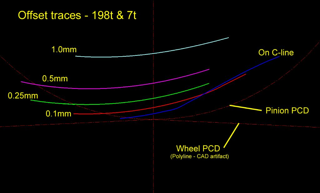

                                            This is the next pair of gears in the large wheel skeleton clock designed by John Wilding.
                                            They comprise a 198-tooth wheel, and a 7-tooth (leaf) pinion. Again I constructed their profile according to BS 978:Part 2 supported by notes from other places, e.g.
                                            Meadows & Passmore … http://www.m-p.co.uk/muk/acrobat/tech/cutters.pdf
                                            and Thornton’s … https://watchmaking.weebly.com/uploads/1/1/7/9/1179986/pp_thornton_information.pdf

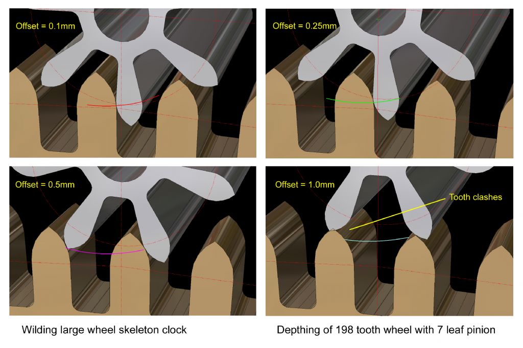

                                            As before, a result of a previous forum post, I investigated the interaction between corresponding teeth at varying depths. Choosing to rotate the pinion one whole tooth (about 51° in steps of 3° ‘pushed’ along by a wheel tooth, I traced the respective points of contact. With one less pinion tooth (i.e. 7 versus the previous 8), 17 steps of the pinion were required for a full trace.
                                            The depth of meshing from where the two PCD’s made contact was scanned at decreasing depths. They were … the ‘correct’ (on Centre-line as designed) condition followed by 0.1mm, 0.25mm, 0.5mm, and 1.0mm; i.e. five conditions in total.
                                            198t-&-7t---meshing---offset-0.1mm---1.0mm---01a.jpgAt the worst condition (shallow by 1.0mm) the entering pinion tooth can be seen to clash while the exiting tooth is still engaged. Clearly, although the trace is incomplete, this condition is irrelevant.
                                            To continue with this thread, here are the five traces similar to those for the 290/8 wheel/pinion combination. To avoid an unwieldy post, I aim to add the final image(s) shortly.
                                            Sam smile d

                                              To bring this thread to a close, here is the last graphic …
                                              Once again, the appearance of straight lines and cross-overs (seen in the previous 290 tooth 8 leaf wheel/pinion combination), confirm that the scans were relatively accurate. The pale blue line ends abruptly, the result of the entering pinion tooth colliding with the next wheel tooth.

                                                Great CAD dwgs. Up front I'll say I know nothing about gear design or theory and my clock making knowledge is not much better. I have made 2 clocks Allan Timmins 8 day long case and Wildings Elegant Skeleton clock and at the moment I am again constructing Timmins long case clock.
                                                Looking at Sam's charts on "pressure angles" I am surprised at how quickly that the angle of the power component is not acting directly in line the tangent of the pitch circle dia. i.e. theta is not zero! in other words there are reaction forces so that only part of the power force is actually driving the gear train, the other reaction force would be acting on the pivots, creating friction and wear. This gets worse as the tooth completes one cycle.
                                                It is making me wonder how accurate do I have to be with my depthing since the pc will not line up for long anyway.
                                                It was always my assumption that cycloidal gears were used because there was a rolling action keeping the pc.in contact for most of the cycle.
                                                Help me out here, and tell me what I am doing wrong.

                                                  This business of teeth making rolling contact has been discussed here. **LINK**
                                                  I felt the need pose the question because I couldn't accept that two contact points on the faces of gear teeth through travelling along their own vector lines could not be rolling but sliding (skidding). As was mentioned, true rolling only takes place where the PCD's converge. Unless I didn't understand the explanation.
                                                  Does this help David?

                                                      Am I right in thinking the pressure angle graph would be flat if the gears are the same size?
