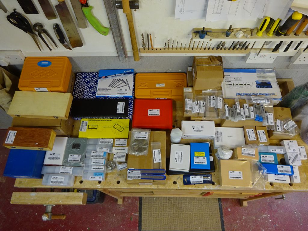

      So it's a lovely sunny evening and relaxing after a very successful week, Getting the Bridgeport transported and in her new home. I was able to put the workbench/racking back up and now it looks like a workshop again! very happy.
      I have been sat here for a while and sipping away on a nice local IPA compiling a list of all the things I know I don't have and will need now or in the future. I've also gone along and compiled a rough pricing estimate and link of the item. the list got fairly big fairly quick.
      I just thought I would share it here for some friendly critique and fine tuning.
      Naturally some of the items in there, could well be made by me if I can pull the trigger on a lathe but its more of a checklist of tooling to acquire by whatever means.
      Here is the link, I'd love to hear the discussion on things I may have missed (I haven't put anything on there I already have for example, or completely missed) or things your would purchase differently. What would you order of priority be?

        #646598
          Forget the number drill set, the metric sets you list will be sufficient, add a few larger reduced shank "blacksmiths" drills if you want say 16, 20 & 25mm
          The 58pc clamp set will do so leave the other bits off for now
          6" rotary table may be a bit small on a BP
          Get an R8 shank flycutter rather than the 3 small ones or better still a 63mm indexable face/shell mill & arbor
          Unless you intend to use 5C on the lathe then ER collets, blocks and a collet chuck may be a better option. I'd also use a ER32 collet chuck rather than the set of R8 collets
          Might want to add a boring head to the list
          This is what you need wink 2

          #646602
          Rooossone
            @rooossone
            Okay Duly noted and shopping list updated accordingly
            You are correct. I am certain I need all those things in that picture 😀
            What would you recommend on the rotary table front then?

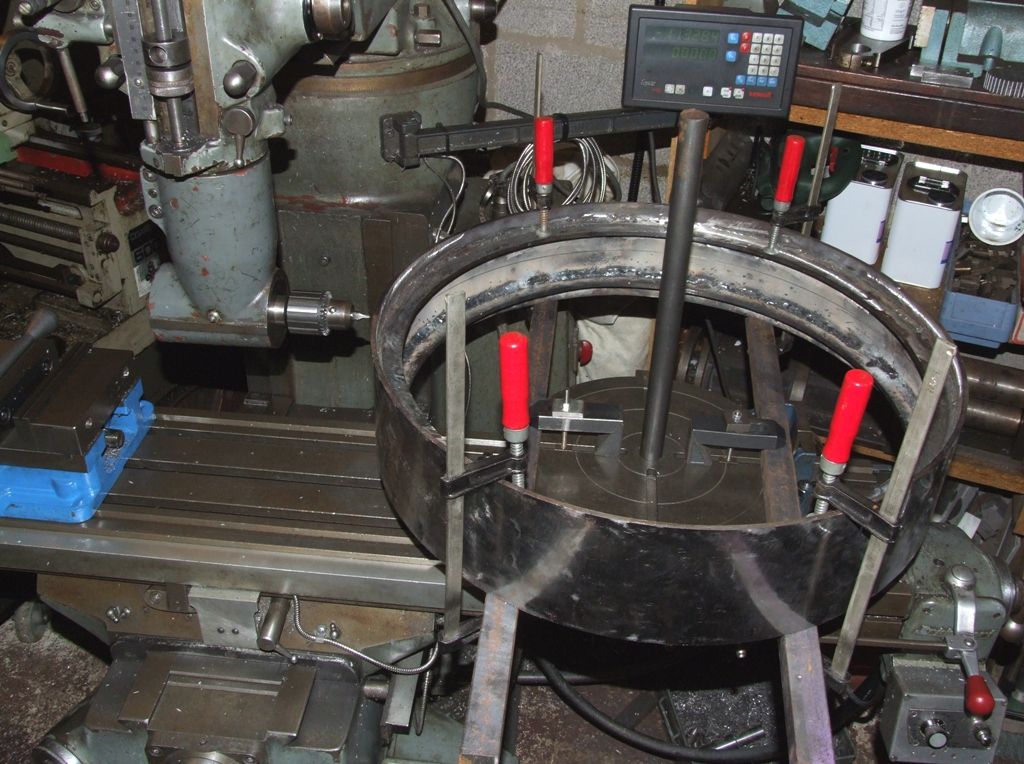

                                            Anonymous
                                              I use a 12" rotary table on my Bridgeport. Horizontal/vertical capability is a necessity:
                                              I prefer a parallel central hole, not Morse taper. A parallel hole means it is simple to make locating pegs:
                                              There is a rotary table hidden under the wheel!
                                              Andrew
