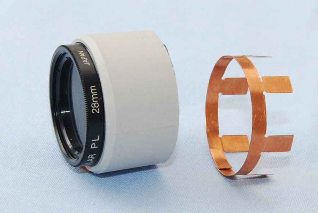

      The sheet is 0.2mm thick.

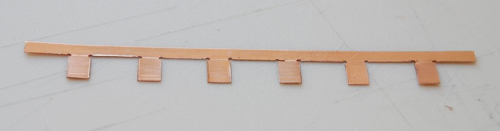

      I want to make a short strip of finger springs, similar to those which are used to ensure good conductivity between a metal case and its lid – although these are not for that purpose.

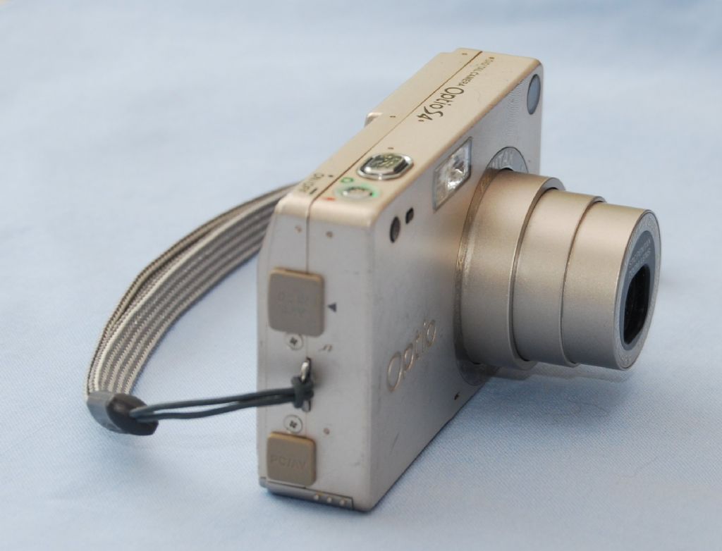

      I'll explain. I have a small digital camera to which I would like to attach a filter, and, of course there is no thread round the lens on these small ones.
      The outer-most section of the lens barrel, which is extended when the camera is switched on, is around 28mm in diameter, the depth of this section being 9mm.
      The filter I wish to mount is a 28mm one, the ouside diamter of which is a mm or so greater the barrel.
      I want to take a strip of phosphor bronze sheet, 10 to 15mm wide by 90-odd mm long, cut it so that it has a few fingers around it and bend it into a circular band.
      It would be permanently fixed to the filter with one of today's magic adhesives, so that the fingers now extending from it would grasp the lens barrel.
      I am quite dexterous but have no experience of working with this material, so any suggestions/advice could well save me a few quid which might otherwise go into the swear-box.

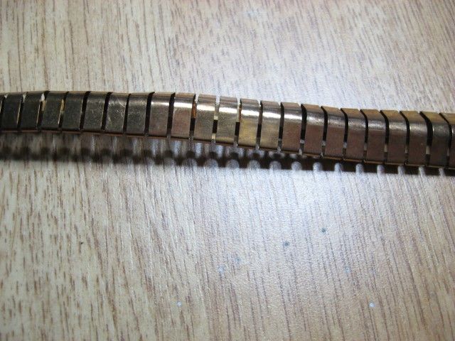

          Les Jones 1
            @lesjones1
            Hi David,
            It used to be possible to buy what you want ready made. It is called "finger stock" It is used for making connections to forced air cooled valves in high power UHF transmitters.
            This is what it looks like.

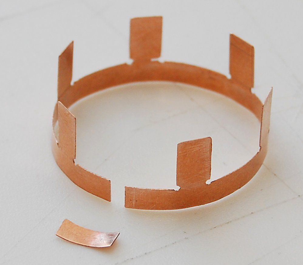

                                          I've started cutting to make spring fingers with the phospjhor bronze sheet. It'something I already had to hand so didn't have to search for other bits and pieces.
                                          If it isn't to my liking I will pursue one of the other methods mentioned on the various posts.

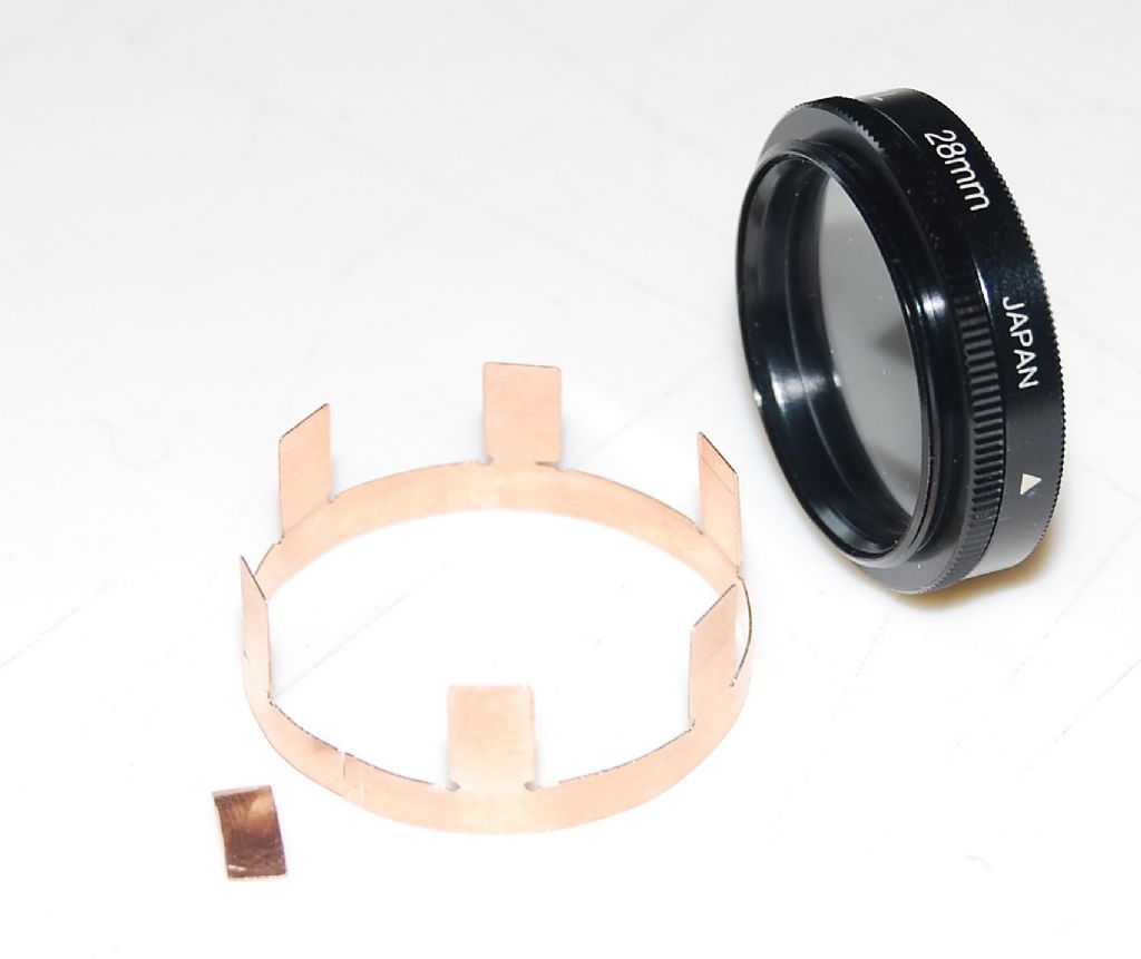

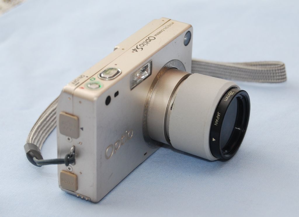

                                                  I've taken a few photographs of the fingers' creation. However, before I fifed them to the filter I found something which was more robust and decided to use that.
                                                  I don't know what its purpose was, I've forgotten. It looked as if it could have been an adapter for a vacuum cleaner but it was rather better engineered than the typical accessories I have seen.
                                                  It was basically a short, approximately 3" long, plastic tube with a slight taper.
                                                  I cut it down, affixed the filter with a few blobs of silicone compound and put three small pads of the felt (loop) part of a bit of velcro spaced around the inside which slides on to the lens.
                                                  I tried to put photos here before, but gave up fighting the system. Let's see if I have any better luck now.
