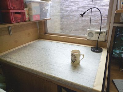

      I’m sorting out my workbench in the garage. It’s got a mini mill and mini lathe on it. I’m going to bolt them down and run cables power etc.
      I’m planning to use a 3m length of worktop. Any advice on colour would be appreciated. Obvs A is doesn’t really matter, B black will show less mess.
      But am I missing a trick on a lighter background. May as well get it right…

              I've got an offcut of light grey granite pattern wher my 3D printer lives. Because that's what I had handy!
