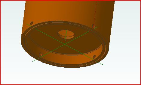

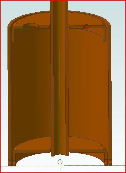

      The flanged bottom plate is fitted flange outwards so when the 4 holes are drilled and tapped they only go through the outer boiler barrel and the flanged edge of the bottom plate so will not "breach" the water space.
      Not sure what you are getting at with the chimney. It needs to extend from just below the bottom plate to well above the top plate. The hot gasses from the burner below pass up the chimney and it acts like an element to heat teh water as well as the hot gasses hitting the bottom plate of the cylinder

        Thanks for the 3D image, i couldn't picture it in my head but now it's clear. The drawing i'm looking at seems to show the bottom almost double walled but now i understand it isn't
        So does the chimney pass straight through the boiler, isolating the water contained from the inner wall of the chimney? I notice you have a center hole on that bottom plate? Ah the second image has appeared, i see that it does isolate the tank entirely. Thank you very much.

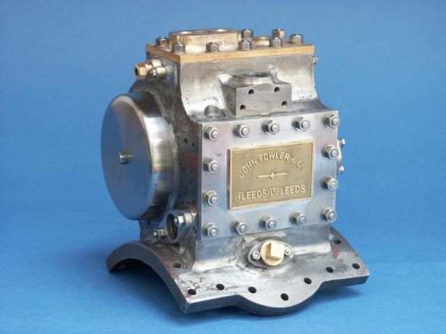

                        I spun the shiny steel end cover on this TE cylinder.
                        Press tools seem more common for flanging boilers than spinning
