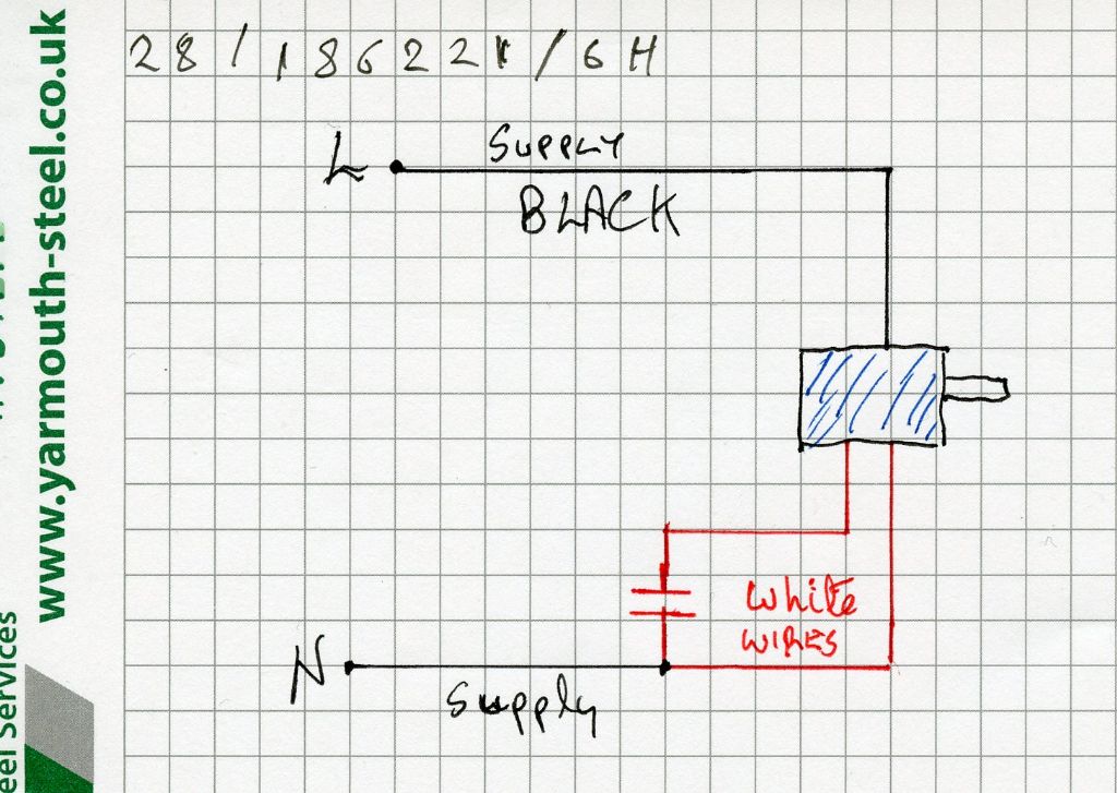

                I think this might help, based on the connections to the motor on my Quorn.
                Ignore the thin black wires. The thick black wire will correspond to the N (neutral) connection and goes to the common connection of the two windings. The tops of the two windings will be the two white wires, they go across the capacitor. The live L connection goes to one end or the other of the capacitor depending on switch position, for reversing.

                    Hi, this is the wiring diagram printed on the capacitor for my Parvalux motor, and although I've marked L and N they are not marked on the capacitor, but seeing how it's AC it shouldn't matter which one is Live and which one is Neutral. Mine works fine with it wired as shown, (and I know the white wires look red, but I don't have a white pen) smile The number on the sketch is the model number of mine.
                    Regards Nick.

                        I think John's and Nick's diagrams are probably correct. They are both functionally the same. The fact that the mains polarity is shown different does not matter. (Either way is OK.) If the motor rotates in the wrong direction then swap the power wire to the other white wire. (That is the Live in John's diagram. The neutral in Nicks diagram.) If you want to know what the thin black wires are then you will have to dismantle the motor. I can see three possibilities. They could go to a thermal fuse, A thermistor for monitoring the temperature. (This is not very likely on an old motor,) They may also may go to a centrifugal switch which disconnects the start winding when the motor gets up to speed. If it is a centrifugal switch it is faulty as it should measure almost zero ohms when the motor is stopped.
                        You could do a rough test of the capacitor by connecting it in series with a 60 or 100 watt incandescent lamp. (If you still have any of them.) The lamp should light but not quite as bright as when connected directly to the mains.

                                Brian
                                Connect as John Haine's sketch above but add some insulated sleeving over all of those wires as one of the white wires has a split in it, unless it is brittle.
                                For confirmation of connections schematic below, use the 3 lead capacitor and insulate the thin black wire.
                                Emgee
