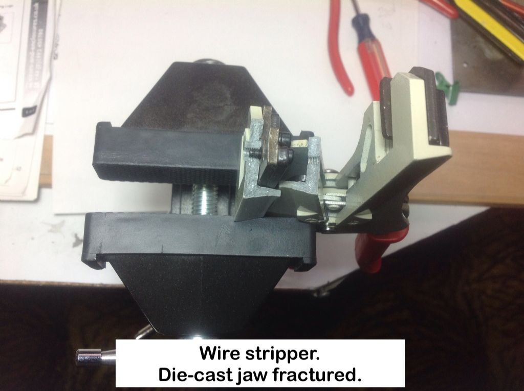

        As if suffering from extreme back pain wasn't enough, yesterday one of the wire stripper's jaws parted company with the main body, much to my annoyance.
        I was in the process of wiring up a control box for my coffee bean roaster.
        For once I didn't hurl the blithering thing through the window
        The tool is die-cast, and no doubt from the Far East as is the norm nowadays.
        I did have one years ago and that was of all steel construction.
        Is it worth trying to patch it up, make a new part in steel or bin?
        More photos in Album

          I've had another look and it's definitely bin!
          Too much involved to even think about repairs, let alone make a new part.

            That's Mazak = Bin
            I am not sure what my original Hellaman ones are made of but all three are still going strong after a few decades of use, dropping from high heights etc.. .

              Depends on whether youare short of projects or short of time..bet you can get a new pair before you get the bar in to make a pair.

                    Correct. I will remove useable parts then bin the rest.
                    Jason,
                    Far too many projects to add this piece of junk to the list.
                    IanT,
                    Correct. As soon as I noticed the grain on the pieces I knew, but I always live in hope.

                        I've repaired a few unsolderable things in the past by sewing them with 0.5mm stainless steel wire.
                        I use super glue to hold the parts together, drill small holes to take the wire, then use the wire to stitch it together. After the wire is pulled tight I then smother it in super glue. It works pretty well – not pretty, but serviceable.
