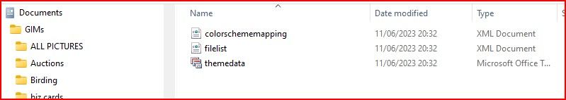

      Probably a simple question for the computer literate please…
      Every so often when I go into my file explorer to open something I have saved, I find the file missing and these three 'files' in its place.
      Where has the original file gone and is it recoverable from the remains ?
      What causes this to happen please ? I've had it happen many times over the years.
      Gerry

          A few details about your operating system and computer may help slightly

            Gerry's 'file' is actually a folder containing three files that together describe a Microsoft Office document. I think they are all 'meta data', that is data about data, rather than the content itself. XML is a 'Markup Language' used to describe data and data structures. I guess 'colorschememapping' contains the rules used to colour text, foreground, background etc, whilst 'filelist' identifies the files containing whatever the user typed in. Could be one or many files in a container, depending on the application. Webpages are usually built from many files, whilst a letter is only one. XML files are human readable and can be opened safely. 'themedata' looks like meta-data too, but probably not human readable because it's identified as a 'Microsoft Office' type.

                Thanks all for taking time to comment but as SOD put it, its still as clear as mud, at least to me ! In the most recent occasion that this issue occurred (that prompted me to make this post) it was with a pdf. I think, everything I read refers to word documents.
                None of the '3 files' is ever readable to me so I cant work back and work out what caused this to occur. There must be some special conditions at play as this isn't the norm when I save files. Let me see if I can find the conditions that reproduce the fault and I will come back for more help.

                  Right click and choose "open with – Notepad. This will be text only and harmless, though perhaps of limited use. Generally though, it does help work out what is going on. However, to get this to work on all or most files you may need to enable some options in folder options/view.
                  #650684
                  Anonymous
                    Gerry, what's missing for me is knowing what program you were using when you saved the file(s). I don't see how your questions can be answered without that information.

                      I think what's happening is Windows has lost the file association. When a file is opened with Explorer, the file extension is used to identify whatever program will work with it. So if the extension is .TXT, Explorer usually launches Notepad. As almost every computer is set up differently, File Associations can be added, changed and removed. Normally by installers, also manually. Several ways File Associations can be lost. Installing and uninstalling applications, malware, malfunction or owner messing with the Registry, and even Alpha Particles!
                      If Explorer doesn't have an association, it may default to a general purpose action such as 'show what's inside' rather than the expected 'launch the application'. Sounds like your problem. Explorer doesn't know what to launch, but its smart enough to name what's inside.
                      In Explorer, try Right-Clicking on the file. Should get a menu with an Open option that lists Applications, one of which can be selected manually. For example, if the file is a PDF, a PDF reader such as Adobe, Foxit, Word, OpenOffice etc. Look for the name of the application that created the file in the first place.
