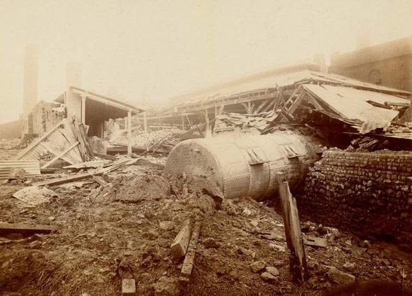

                        #88160
                        Terryd
                          @terryd72465
                          HI John,
                          This is 'Messy' and shows what can happen to those who mess around with boilers smile o. A factory boiler explosion about 1/4 mile where I was born – before my time though I must add:-
                          Boiler explosion at Batmans Hill Works, Bradely,  Coseley.
                          Quote:
                          "Bradley boiler explodes: January 20 (1903 – my year dating)- A boiler explosion in the No 2 mill at Tupper & Co's Batman's Hill ironworks at Bradley killed mill manager James Warren and engine driver Harry Southall instantly. Another 13 were injured with furnaceman Richard Cooper and roller Edward Holloway died in hospital. Thousands of people trekked to Bradley to view the devastation and a collection was made in the street for the families of the bereaved."
                          Bit extreme though!
                          Regards
                          Terry
                          Edited By Terryd on 30/03/2012 10:21:58
