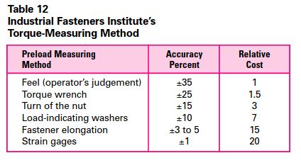

      Posted by Michael Gilligan on 20/10/2022 11:38:18:
      Posted by SillyOldDuffer on 20/10/2022 10:03:22:
      Sorry to be a swot, Dave ^^^
      **LINK**
      No problem Michael and the Unbrako link is suggestive because it mentions washers in the text only once and the use-case pictures don't show washers at all.
      Washers are mentioned only in this torque measuring table, which adds a washer reason I missed load-indicating:
      The accuracy values quoted are quite interesting too! That humans judge torque poorly isn't surprising, but I thought torque wrenches were considerably better.
      'Turn of the Nut' is a new one on me. Can anyone explain how it works?

        Posted by SillyOldDuffer on 20/10/2022 16:11:20:………
        Only guessing, but could it mean something like those plastic pointers you see on lorry wheels?
            **LINK**
            Hi Dave, in recent times on cars, many nuts are torqued up in two or three stages, and then finally turned by a set number of degrees once or even twice. Don't know if this is what is meant by the term 'turn of the nut' but that's all I can think of. I have had to use that method in industry as well.
            Regards Nick.
                Spark plugs into alli cylinder heads – instructions might read something like "…turn to finger-tight washer contact, then tighten 1/6th turn only."

                      The clamp load applied for a given applied torque will differ greatly, depending up the pitch of the threads and the materials used in the threads, and lubrication, or lack of it.
                      "Turn of the nut" methods are often used , in the field, when tightening to yield.
                      This maximises the clamp load applied , and makes it consistent, in the fastener.
                      The fastener is tightened to a "snug" toque, and then tightened a further increment to put the fastener into yield, The figures will depend on the grade of fastener used.
                      As an instance, a 1/2 UNF in W range might be snugged to 90 lb fit and then tightened another two flats to put into yield.
                      Torque wrenches vary in their accuracy, and how the are used also affects accuracy of the applied load..
                      One dial wrench supplied by very well revered tool supplier / manufacturer, was found to be grossly inaccurate when checked, no matter how it was operated..
                      "Break back" wrenches are VERY susceptible to how the torque is applied. A suddenly applied load can apply a vastly exaggerated load.
                      Torque wrenches are best used by applying the torque gently until the wrench either indicates to required torque, or clicks, or "breaks"
                      Strangely, some of the most accurate wrenches, in terms of applied torque vs reading are the "bendy bar" type where a pointer moves over a fixed scale as the bar bends under the applied torque.
                      A torque wrench can be checked for accuracy by using it to apply torque to a pulley of known diameter, around which is a wire carrying known weights, to lift the weight. Using different weights allows the wrench to be calibrated, so that the scale reading can be compared with the actual torque being applied..
                      (Then, one has to be confident of the accuracy of the pulley diameter, and the weights, to be sure of the torque calibration! ) .
                      Howard
