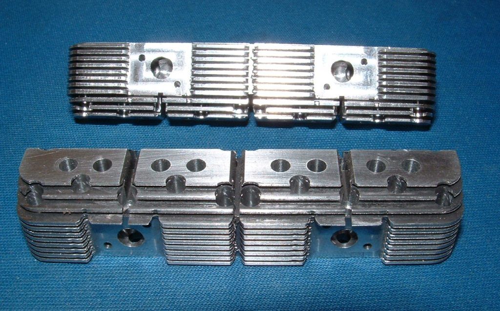

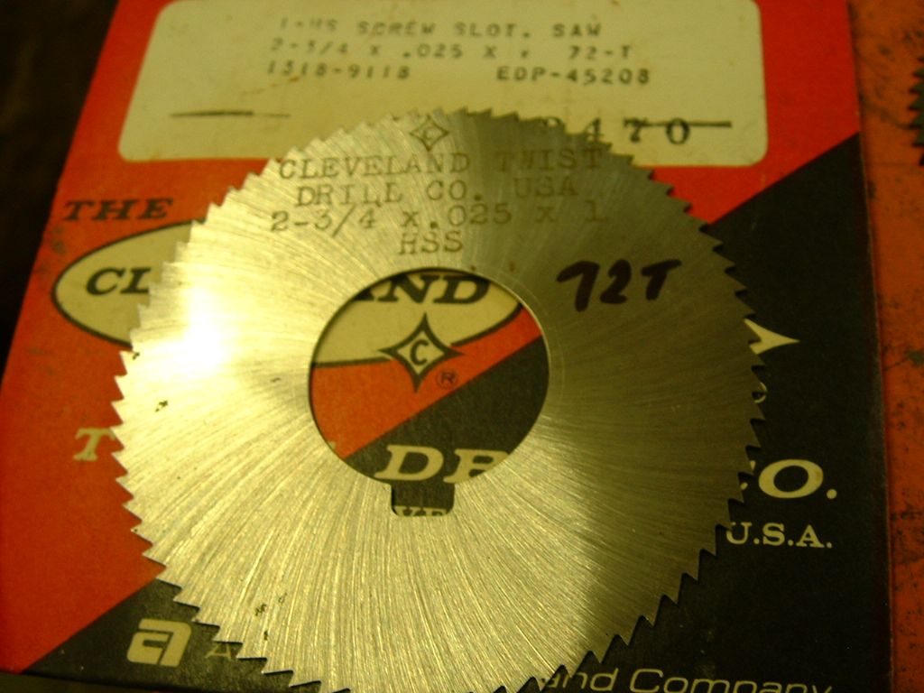

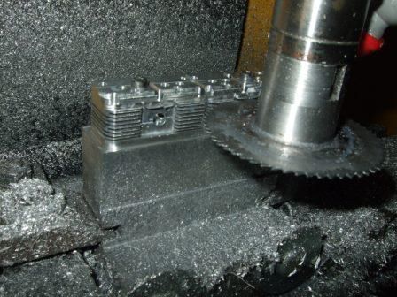

                Selection of slitting saws I have pictured in my album and 2 below show the .025" thick 72T cutting cooling fins on a 6082T6 aluminium cylinder head. Like Andrew says make sure the gullets are kept clear or jamming will occur, I use mist and air immediately after the blade exits the cut, this keeps swarf clear and lubricates the blade. Tooth pitch for the blade shown is 0,120"
                Adjust your DOC and spindle speed to suit the job and remember thin blades can easily run off-line if pushed too hard.

                      Yes Michael, for the blade pictured above tooth pitch is calculated as 0,120" which is a shade over 8TPI (8.3).

                                              Yeah, says so on the box 72 t ( on the circumference, see Emgees first pic ) thats usually how suppliers sell `em Dia x width x tooth count !
                                              Nice work on the cylinder heads Emgee………b
