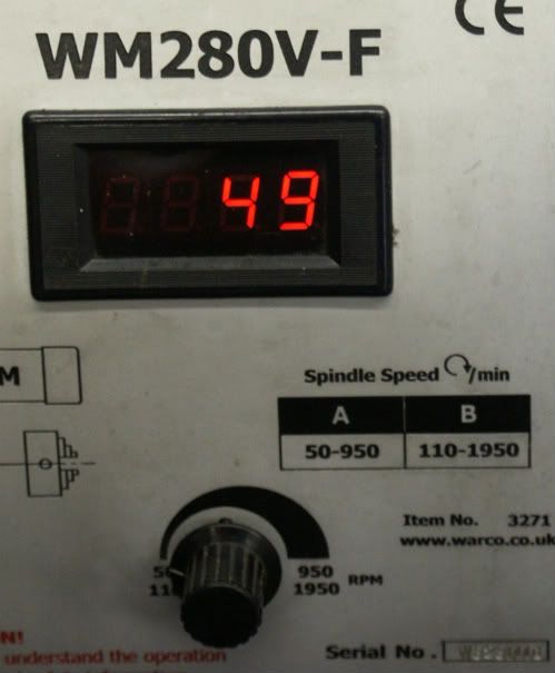

                  EtheA, this shows my lathe running at the slowest speed, you can also see the two speed ranges depending on what pully you are running the belt on.
                  Terry if you are getting the stand with your lateh you may want to replace the curved panel between the two cabinets with something thats a bit less wasteful of space.
                  Also put some mastic under the lathe feet before you bolt it down through the drip tray, the gearbox does weep a bit of oil that will drip down into the cabinet though it does keep the rust off the tooling in there
                  The feed chart on the lathe does not show any feeds for the “C” range but it can be used to give an even finer cross feed than those shown.
                  And yes before anyone says I have removed the chuck guard mainly because the toolpost hits it when you want to work near the chuck and any faceplate work is impossible with it in place unless you want 6″ of tool hanging out the holder.
                  Jason
