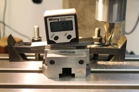

                              I originally imported my Wixey from the US before they and the copies became commonplace, It was the ideal thing to stick on the side of my tablesaw blade to set the angle.
                              Callibration was mentioned earlier, the Wixey is zeroed at the tough of a button on any surface so even if your saw table, mill, lathe bed, etc is not spot on it is easy to set to zero and measure the angle relative to that surface. Also stays stuck to a lathe chuck so you can do simple angular setting out.

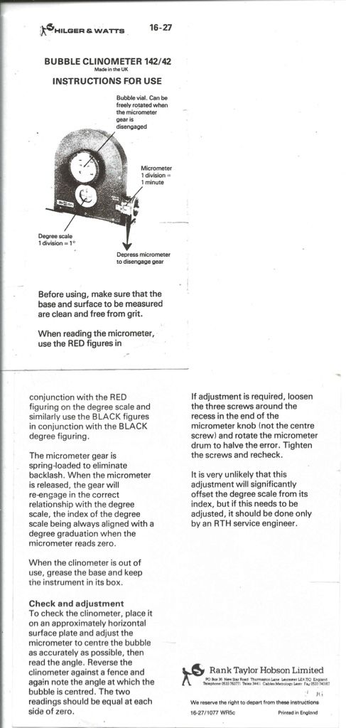

                                Steve,
                                Just to confuse the list slightly:
                                My example is badged 'Rank Taylor Hobson Ltd.' 142/42
                                I've attached a copy of the [very brief] instruction leaflet for info.

                                      Thanks for posting that Michael. They certainly didn't go overboard with instruction manuals in those days!
