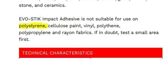

                        It will attack the polystyrene

                          #802193
                            The solvents in the glue will melt the strip, make it go soft and your handrail will lean over.
                            It also needs to be applied sparingly to BOTH surfaces which will not be easy inside such a small hole and as it can’t be moved once the two coated surfaces make contact you won’t be able to push the rod into the hole.
                            last downside is it remains flexible so even if it did not disolve the part and could be stuck in the hole it would wobble about.
                            Cyano will be fine
                            #802194
                              From Nick’s link
                              poly
