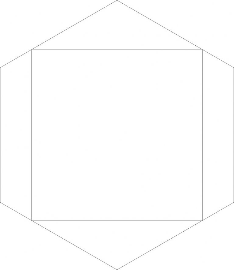

                    Posted by Michael Gilligan on 07/12/2014 11:01:57:
                    Posted by Michael Horner on 07/12/2014 09:27:20:
                    Posted by Michael Gilligan on 07/12/2014 04:14:43:
                    Posted by Brian John on 07/12/2014 02:54:29:
                    NOTE 1 : I have ruled out buying the 4 jaw independent chuck.
                    In that case, Brian … The choice between 3-jaw and 4-jaw self centering chucks is fairly simple.
                    • The 3-jaw will easily and securely hold round and hexagonal material.
                    • The 4-jaw will easiily an securely hold square material.
                    Yes, the 4-jaw will probably hold round material, but less reliably than the 3-jaw.
                    … holding most other sections will require some initiative.
                    Hi Michael
                    Why won't a 4 jaw chuck hold round material as well as a 3 jaw?
                    I seem to rememeber that clever chap in the US who made the laser centering device for the mill spindle has a website, someone posted a link and I had a look. One of the things he said was that he preferred a 4 jaw independant over the 3 jaw indepandent because it would grip round, hex and square bar.
                    Grey matter could be off, it's not doing very well at the momentsad
                    Cheers Michael.
                    Michael,
                    I think Neil has probably answered most of this on my behalf, but here goes …
                    • Brian has already ruled out the 4-jaw independent
                    • I was therefore talking explicitly about 3-jaw vs 4-jaw self-centering.
                    • For your homework, today read about kinematics …
                    • why do photographers and surveyors use Tripods?, and why does a milking stool have three legs?
                    • Extrude that point contact in the Z-axis and you have three lines
                    • At the limiting condition; when real surfaces meet, there is only ever three point contact … anything more will involve [perhaps microscopic] distortion of surface[s].
                    Now, translating all of this to the self-centering chuck question: The 4-jaw will grip round stock less reliably for the same reason that a four-legged chair might wobble on a floor [whereas the three-legged stool will never do so].
                    The independent 4-jaw is, of course, a different matter.
                    And, by the way; the 3-jaw self-centering will grip any shape … provided that it has constant cross section along the length … it's just that the centre will be wherever it falls naturally.
                    Hope that makes sense … happy to discuss further, either here or by P.M.

                      Posted by Michael Horner on 07/12/2014 19:16:05:
                      Hi MichaelG and Neil. Apologies to the OP.
                      Dan Gelbart was the name of the US guy I was thinking of, this links you to one of his youtube videos. **LINK**
                      About 3/4 of the way through he talks about using a self centering 4 jaw chuck. He has a bit of an accent so I may have miss heard him. Hearing gone south as wellsad.
                      Michael,
                      Thanks for the reminder about Dan Gelbart's remark … Very interesting !
                      I have just checked his video, and I think he's recommending a self-centering 4-jaw.
                      It's very brief, but he does appear to show a self-centering 4-jaw gripping a hexagon at four points [lines]. … I must admit, that's counter-intuitive; but it's food for thought.
                      That said; I do stand by my opinion on the kinematics.
                      Edited, and hopefully clarified.
                      Edited By Michael Gilligan on 07/12/2014 19:53:46
                      #171885
                        Posted by Michael Gilligan on 07/12/2014 19:42:41:
                        … It's very brief, but he does appear to show a self-centering 4-jaw gripping a hexagon at four points [lines]. … I must admit, that's counter-intuitive; but it's food for thought.
                        Well … I thought, and I browsed and: Yes, it does work geometrically.
                        Look here, at the diagram for the largest square within the hexagon. The four intersection points prescribe the locations at which the external chuck jaws would need to act.
                        The practical usefulness may depend on the shape of the chuck jaws, but the theory is good.
                        The day is not wasted … I have learned something.
