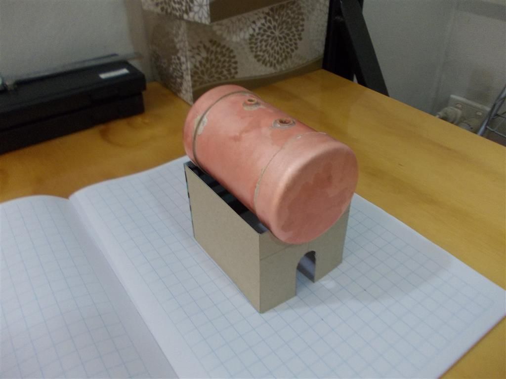

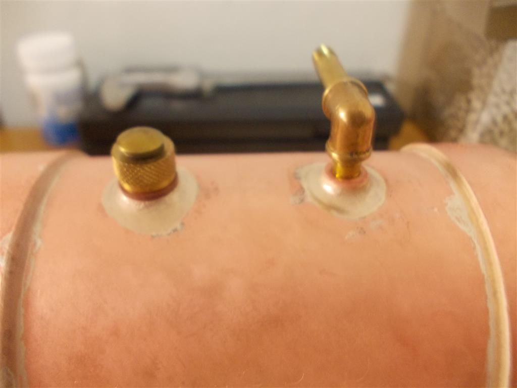

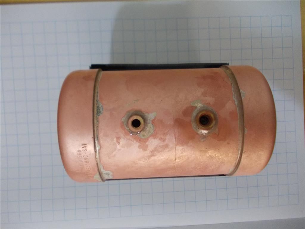

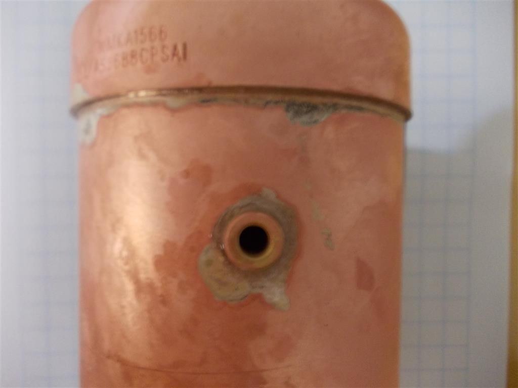

                                      I have had a few problems positioning the steam outlet bushing and the safety valve bushing in the top of my horizontal boiler. I have previously built three vertical boilers and these bushings sat evenly on top of a flat surface on top of the boilers so there was no problem.
                                      But with this horizontal boiler the bushings sit on a curved surface. About an hour after I had silver soldered them on I realised that they were not quite vertical. So I had to remelt the solder and reposition the bushings (with a pair of pliers while the solder was still hot) to correct them otherwise the safety valve and steam outlet would have not been perpendicular. I will post some photos later after it has come out of the citric acid pickle.
                                      How many times can you remelt silver solder before it loses its strength ?
                                      Edited By Brian John on 04/07/2015 08:01:16

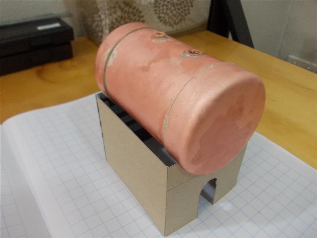

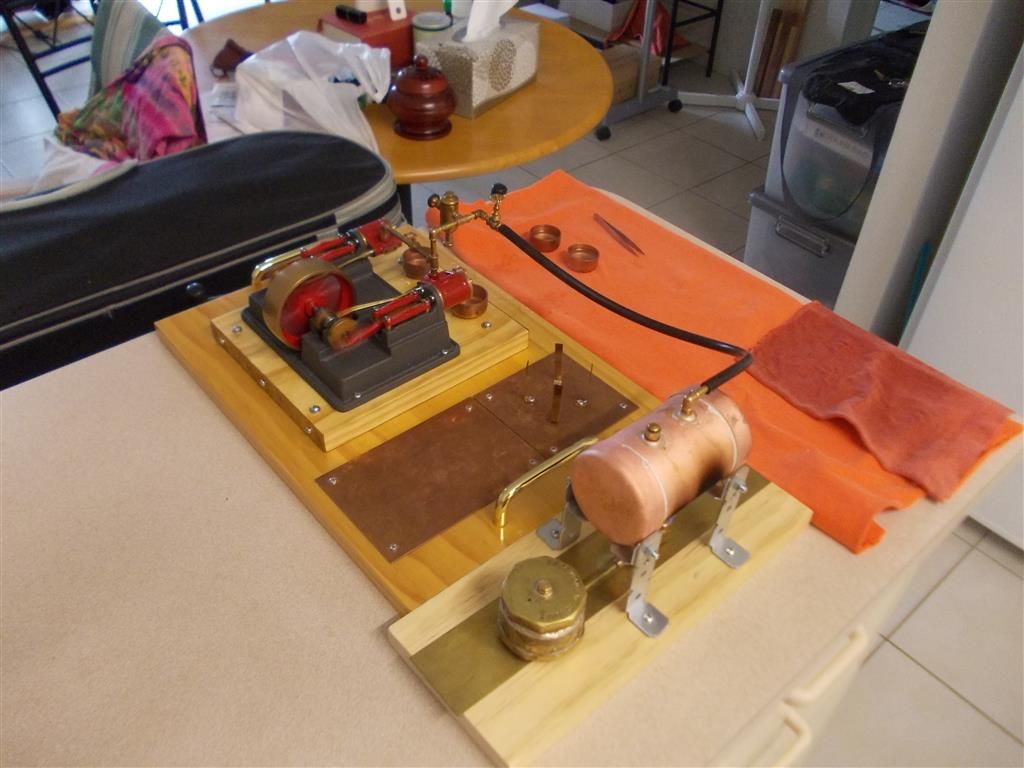

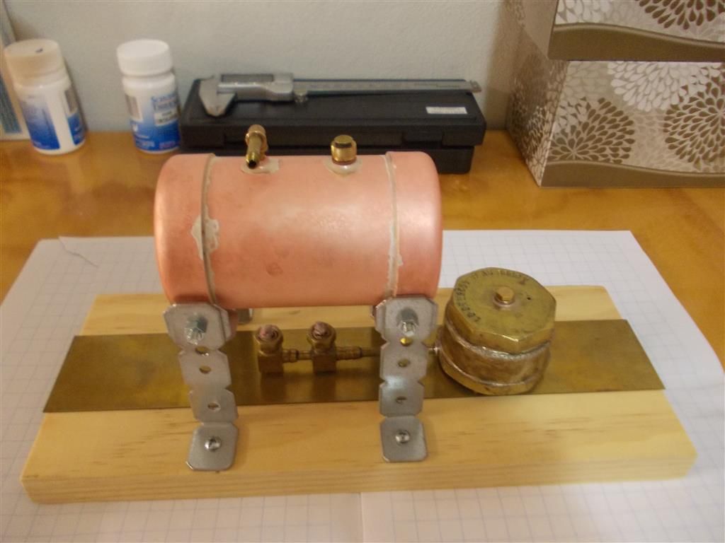

                                        Here is the finished (?) boiler. I may paint it with heat resistant paint. It is resting on a cardboard mock-up of my firebox which will be constructed of 0.6mm brass ; two flaps will be added to the top to seal the gaps between the top of the firebox and the boiler. There will be an L shaped chimney at the other end.
                                        Edited By Brian John on 04/07/2015 11:19:46

                                          I have added another fillet of solder to both steam outlet and safety valve. It looks much more respectable now. The photos below show the boiler in a test rig I have made up. I will fire it up tomorrow to see how it goes.

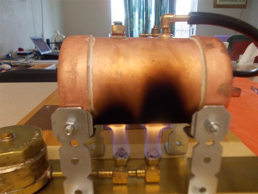

                                            Testing out the new boiler and it works very well but a good firebox is essential here. A lot of heat is being lost so it should run much better when a firebox is constructed. I am waiting on the brass sheets from China.
                                            I do have some questions though :
                                            1. That is a lot of soot which is not visible on the vertical boilers because on those it is concealed by the fireboxes. I thought methylated spirits was a relatively ''clean'' fuel ?
                                            2. I am going to have to paint this boiler but I am unable to find a heat resistant paint in Australia that will tolerate direct flame. What do they use in the UK when they paint their boilers ?

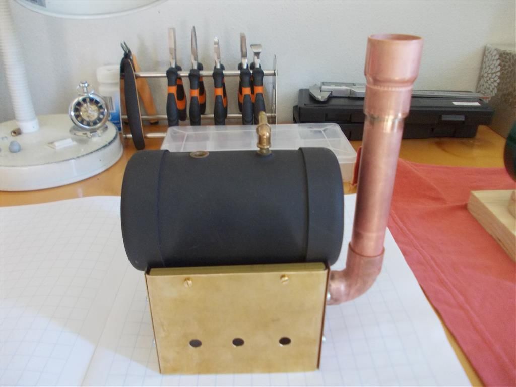

                                            3. I will also have to bend a brass pipe (inverted semi-circle)  from the steam outlet so that my silicone tubing does not get cooked. Can this be done  without bending springs ? I always get a kink in it when I try it.

                                              I can;t speak from using steam boilers but I always find that the yellow part of a flame has the most unburned components and sitting objects nesting at the top of the blue gets max heat. Alternatively you need to introduce more oxygen into the flame in the way a bunsen burner or gas torch does, perhaps, to get more complete combustion.

                                                  I did intend to build another burner with three wicks but this one with two wicks seems to be running the engine okay.
                                                  The tricky thing about the fire box is to make sure there are no gaps between the top of the sides of the firebox and the boiler itself. A lot of heat can be lost here. I am considering soft soldering the boiler to the firebox to achieve this. I will decide once the firebox is constructed.
                                                  Soot : I was wondering if raising the boiler another one centimeter above the flame might improve things ? But once the firebox is built and the boiler painted then who is to know

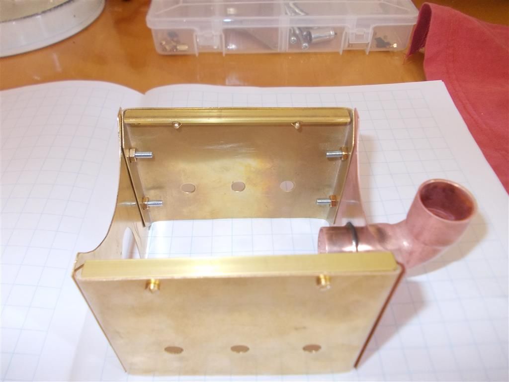

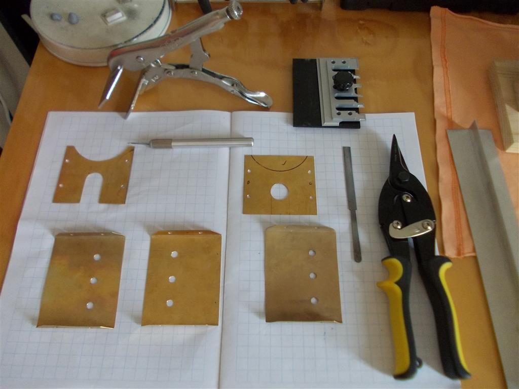

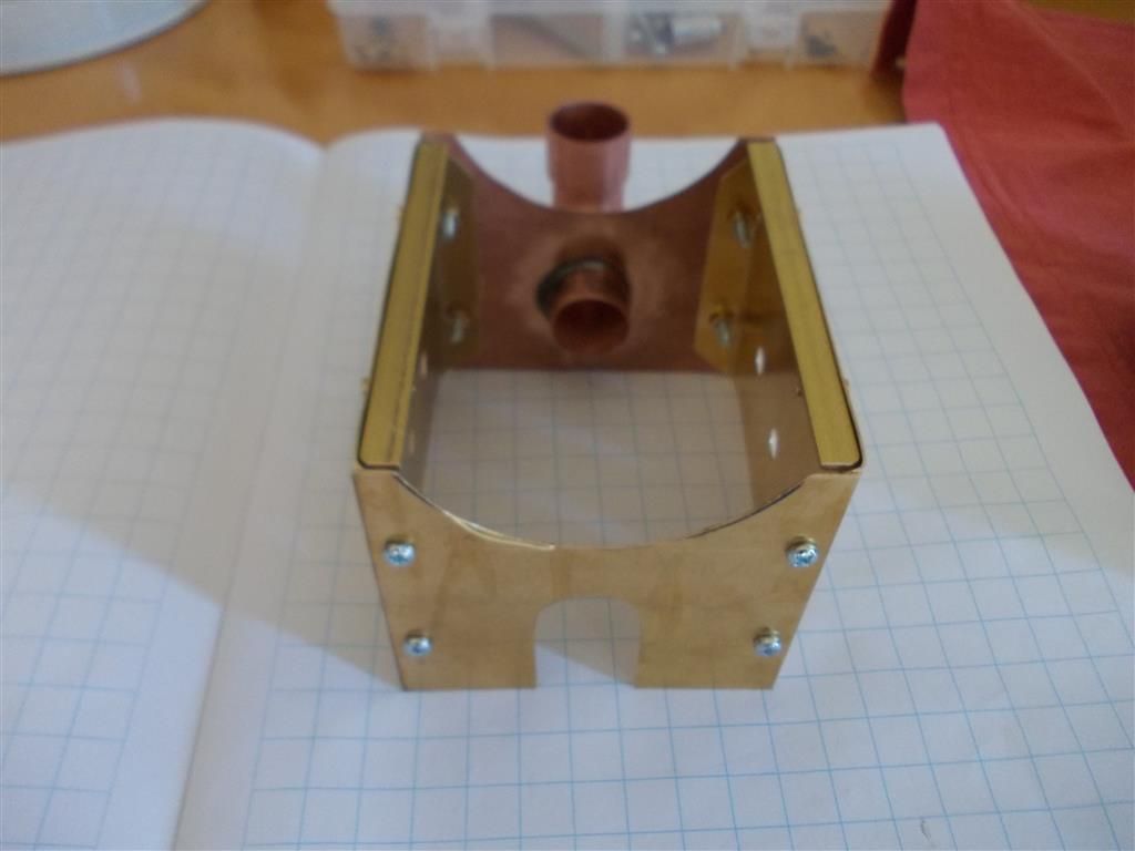

                                                    The .6mm brass sheet arrived a few days ago and I have been attempting to build the firbeox for this horizontal boiler. I thought the main problem would be cutting out the curves on the ends for the boiler but this turned out to be very easy with tin snips and a Dremel tool to clean up. The big problem is bending up the tabs on the sides.
                                                    I thought I could use a hold and fold tool for this but the brass is too thick. So then I tried the sheet metal bending pliers but I still was not getting nice sharp right angle. Some online sites suggest heating the brass to anneal it but this simply made the brass wobbly and impossible to straighten out again. It did not seem any easier to bend anyway !
                                                    I have had most success with scoring along the bend line with a large scalpel blade then bending with the sheet metal pliers then bashing it into shape over the edge of a piece of timber. This all seems quite primitive. Is there a better way ? How would you have done it ? I should have used some brass angle as internal supports and soft soldered the whole thing together but I thought this would be easier

                                                      This is the completed firebox : it's even square It just needs two boiler bands now. I am waiting for my dies from the UK to tap the brass to do this. That ''heat resistant paint'' on the boiler is not all that heat resistant and I am thinking of burning it all off. There is no genuine heat resistant paint available in Australia ; nothing that will withstand contact with direct flame.
