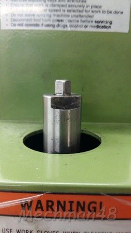

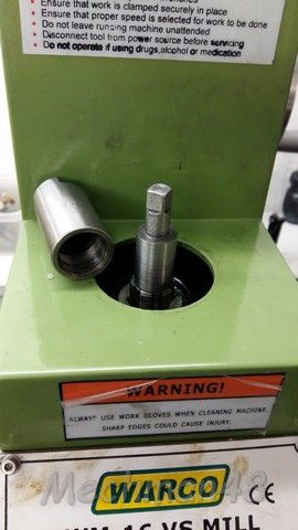

          ​Dave,
          ​I have the WM16 , your draw bar configuration is different to mine, yours has the large collar on it whereas mine is machined smaller. Looking at the pics could you not machine the collar down to fit inside the steel 'top hat' as I think yours screws onto the spindle as mine does thus making yourself a 'self ejecting' drawbar…
          ​My configuration…
          I reckon you've got your set up wrong… as you put the tool MT2 in the spindle you should be nipping down onto the top of the spindle with the bottom of the draw bar collar, only snug it though, put the steel 'top hat' on & screw it down on the spindle thread 'till it seats on the top of the spindle. when you want to change tooling you unscrew the draw bar up until the top of the collar meets the internal underside of the steel 'top hat' & forces the tapers apart… no need for a hammer at all…

            Yep, mine's the same as George's (WM-16), I added some photos to an album
            Maybe the WM-18 has a different arrangement?

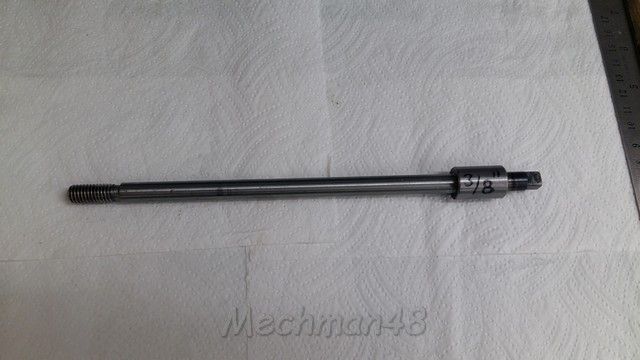

              My other draw bar is the 3/8" & that has the collar that fits inside the steel 'top hat' too…
              3/8 draw bar set up (5).jpg

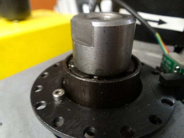

                    Interesting George and Ed. I'd assumed that the WM18 was just a slightly larger version of the WM16. Looks like the drawbar on the WM18 is more primitive. I wonder what else is different?
                    Here's what my spindle top looks like with the cover off:
                    The black disk with holes in it is for the rpm display. Turning the two flatted nut moves the whole spindle; it doesn't seem to unscrew. Compared with your WM16 photos the WM18 spindle top is relatively flat. It's different. I think I'm OK but will be re-reading the manual to make sure!
