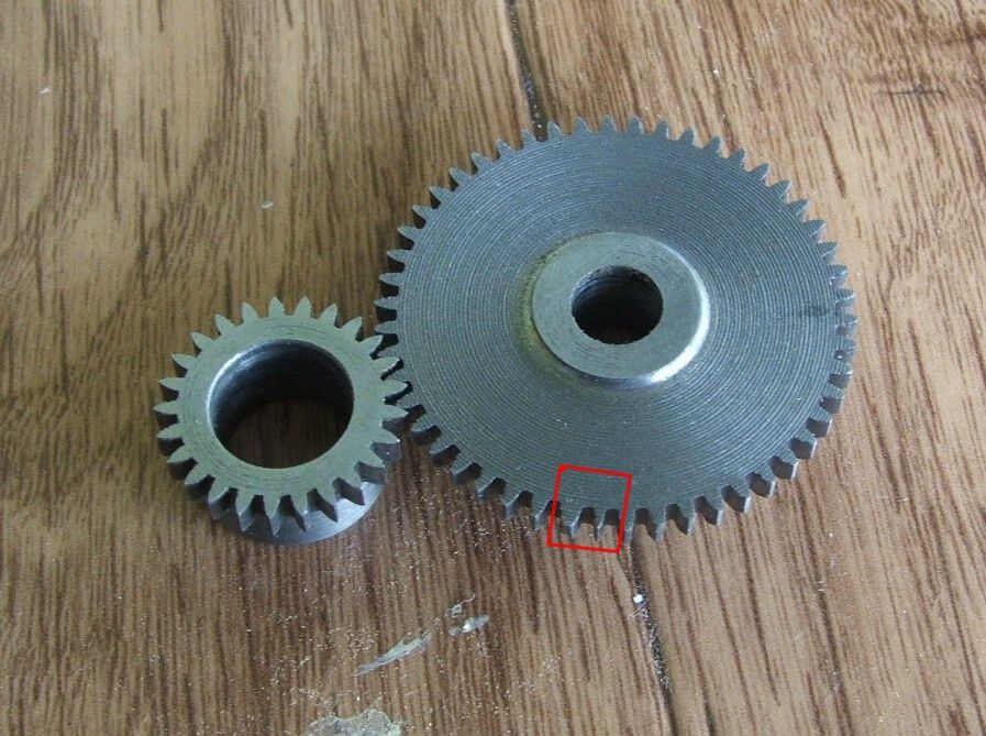

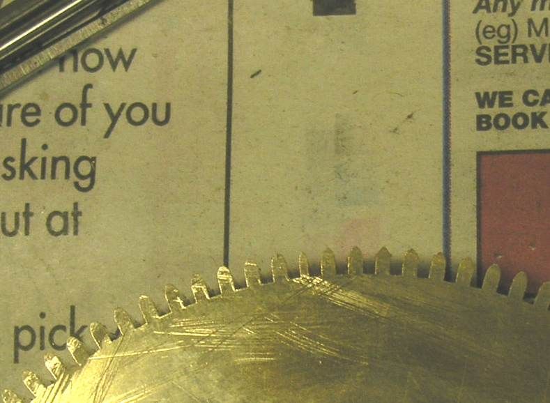

        Been cutting some 115t 0.75m wheels using a Thorntons cutter. I calculated the blank dia using the formula (N + 2.76) M which gave a blank of 88.32mm or 3.477″ but I have ended up with a thin tooth on each wheel which indicates a slightly small blank?(I think?)
        I cut the teeth until there was just a tiny witness on the tip as I have done before but a feel bit dissapointed as I have ruined 4 wheels made from 5/16 thick engraving brass.
        Next time I will try a dummy run on some 1/8″ which I have plenty of!
        Are my calcs correct or have I missed something?
        Peter
        #81338
        MICHAEL WILLIAMS
          @michaelwilliams41215
          Hi Peter ,
          Could you clarify for me whether you have just one thin tooth on each blank or are all the teeth on any one blank thin ? Different answers to your query depending on what you say .
          MW
          #81341
          Peter Bell
            @peterbell11509
            Hi,
            I have a thin tooth on each blank, rest of the teeth look fine, Thats what made me think that I have size problem with the blank. I use my Super 7 with a milling spindle on the cross slide to cut the teeth, cutter running at about 3000rpm.
            Peter

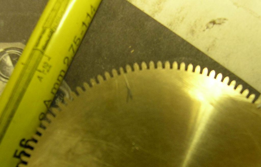

                                                  Peter Bell
                                                    @peterbell11509
                                                    Thanks everyoner for all the comments.
                                                    Just measured the teeth and they are of equal thickness apart from the thin one. We thought of using dividers to check the division plate but felt that it would be easier and more accurate using the BW Electronics DRO and wind the cord from it around the 3 jaw chuck. Went round the plate twice but could not find any error of more than a thou or two between the holes.
                                                    I like the direct indexing as there is less chance of making a mistake and you can feel as well as hear the dentent going into the plate. It is dead tight with no slipping/backlash anywhere.
                                                    Did not see the problem when I took the cut wheel from the mandrel as I was quite pleased at how good it looked, must clean my glasses more often.
                                                    Just cut a disc to do a trial, pondering it I should make it slightly larger or the dead size from the formula.
                                                    Next time I will examine the blank before removing it from the mandrel so that I can see where the thin tooth lines up with the plate—if there is a thin tooth!
                                                    Peter
                                                    #81452
                                                    Sub Mandrel
                                                      @submandrel
                                                      We are barking up the wrong tree here.
                                                      Even with direct indexing, any error that is visible, should be matched by an equally visible error on the divison plate.
                                                      Blank size won’t cause this error; blank too small, all teeth slightly too thin and vice versa.
                                                      A slipping error will result in a matching fat tooth for the thin tooth.
                                                      So look for a matching error on the plate.
                                                      Alternatively use a rotary table.Any error in the division plate will be cyclical, so if the ratio of the rotary table is 60:1 the error will be divided by sixty and 1/60th of it will be evident for each complete circuit of the blank.
                                                      In other words small errors in hole spacing become totally inconsequential – an error of 1 degree, easily visble to the naked eye, will only make a 1 minute error in tooth position. You won’t be able to see that.
