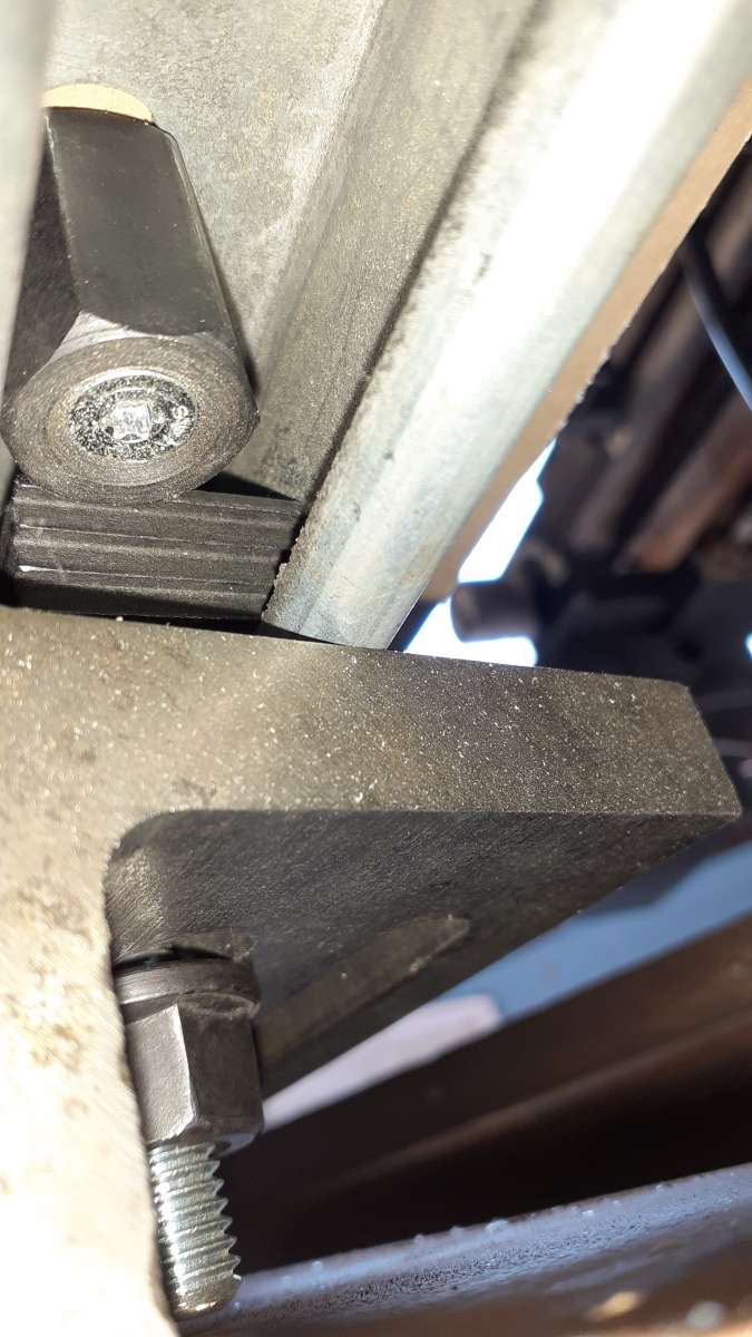

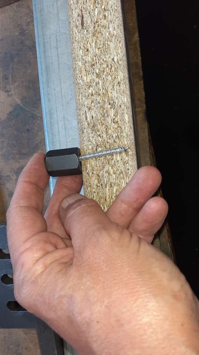

                                  Sounds like Unistrut to me
                                  Here you go bit of Unistrut screwed to an offcut of 40mm worktop. Angleplate and G clamp holding a 56lbs anvil to it.
                                  20240812_112218
                                  just the ONE 5 x 60 screw screw with a spacer so about 35mm into the worktop.
                                  20240812_11011720240812_110010
                                  I assume you will use more than one screw in which case unless your frame is bolted to the floor when you try to lift by the worktop it should stay attached. I suppose the differences are from those of us that work with wood for a living and those that don’t. Same people who said the stand for my CNC was no good yet now several years since and a lot of work done with the machine and no problems with the screwed together stand. Mark, Ega and myself have said modern woodscrews will do, we work with wood.

                                          Coming back to pull out loads etc, it’s a long time since I have done strauctural calculations so better to just use a practical approach
                                          The first post and subsequent reply relate to holding the worktop down to the frame and then being able to lift the frame by the worktop.
                                          Holding the top down to the frame really puts no load on teh screw save for resisting a bit of possible cupping
                                          Lifting the frame by the worktop will put more load on the screwed joints. As my photo shows a single 5mm screw will hole 60lbs( anvil, clamp, angle plate) so lets say 25kg per screw. You don’t say what size your frame is but lets assume a 600 x 1200 with one cross member in the middle. Put screws at 200mm cts along the five frame members as that is a total of 21screws.
                                          21 x 25kg = 525kg so even if you could lift that much it is unlikely that the screws will pull out before your arms come out of their sockets.
                                          Now you have said you want to put “heavy” equipment onto the bench. As I have said in this situation the load is all downwards so the screws really only stop the worktop sliding off the frame if you wheel it into soemthing and stop suddenly so no really worries about screw loading there.

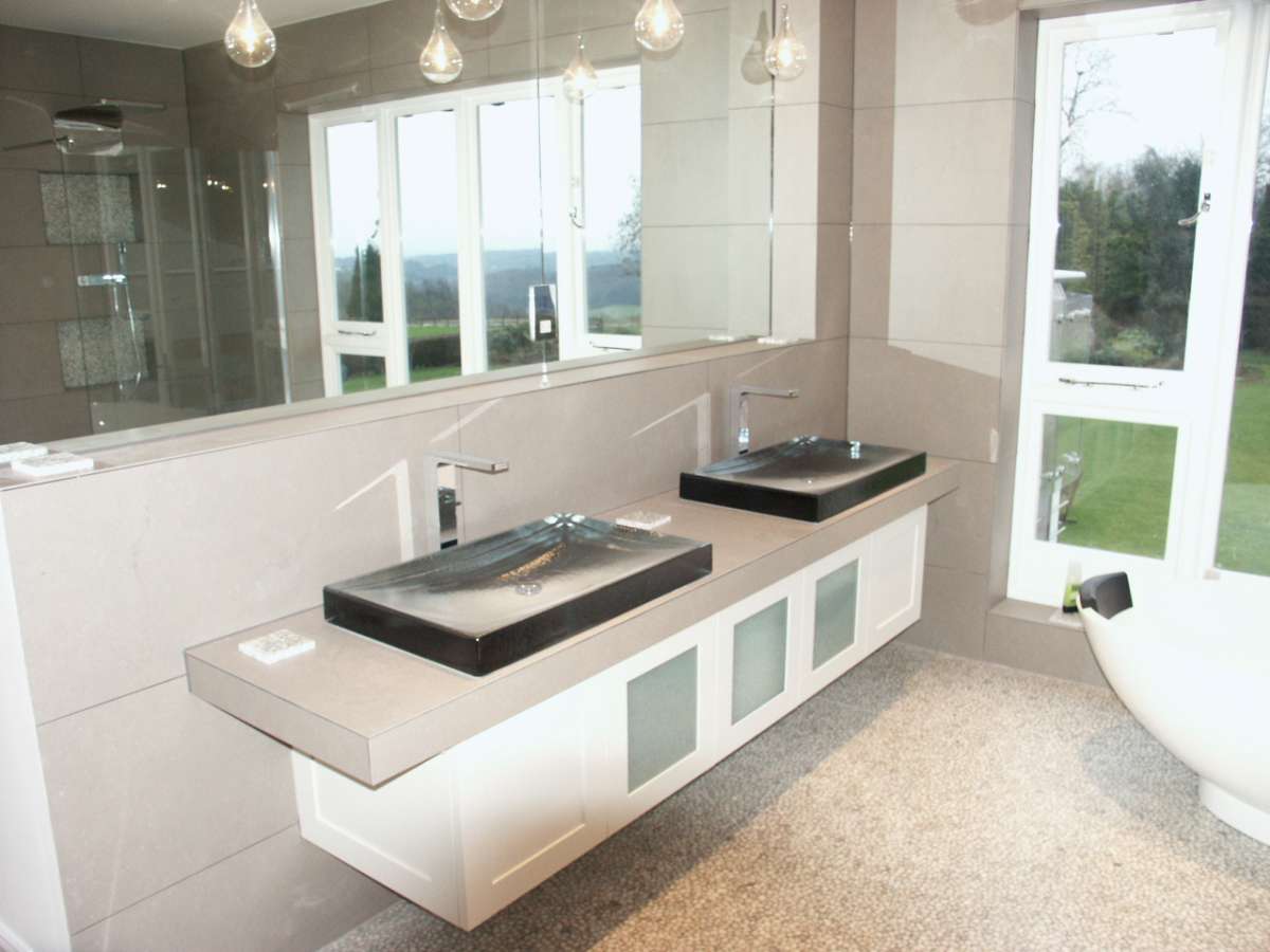

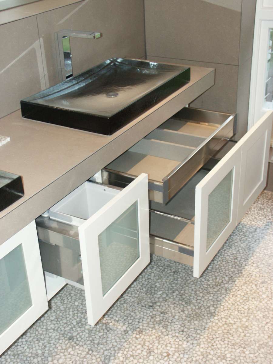

                                          Here is something supported by unistrut, soliid glass basins are 50kg each, ceramic top , metal draw runners and several sheets worth of board, glass fronts and overhang when open. 6 small screws hold it to the horizontal unistrut members and me and my glass guy stood on it to fit the mirrors so downwards loading needs minimal screwing. Though I did not use plugs and screws to hold the unistrut cantilever brackets to the wall behind. All to do with thinking about what loads here are and how they act.
