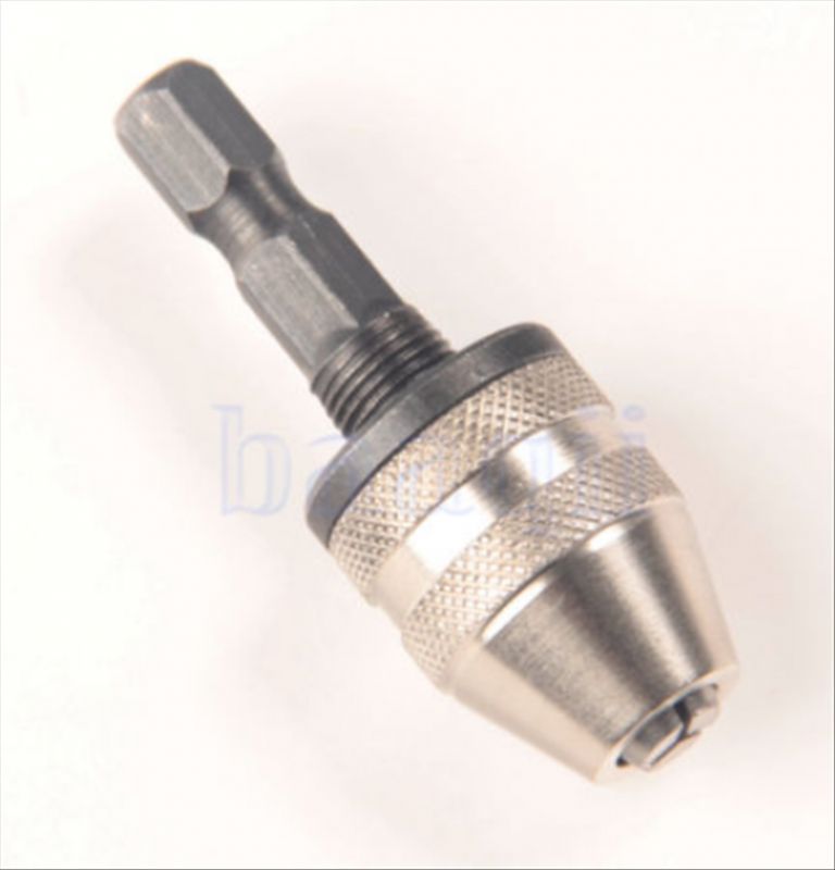

            Get a mini chuck that fits into your cordless drill chuck. Available from flea-bay, hardware stores.
