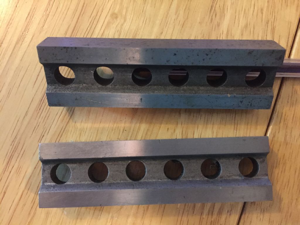

      I have this pair of parallels; if i wanted to get a longer set what sort of parallels am I searching for please?

          Big ones!
          Useful when setting up large parts for machining on a mill able or cross slide, really too big for stuff in a vice. Might also do as your straight bit of bar to clock your spindle

            Most probably home made by an apprentice

              They look like a custom made pair, in my Tool making days everyone made their own.

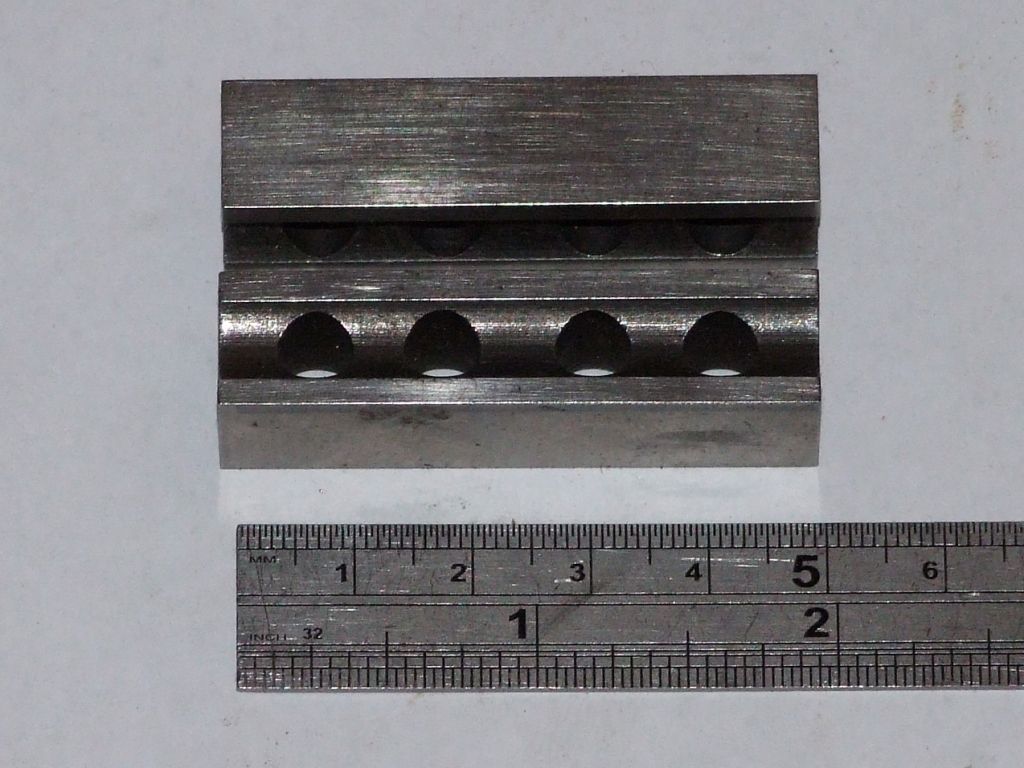

                They are a fraction over 3 1/2 inches long and both stamped G.K.B. on both ends. I think you may be right in saying they are an individuals custom made pair. I was hoping they were a standard item so O could get a longer one.
                JasonB: it was clocking the spindle I was thinking about. If I use a piece of studding through the spindle to hold it against the mandrel face I can have 3 inches out to one side which is more 'flat length to run a clock down than I would have got with a back plate. rotating it will also indicate any run out ???

                  It will only indicate "run out" (spindle misalignment) if it is perfectly flat and after you have used shims. If not it will indicate the sum of the misalignment plus the errors from it not being flat. My post wasn't perhaps the clearest.

                      I have a collection of parallels but they do no always meet the particular need / sizes I require. Only recently I bit the bullet and purchased a set from ARC:

                          Nige, most I have seen like that are more like 6" long, anything less will not be suitable for use as per the other thread

                            They are perfectly standard design parallels and were indeed sometimes made by apprentices but commercial ones are common. I have several sets of this design.
                            If you want "modern" parallels have a look at those offered by ARC Eurotrade. When deciding what type to buy consider your machine vice jaw height as one common use for parallels is to provide precision packing under work pieces held in a machine vice. I have no connection with Arc other than being a long standing and very satisfied customer.

                                              I have a range of 3" blocks, and a set of four 6" parallels, made by the same toolmaker as the ones shown above. I use them all the time in my machine vice. Then again my vice is possibly bigger than average. wink 2

                                                  The holes an recess are possibly there so you can bolt them to an angle plate,or down on a mill table as a fence

                                                    You cant have too many packers, The I beam type are particularly handy for packing work clamped directly on the table, The typical wooden boxed Asian sets are too thin and not very stable. I Also keep a selection of cylinders squares and other shapes.
