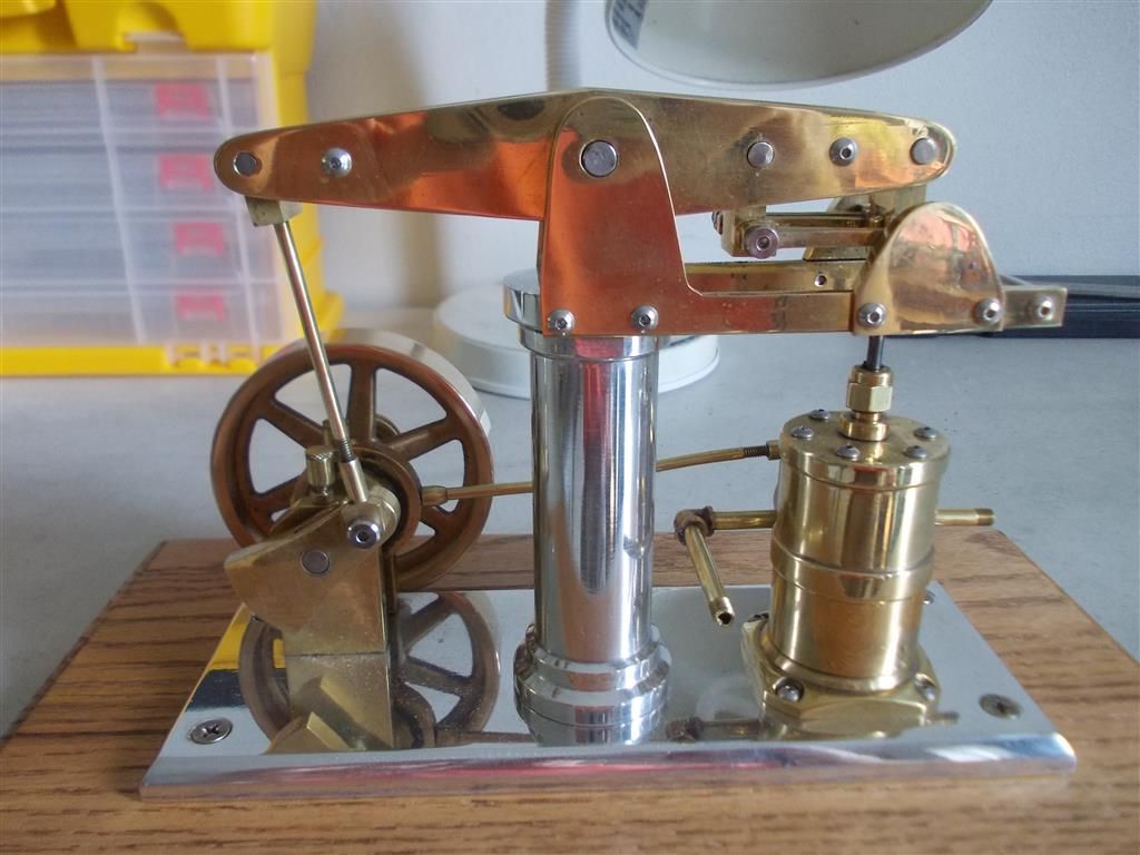

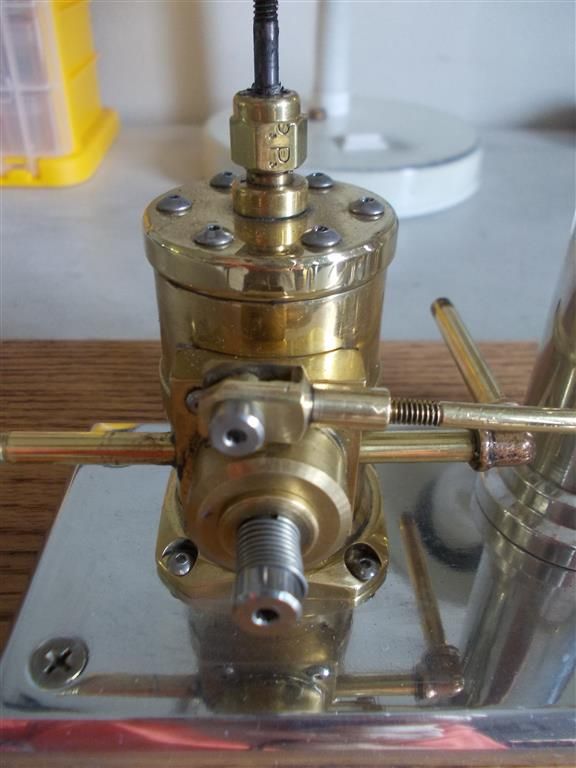

      I have purchased a Beam Engine off ebay. It runs very badly so I am going to take it apart to see what the problem is and I will paint it too (Brunswick green ?).
      1. I do not know what type of bolts these are. can anybody enlighten me ? I have tried both metric and imperial allen keys and nothing seems to fit properly. It was purchased from the United States so I would think it would be imperial.

          Look like stainless steel button head socket screws, like you I would assume an imperial hex. Is it the key that won't fir or the head that is getting mashed due to them being tight? Stainless screws are softer so the socket is more easily damaged and if a thread locker has been used they will be harder to turn.

            Bit difficult to see the heads – they look like they could be Pan Head Torx fasteners.

              If the screws have hex sockets (hard to see in the pictures) then probably you do not have the correct size Allen key. Most keys bought in sets, do not include the oddball sizes that only Americans seem to use.
              Where most people stick to imperial keys in 1/32" increments you will find 7/64" and 9/64" on USA manufactured kit.

                Given that is it a very small engine you may well find you need a 0.050" key which is the size for 2#2-56 UNC button heads. also worth adding 0.035" and 0.027" size sif you don't have them, often used on small grub screws

                      Appear to be Torx fasteners, clearer if you enlarge the photo’s, the top ones on the cylinder appear to be a bit mashed, probably from using a standard Hex key!

                          Look like hex to me, bottom of cylinder have not been mashed
                          And square on to the beam ones

                              I would prefer to get them out undamaged ie. I want to buy the correct tool for the job.
                              I think I may have to purchase these : 0.9mm,  1.3mm, 1.5mm, 2.0mm, 2.5mm, 3.0mm
                              **LINK**
                              **LINK**
                              **LINK**
                              Sorry about the photos but they are definitely hex heads. I thought the photos would be clearer than that.

                                Some appear to have an extra spline on what would be the ‘Flat’ part of the recess unless they’ve been mashed with a badly fitting key!

                                  I am sure that they are NOT Torx keys. I am sorry that the photos were not clearer.

                                              I have just been informed by the guy that sold it to me that the set screws are 2-56 and 6-32. The button head screws are 5-40. If I can get them out I might replace them with something more functional.

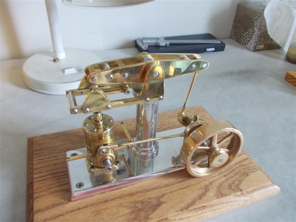

                                                Looking at the design I'd suspect two things above all – poor alignment of the piston rod and excessive pressure from that valve spring, It looks like its been done up so tight all the coils are pressed together so it isn't acting as a spring at all. A stronger spring that can move will be freer than a weak spring 'locked up'' like that.
