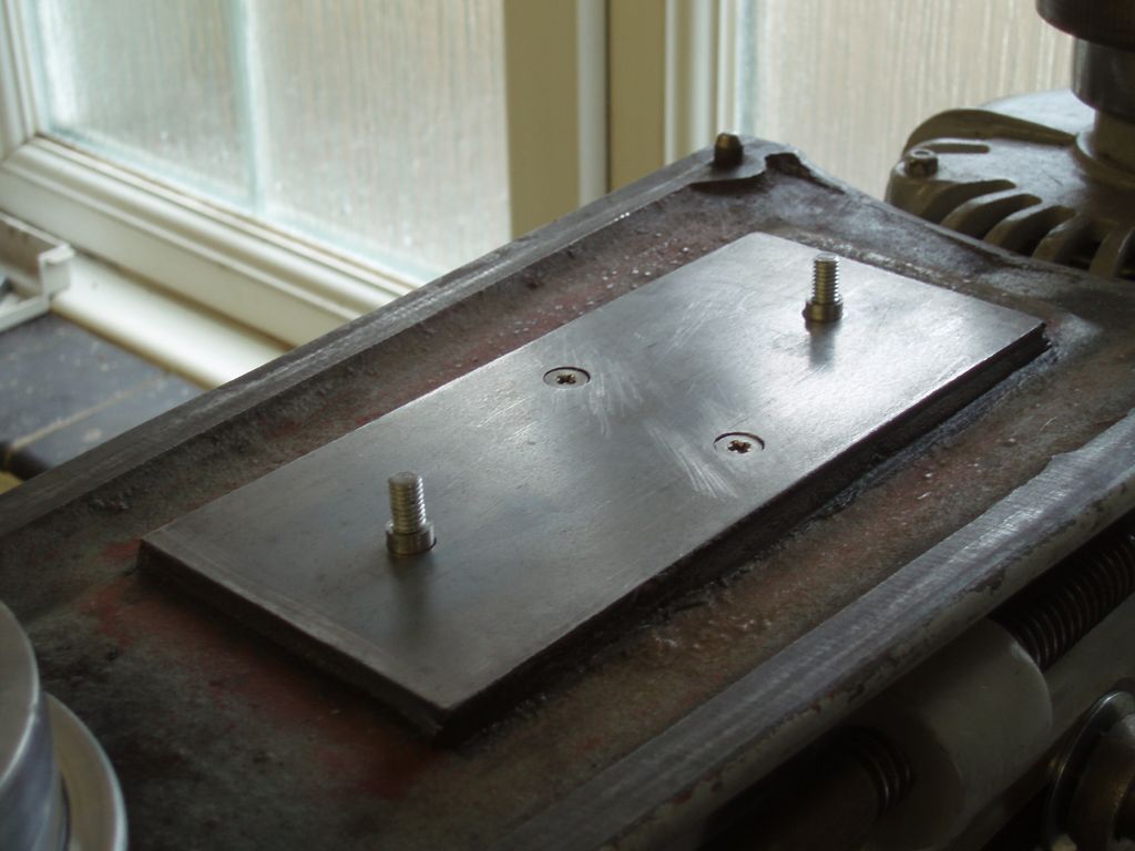

        I need to attach a piece of 3mm steel plate onto an uneven cast iron surface to form a 'sliding' surface.
        You will see from the photo that there is a raised machined circular surface in the centre of the area of interest. My plan is to lay the plate underside to this machined surface, with the surrounding (rough) area of plate bedded onto some kind of hard filler material for support. I had intended to use metal putty but the 5 minute hardening time and quite firm consistency has given me concerns; I don't think I could bed it to the flat 'reference' surface quickly enough, if at all.
        Can anyone out there suggest an alternative 'bedding' substance? Would car body filler be hard enough? Before anyone suggests it, machining flat is NOT an option

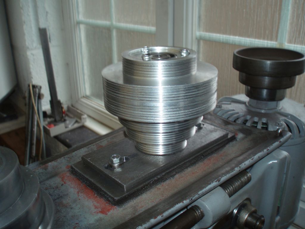

            Thanks Russell. The flat 'sliding' surface will carry a cluster of pulleys mounted on a rectangular plate, so the forces are fore-and-aft with the plate held near each end by studs/nuts (the photo shows the holes for these already drilled and tapped). The forces from each direction should more or less balance when belts are tensioned. I did consider at one time using epoxy resin with a filler of cast iron filings, pretty much a hard version of the resin + microballoons used for filling and contouring on model aircraft. Drilling and tapping would not achieve the support I am looking for in the gap between the plate and cast iron.
            Alan

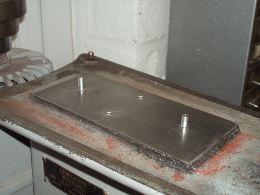

                                                  The test piece cured very hard with no slump. Squeezing in the bench vice to test compression resistance showed no discernible give at all, so I concluded that the epoxy + iron powder filler would be ideal.
                                                  The guidance on the powder packaging suggested that 100g filler to 100g epoxy is normal for a cast iron 'look' but that higher proportions of powder could be used , typically 4:1. I chose to add powder until I obtained a no-slump mix that could still be worked easily. After spreading the mix onto the cast iron surface, the plate was screwed down hard onto the machined area and the ends held down by nuts on the studs, using the pulley mounting plate to spread the load.
                                                  The result after curing can be seen below, together with the reason for doing it.
                                                  This has been a great success. Thanks to all who took the trouble to respond to my OP and to John for his valuable info.
                                                  Alan
