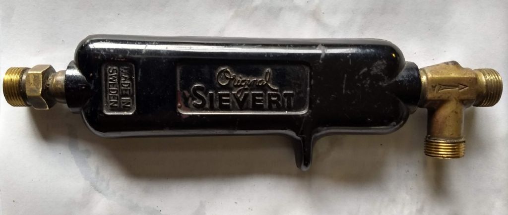

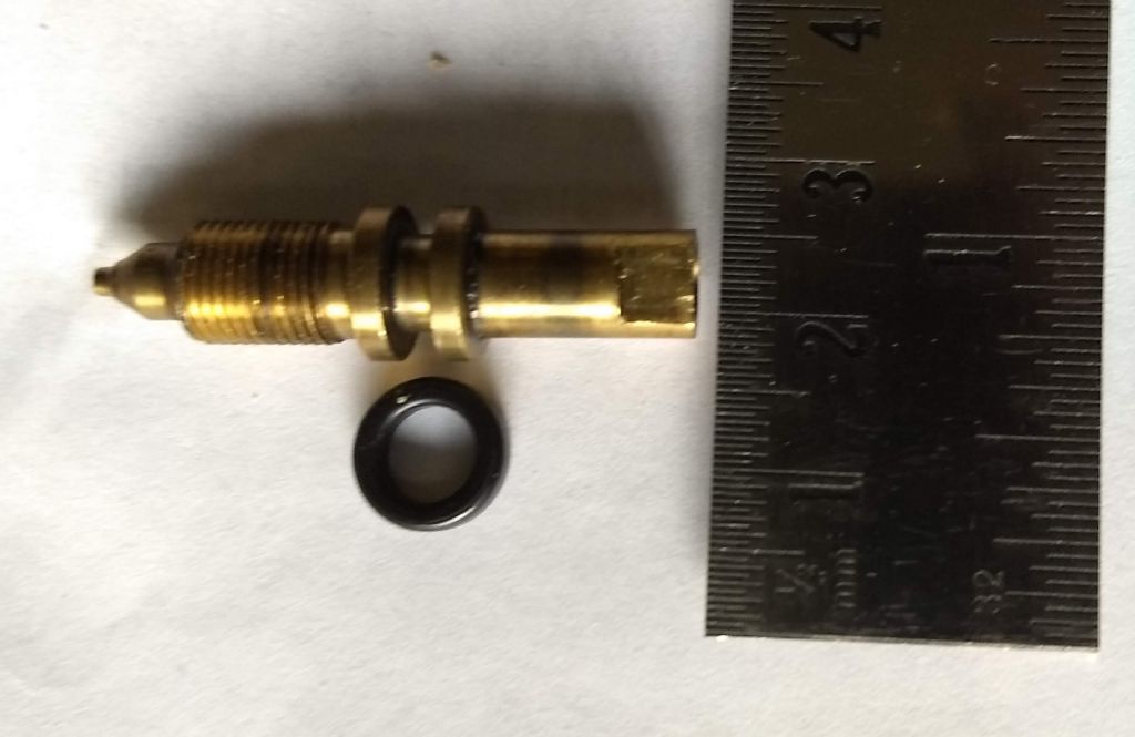

      My ancient Sievert blow torch gave me a fright today – it burst into flames as I was using it. I was able to blow them out and I wasn't burned, but it was rather scary. The flames originated around the valve, so I dismantled the handle and reckon I need a new o-ring. I've got a box of o-rings, but none of them fit.
      Does anybody know which one I need? The photos show the torch handle and valve with the o-ring separated. Sorry about the focus, I blame it on my phone.

          Looks like the 'gas' has swollen the O -Ring , whatever size you choose , do make sure it is compatible for
          use with the gas you are using.

            It seems to be a “square”-ring, not an “o”-ring.
            Why this shape is applied, I do not know.
            Does this ring constantly see gas, also when you do not use the equipment?

              It's actually rather difficult to see, but it looks like the ring only sees the gas when the valve is open.

                        As you have not given any dimensions of your O ring I estimate from your picture that it is about 6mm ID and about 2mm cross section.

                              It actually measures 6.2×2.5, do you suppose a 6×2 would do the job?

                                Hi Gary, looks like it is an imperial size of 1/4" x 3/32" and by the looks of the age of your torch is very likely. LPG will leak out of the smallest gaps it can find, so I would try and find one that is much closer to the one you want to replace.

                                          Nick's observations that my measured dimensions (6.2mm x 2.4mm) are very close to 1/4"x3/32" (6.35mmx2.38mm), and I couldn't find any metric sizes that were closer leads me to think they are Imperial. That's what I'm going for.

                                            I opted for the 1/4"x3/32" size (had to buy 5) but it turned out to be a mite too big – the valve actually went in, but was far too tight. I probable something closer to 1/4"x1/16" will be OK.

                                                Hi Gary, 1/16" is a fair bit smaller than the 2.5mm you mentioned, so maybe 5/64" might be closer, perhaps This one might be better. Something went wrong, try This one
