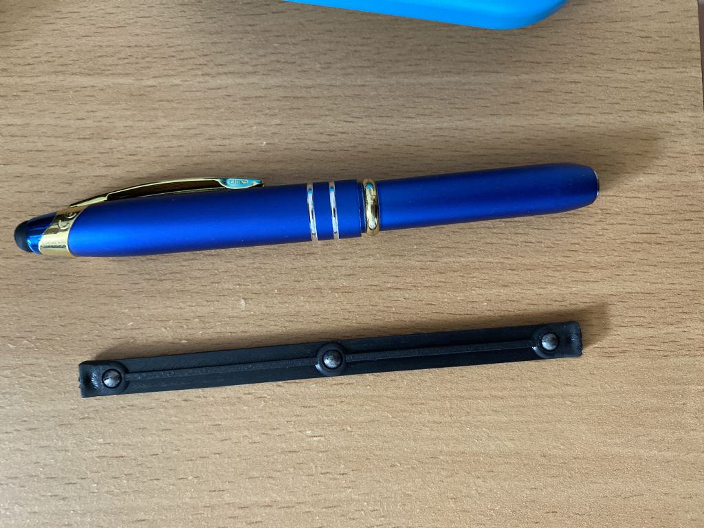

        Hi ive been trying to restore my tool chest and I am missing these two parts but dunno what is the name and where I could buy them thank you (the pen is for scale) Preview attachment image0.jpeg

              Hi I have uploaded the photo thank you.

                    Never seen the like before. Whereabout does it fit and what does it do?
                    #468693
                    Matthew Urry
                      @matthewurry
                      where the draw slides in and out there is two of these on top and bottom to then secure the shelving in place and move freely
                      #468694
                      Peter Hall
                        @peterhall61789
                        Bearings for a drawer slide maybe? Try getting in touch with Clarke. I believe they offer a spares service for some of their machines; maybe they could sort out your toolbox too.
                        Pete
                        #468695
                        mechman48
                          @mechman48
                          They look like small ball bearings in a plastic carrier; something to do with the drawer sliding mechanism, maybe a piece of one has come adrift?
                          George.
                          #468698
                          Matthew Urry
                            @matthewurry
                            thank you I just need two more haha tried searching for clarke parts but it only comes up with power tools spares.
                            #468699
                            Pete.
                              @pete-2
                              You won't find parts like that in their online shop, best option is to email their customer service, ask if they do parts for it, if they do, ask for a parts diagram, then it's a case of finding your part on the diagram, which should have a part number, then order the part number.

                                If no spares are available, could you make what you require?
                                Measure the diameter of the balls.
                                Possibly, once in place in the drawer runners, the plastic is only a spacer to, maintain separation of the balls, so maybe the balls to do not need to be completely captive. In which case, a suitably sized piece of plastic or metal with clearance holes for the balls could be used as a replacement? Fiddly to assemble, but better than nothing.
