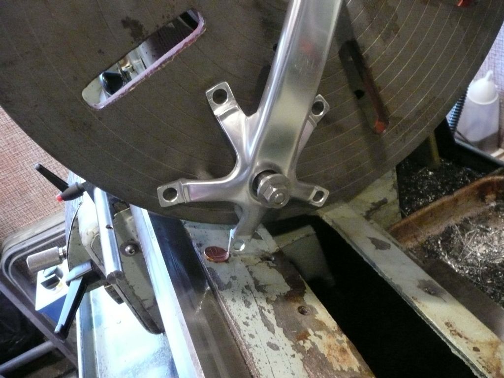

                              As a Willson user I am delighted to see this lathe receive some attention and interest on the forum.
                              My slant bed came with the safety catch plate mentioned and it was successively converted to a small faceplate and then to serve as a chuck backplate.
                              The standard faceplate came into its own when I wanted to shorten a pair of cycle cranks from the common 175mm length to 165mm:
                              The new eye is on centre for screwcutting and the far arm of the spider just clears the bed by dint of removing the sheet metal cover. This would have been impossible on the "straight bed" version of the lathe.

                                Awesome. All the advantages of a large gap bed lathe, without the gap weakening the bed. An idea brilliant in its simplicity, yet it never took off because it's different from the norm. Bit like any alternative to telescopic forks that has been offered to motorcyclists since the year dot. Any number of set ups are better, but tradition rules and buyers avoid anything that does not look "normal".
