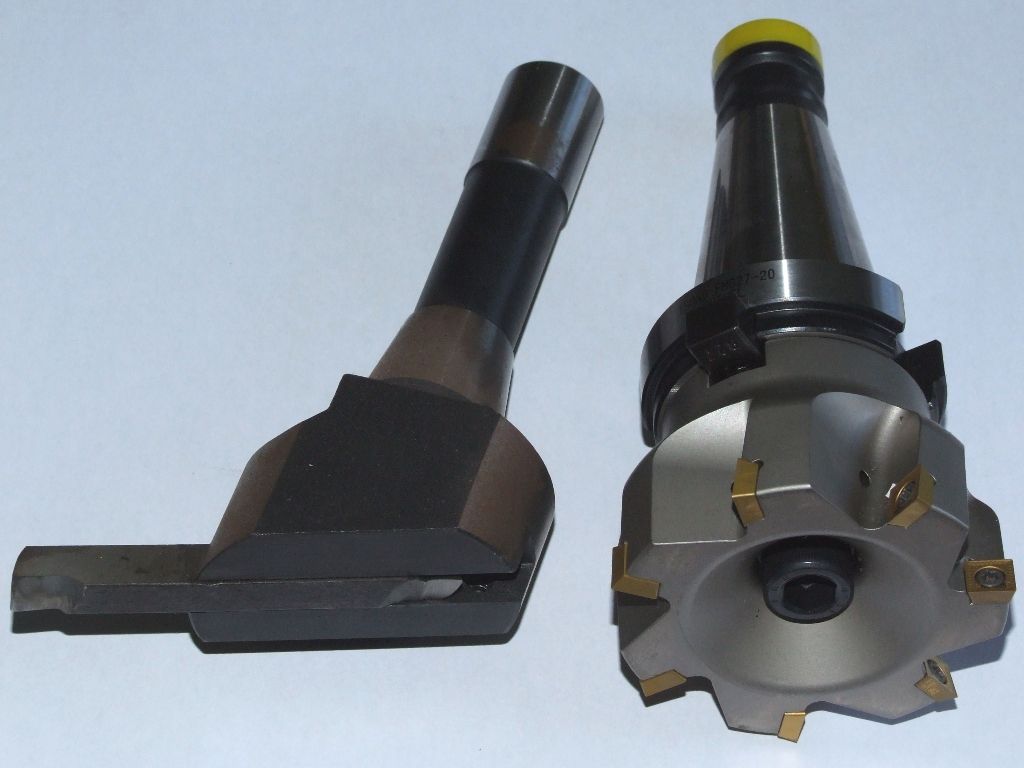

                      Anonymous
                        Posted by not done it yet on 26/06/2016 07:25:48:
                        The perfectionists who use a vertical mill will likely surface grind for a truly flat finish?!
                        Of course, what else would you do? wink 2
                        In this picture the flycutter is on the left, and on the right is a face mill:
                        Personally I don't like flycutters, and don't use them anymore. I rarely seem to get a good finish, especially when the vertical mill is properly trammed. They're slow, can only take shallow cuts and it is only too easy to forget the invisible spinning cutter and have an accident.
                        I use the facemill on the horizontal mill as my vertical mill doesn't have the rigidity, or horsepower, to make use of it. As it happens the facemill cost twice what my horizontal mill cost, excluding delivery.
