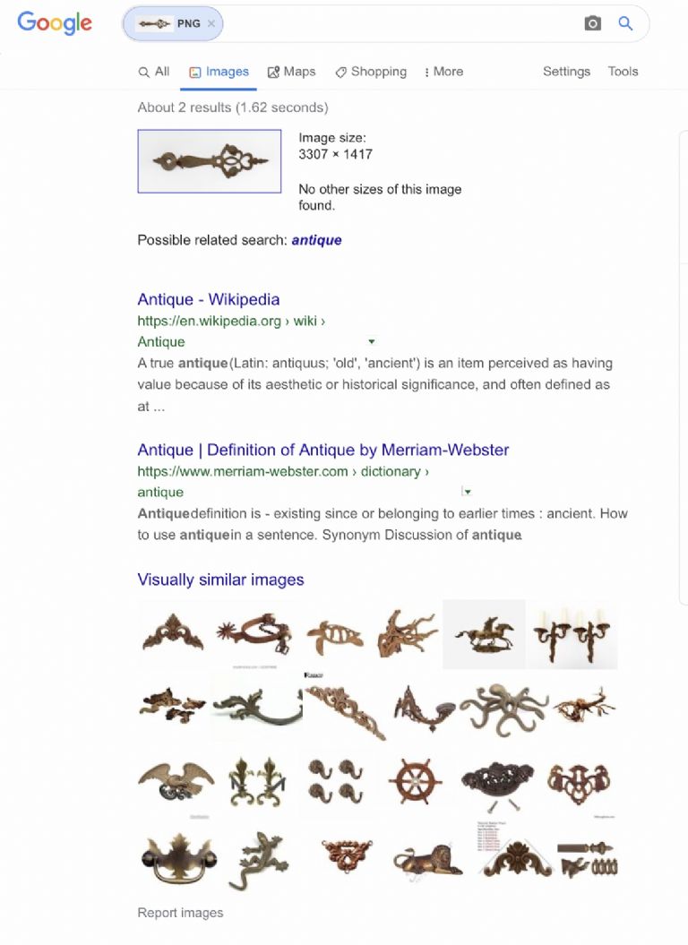

                                    Well … it didn’t do much for me in a recently dont know
                                    I was looking for examples similar to a particular Hour Hand from a longcase clock; so I did a good clean scan of it, and uploaded that to Google Image Search.
                                    This was what it returned:
                                    So can someone please tell me what image search engine they use on CSI question

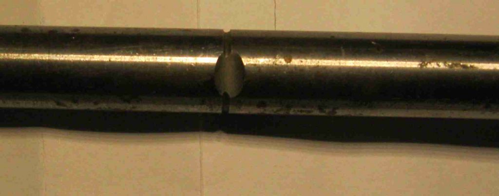

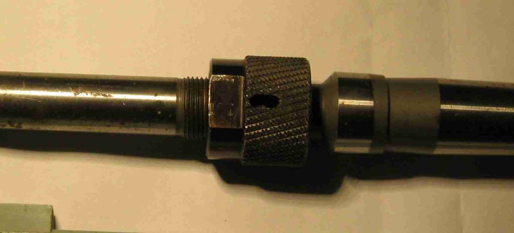

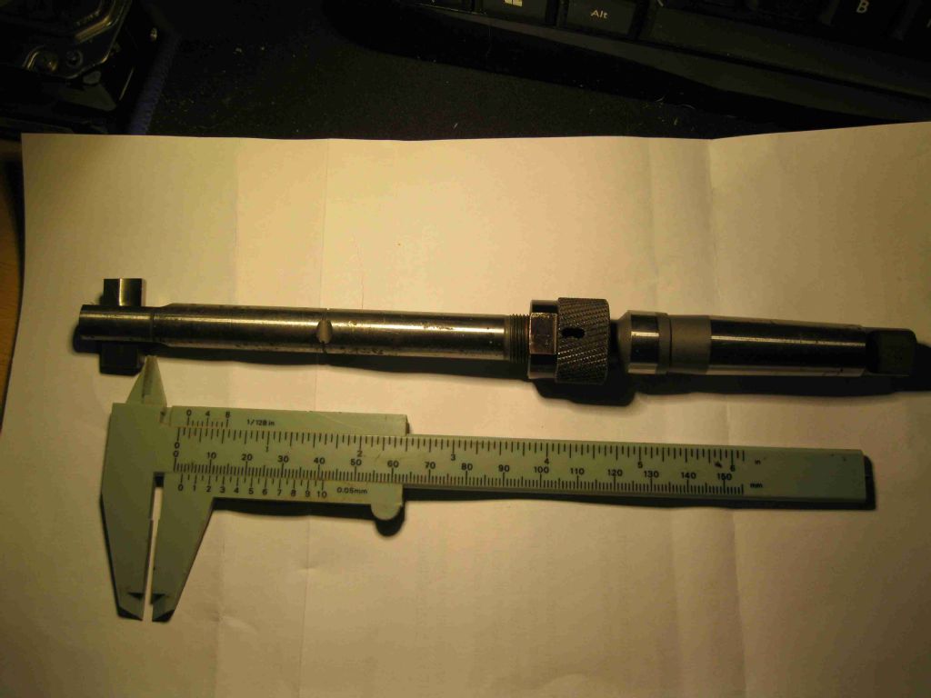

                                      Been trying to find info on the following 'milling cutter' (??) , without success. The cutter bit is held in position by a central plunger tighhtened by the knurled portion. It will only fit to cut TOWARDS the taper mount. There is a slot in the knurled portion to allow a pin to be drifted out to split the shaft. The taper is friction fit only, so cannot provide cutting pressure for the blade. there is a hole at the cutter end but not suitable for a centre. Approximately halfway between the knurled portion and the cutter there is a groove which is fitted with a spring ring. All in all, a total mystery! suggestions would be very welcome!!
                                      rgds
                                      Bill

                                        Bill That is a proper 'counter-bore' used for making a spot face or recess on the far end of a hole on a casting that has been drilled through, perhaps on a boring machine, to avoid the trouble of remounting the workpiece to get at the outer side. So you put it through the hole without the cutters in place, add the cutter and away you go. The taper should have a drawbar to hold it in or the main arbor a centre to position it with a tailstock.

                                          Thank you Bazyle – that's what I assumed originally … except that there is NO drawbar! Also, the lack of a 'proper' centre hole at the tool end means it can't apply pressure from there. It is a fairly complex item to manufacture with the internal rod securing the cutter using the knurled portion. All very puzzling!
                                          rgds
                                          Bill
