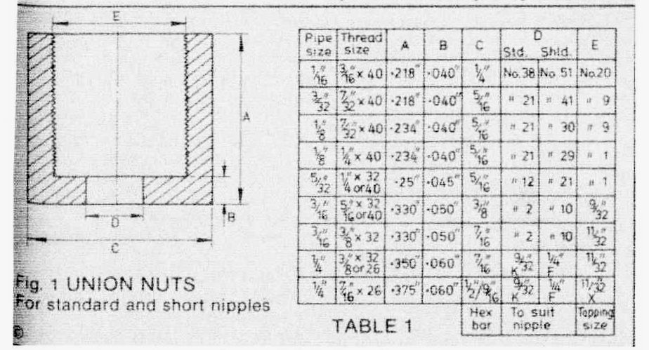

      Hi everyone,
      Is there a Table published anywhere showing what size across flats hexagon bar is needed to make copper pipe fittings.
      I have just measured what few I have but they seem all over the place. The ones I have are brass but I want to make some bronze ones.
      I'm in the range of say 1/8" up to 1/2" pipe. (+/-)
      Many thanks for any guidance,

        michael howarth 1
          @michaelhowarth1
          This chart may be of some use to you although the quality is not good and it only goes up to 1/4"img.jpg

            Hello Mick and many thanks for the chart.
            I can read it OK and at least it’s a start.

                For general convenience, I have darkened the chart that was kindly provided by mick H

                    Pipe fittings (BSP ) use Whitworth form threads, and so normally use Whitworth sizes hexagons, rather than "normal" A/F sizes.
