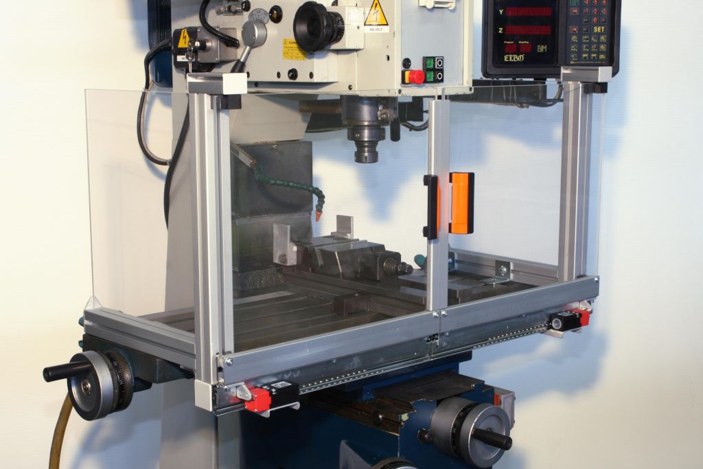

        As i have been doing a fair bit of steel machining, especially with my 4 bit facing tool, i was wondering what you used to stop the small steels chips going all over the workshop?

          You could go the whole hog and build a screen like this.
          Or perhaps just use the shop-vac strategically placed.
          For a slightly simpler type of screen, have a look at the one I did for my WM14 *** Mill Screen ***

            My set up is not as sophisticated as John's, just some temporary sheet metal guards and a broom.

              Magnetic base with a bit of sheetmetal such as an old biscuit tin lid attached can be handy. Move it around to where it is needed most.

                      Mag base with some rigid plastic sheet with a small overhang at the top gives flexibility. I just aim to keep the chips away from the operator's direction to reduce the area to be cleaned up.

                        +1 for Andrews broom with considerable assistance from an industrial version of Henry.
                        The mister provides a low power air blow when needed to keep the chips out of the cut and, occasionally, oil when needed. I do make an effort to keep chips brushed off they work and onto the table during the job, pausing as appropriate. Frequent wielding of the vacuum cleaner to pick chips off the table helps a lot.
                        I have got an industrial "flexible" shielding system that magnetically mounts to the Bridgeport table but pretty much never use it as it gets in the way so much during set up. Table mount systems may make sense when doing repetition work so no set-up needed after getting things right on the first two or three. But thats not what we do.
                        The only shield totally worth having is something effective at the back of the machine so chips don't disappear behind.
                        Bench mill users might do well with fold out wings connected to the back shield to keep chips on the bench close to the machine. Two or three folds probably best so they don't close off useful fast space when the machine isn't being used.

                          Vacuum for me on the manual mill combined with trying to feed in a direction that sees the swarf going behind the machine, the insert facemills are as you say the most likely to throw stuff about.
                          The CNC has a "Trough" around the table that does a good job catching 99.9% of the swarf from standard cutters and is not too restrictive though you don't need to get at or see the work so much on that

                                Vac up after machining I did try the shield that came with the machine but it just gets in the way I found that after hitting it on a long cut in the x axis. I must make a couple of boards to cover the slots which would aid easier clean up

                                  Greetings Warco used to sell a simple perspex shield, with a magnetic base and a flexible stand that works well for me. Not sure if they are still available.
