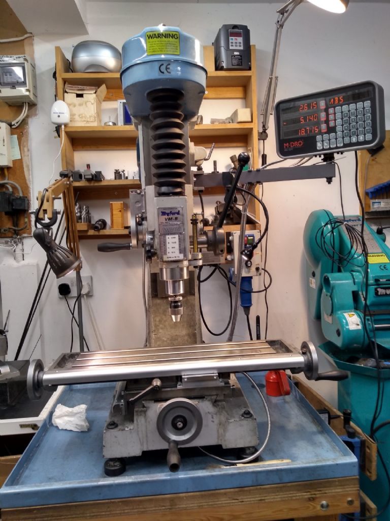

        Finished fitting a 3-axis DRO to my VMB mill, one of the kits from M-DRO using magnetic scales.
        Fitting was reasonably straightforward but tedious – more pics in my DRO album. Main issue was with the Z scale which I mounted on the side of the column as there wasn't enough space on the head. The column side was reasonably flat and vertical bit I had to shim the scale to get it straight and parallel to the head movement. Reader bolted using one of the supplied brackets on the machined side of the head. That was the only bracket that was useful.
        For the Y axis I bolted a piece of 1/4" flat plate to the carriage to hold the scale and mounted the reader to the base which surprisingly was flat and parallel to the table.
        The X axis is bolted on the front of the table with the reader on a block machined to just the right height and bolted to the Tee slot at the front of the carriage. By the time I was making this block I had two working axes and they were already proving their worth.
        The console arm swivel base is bolted to the RHS of the column. Once I started drilling holes in the machine I got quite blase about it! In my picture of that you can also just see the surgery I had to do to the belt guard to fit a 3-phase motor and change the pulley arrangement to something more sanitary.
        So far I've only done a few quick checks but the system seems as accurate or more accurate than the leadscrews/handwheels.
        I've fitted the swarf guards to the X and Y scales but the Z scale is reasonably out of harms way and I hope won't need it – getting round the back of the machine to do up the screws would be a right pain!

            Re DRO fitting, one issue is that the top of the cover on the X scale is slightly above the plane of the table which means that I can't bolt down a vice etc that would otherwise overlap the front. The table thickness was only just enough to fit the scale channel. As it was I had to file a chamfer all along the bottom edge to stop the channel touching the base and acting as a table lock! I don't want to run the machine without the scale cover on the front because lots of swarf escapes forward. Especially with ferrous material I can foresee iron filings attaching themselves to the scale! So I'll need to mill a step on the couple of vices I have that are affected.

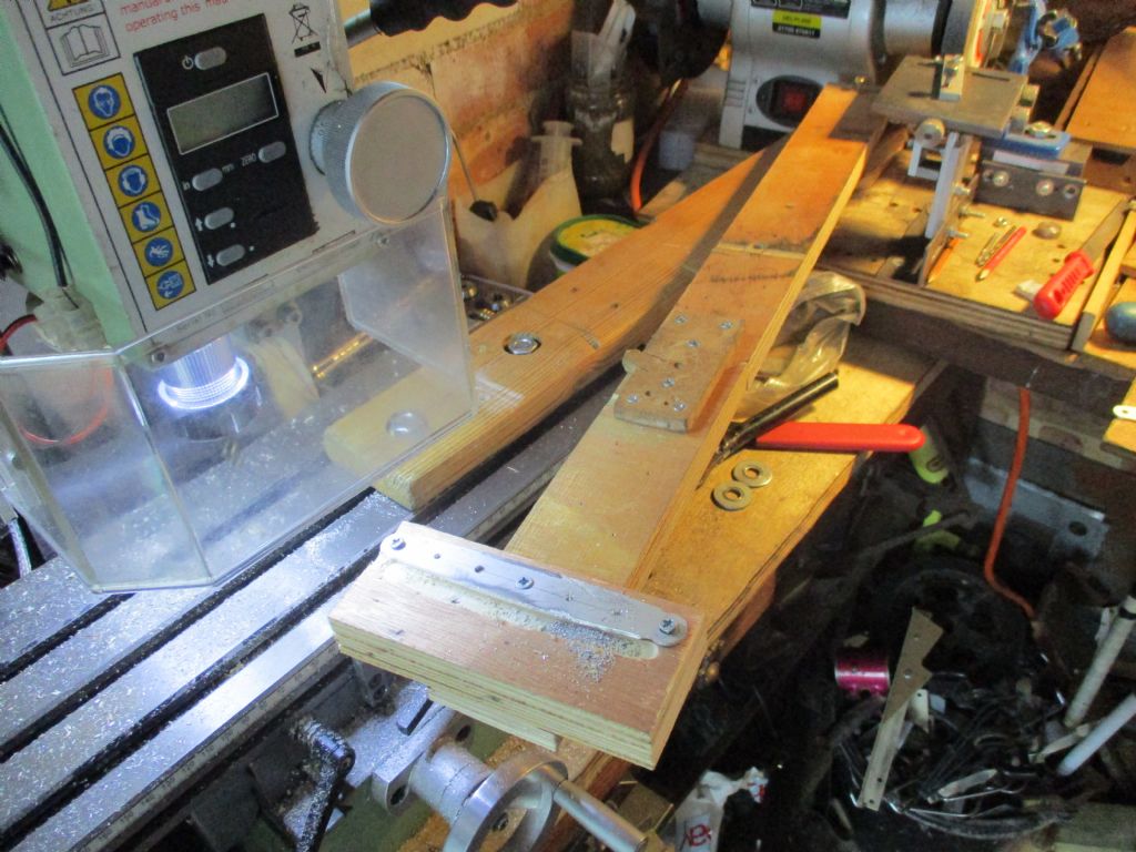

                Having taken advantage of the 6 for a £1 offer for Model Engineer I was looking at the on line digital copies and was taken by the Oliver Evans' Half -Beam Engine from Dec 2001 on.
                I decided to start with the beam which is somewhat complicated the main structure starts with 2mm thick material which I managed to cut from an extruded of material which seems like dural.
                The beam has an arc both top and bottom which although the plan doesn't describe the radius I reckoned it to be about 635mm.
                The attached photo shows the length I had to go too to get this on my Warco 14.
                Has anyone else made. This model as portrayed in the articles?

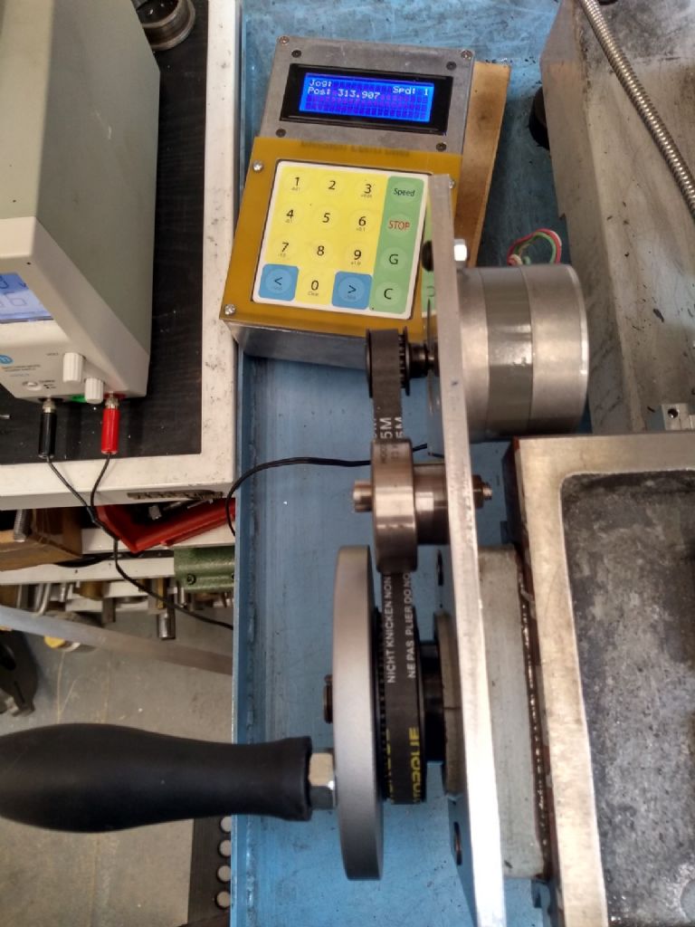

                  Finished off my Division Master Rotary Table Controller installation. I had finished the electronics a week or so ago and tested it all on the bench. The Oldham coupling arrived a couple of days ago so I could carry on with the stepper mount. It all went relatively well. When you look at the photos please ignore the ding in the mounting on the rotary table. (tube with bracket on decided they would rather not stay fixed in the 3 jaw chuck. Grrr.
                  The electronics are the Steve Ward controller which I purchased as a ready made tested circuit board and with his ready made tested keyboard. I took a lot of care with the hole layout for the buttons. I made a mock up front panel from MDF and cut all the holes in it to ensure the layout was spot on.
                  The stepper motor end cover was one I found on Thingiverse, but this particular one was created using OpenSCAD and so could easily be amended size wise. I was able to increase the size at the back for the XLR connector.
                  I opted for a long armoured flexy cable and power is courtesy of a spare Toshiba laptop PSU.
                  It all ran very well.
                  Colin

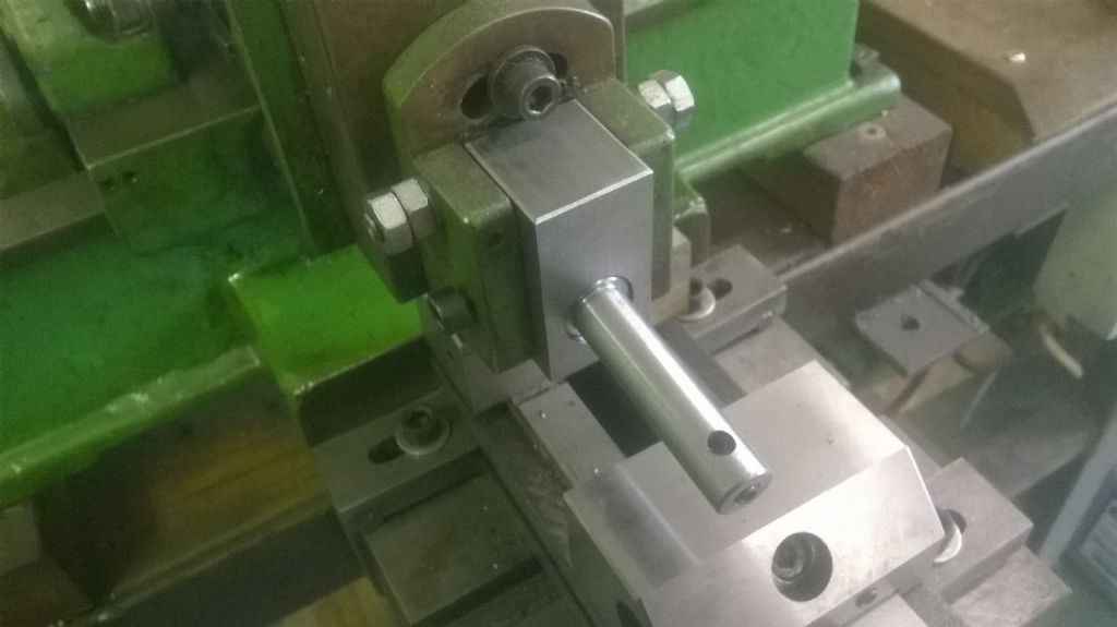

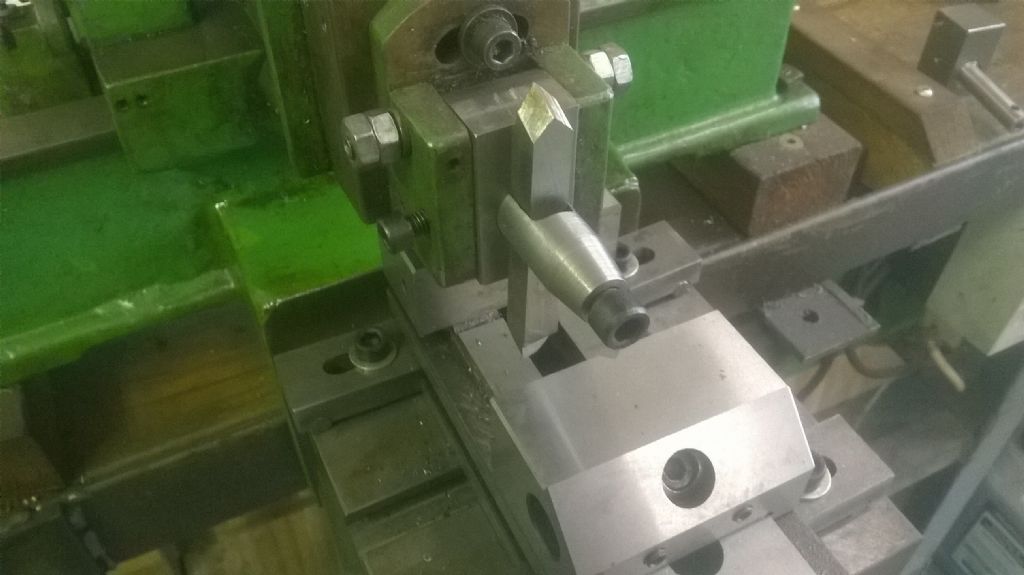

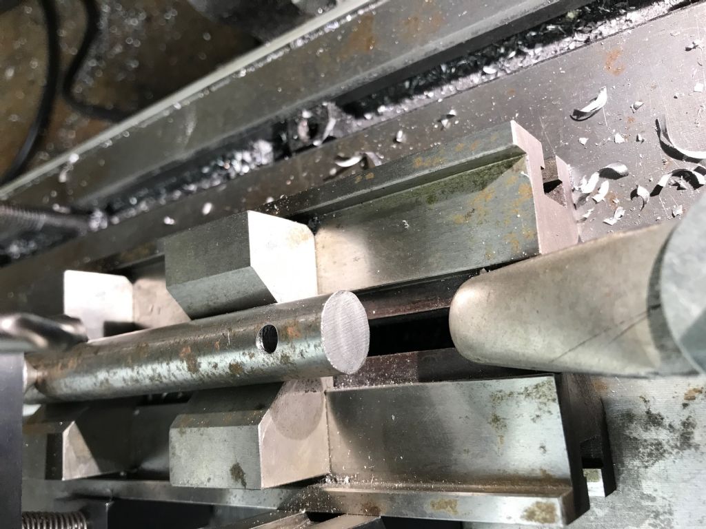

                    Hi, I had a fiddley job of cutting 2mm off the end of two S/S flange bolts, which are not easy to hold, let alone cut.
                    So, I did it like this.
                    Made the job easy peasy.
                    Regards Nick.

                      Colin, did you print the graphics on the switches or buy them somewhere ?

                        Neat way of doing it, Nick. Thank you for the tip.

                          Emgee,
                          Steve Ward provides a .png file of the layout luckily I have two colour printers, an A3 and A4 the scale was fractionally wrong on one of them the scaling and layouts and colours can be changed used software called getpaint
                          He also provides a template for the hole layout. I used this as a guide and measured all the button and mounting hole spacings and created a spreadsheet with the coordinates for my DRO. Did a trial run on piece of MDF before attacking the box lid. I have copy of spreadsheet if any use to you.
                          colin

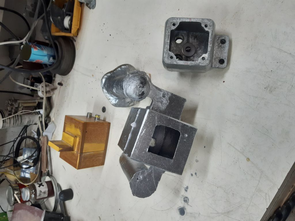

                              Cast a new box for the forward/off/reverse switch on the mill. The latest switch (after the one I got to replace the orignal burned out!) is quite a bit bigger than the original.
                              Need to work on my sand ramming technique against the sides of the pattern, but for this one the messy surfaces will get skimmed clean on the mill. Very happy with the finish on the inside of the box from the core.

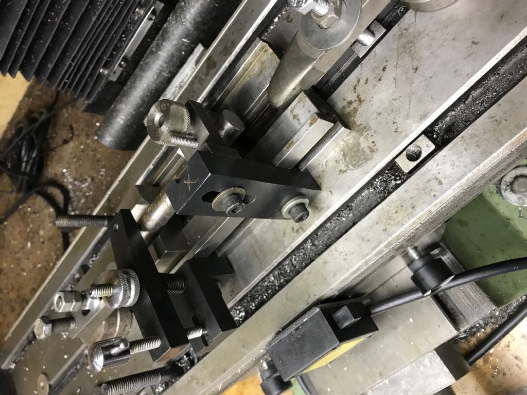

                                Finally had need to use my drilling clamp jig, nothing too complicated or difficult by the standard of others but none the less Pleased to have used the jig and happy with the result, just not sure how to rotate the photo's

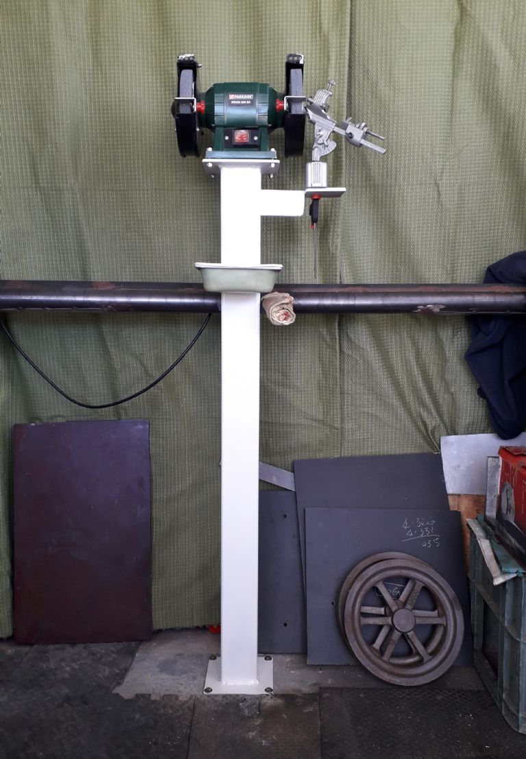

                                  Knocked this grinder stand up from a bit of scrap 80 x 80 box, a couple of 150mm square end plates and some odds out of the scrap bin. Couple of coats of paint Monday and yesterday, bolted it down today and part filled the upright with dry sand, a trick I learnt from making some high end speakers, to stabalise everything.
                                  The arm sticking out to the right is to support a Picador drill grinder, there is a tray for water just under the grinder.

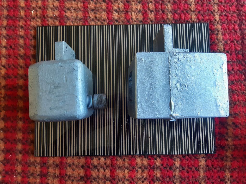

                                      Funny bracket on a classic vehicle for a bloke down the railway. He made an alli sand casting of the original and wanted me to drill the angled hole.
                                      He lent me an original to set up on, so I stuck it in the vice on the swivel vertical slide, then fiddled till I could get an 8mm drill through the 'ole without touching. Turned out to be about 53 degrees, but I dunno exactly 'cos the angle calibration on the swivel stops at 50. There's an added complication in that the hole's tapered, so I eyed-up the big-end clearance around the drill as equal all round as near as I could see – should be within a few thou. There were just 2 to do, and the castings were very slightly different, so there was little point in trying for a fully-repeatable setup.
                                      Whether the hole taper needs to be replicated, and if so how, is gonna hafta be another story. I certainly can't see a ready way to bore a tapered hole that small, in a thing looking like that, in my setup. If somebody down the railway's got a suitable tapered reamer somewhere, that'd be neat.
                                      Oh, social distancing of course. He dropped a polybag with the bits into my carrier, and I washed everything, plus my hands, in detergent water as soon as I got home.
                                      smiley

                                        Hi Mick B1, that's a neat and simple way of doing it.
                                        Regards Nick.
                                        #470330
                                        Mick B1
                                          @mickb1
                                          Posted by Nicholas Farr on 09/05/2020 11:10:28:
                                          Regards Nick.
                                          Ta. I'd thought I'd have to do it with trig. Sometimes it takes me a while to think of the simple way… smiley
                                          #470337
                                          Brian H
                                            @brianh50089
                                            Looks like a bonnet catch housing for a pre-war car, if so the taper may be to stop rattles when driving, in which case there may be a matching taper on the actual catch.

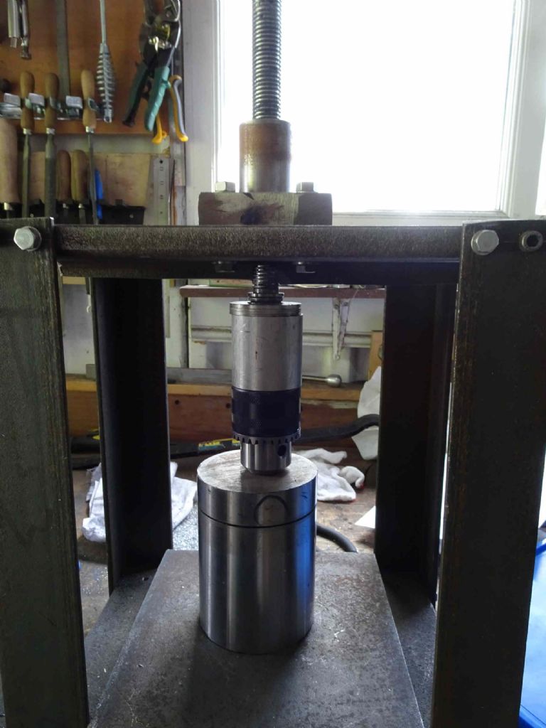

                                                  Some of you may have noticed me moaning about the drill chuck that came with my milling machine. I've been hathering about what to do, but today I decided to follow some instructions on the internet and disassemble it to see if there is grit or similar.
                                                  First I turned a pusher with a 39mm inside diameter (using new uncoated aluminium carbide. still trying to work out the best way of using them).
                                                  In fact I needed to clamp the press to the bench. it was very tight.
                                                  Sadly, the outcome was not what I expected
                                                  What the internet says is that this cover pushes off to reveal the cracked ring. Hmm – we wary of the Internet!
                                                  I expect that cheap Chinese chucks just aren't made the way that real Jacobs chucks are.
                                                  A replacement is on the way!
                                                  Iain

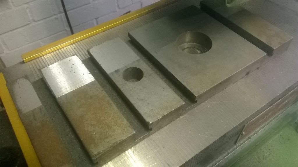

                                                    Also made two new tool holders for my Perfecto shaper. First one is a lantern-style one, so that I can use 10mm square tooling as well as the Imperial sized tooling it had when I bought it.
                                                    lantern-type toolholder
                                                    While as I was at it, I knocked up a keyway slotting tool holder à la Stefan Gotteswinter:
                                                    The tool is fitted in a hole which is angled downwards by 5° for clearance. The tool holder block is held secure by utilising hole which a former owner had drilled and tapping it 6mm to take the socket head bolt seen on the left-hand side of the clapper box, The bolt was dog-pointed to engage in a matching hole in the tool holder.

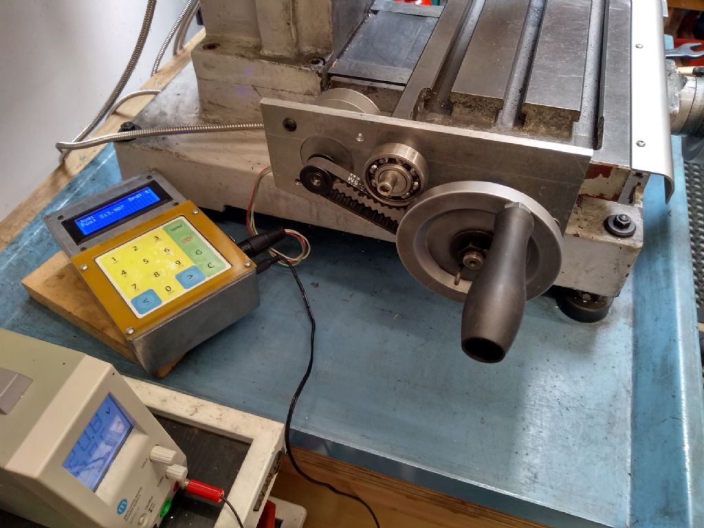

                                                      Nearly finished the mechanics of the power feed for my VMB. Couple of pics:
                                                      An alloy plate bolted on to the LH feedscrew bracket carrying an Astrosyn size 23 stepper that's been in my spares box for years and years. 3:1 drive to a timing pulley on the leadscrew – I turned down the central boss to 24mm and bored out the pulley to suit. Drive is transferred by a pin through the handwheel into the pulley. An old 40 od ballrace glued on to a post with an eccentric hole bolted through to the plate to adjust belt tension. For test purposes driven by my Ward divider controller, works very well. Just needs a strip along the top edge of the plate to stop chips flying into the belt.
