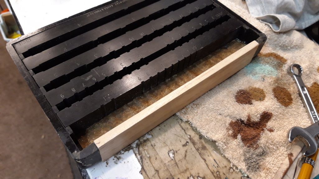

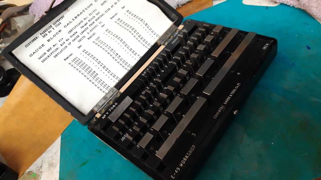

                              Today I've mostly been repairing a box, because I finally treated myself to a gauge block set last Friday at the Model Engineering Show, it's a Coventry Matrix good quality 50 piece set but the bakelite box was broken at the hinge side, so it needed repairing!
                              The set has a RR sticker on it so it must be good! Calibration valid until 1996 so it's just out of date! Weirdly the top of the box is made of wood so it must have been repaired before.
                              Clamped in the vice showing the damage to hinge side. Contemplating hack-sawing the damaged bit off.
                              Decided to mill the damaged bit off. Impressive bit of clamping don't you think?
                              New piece of hard wood inserted and glued into place, then milled down to size, and hinge pockets were also milled in.
                              Lid fitted and lettering re-whitened, bit of polish and the jobs a good 'un!
                              Very pleased with the gauge block set, most pieces will wring together apart from the larger sizes, so it has seen a lot of use, but checking the pieces with my digital micrometer down to five decimal places, it is still extremely accurate, certainly good enough for my use.

                                Job is a very good 'un Ian. Well done. There something very satisfying about a sensitive refurbishment like that.
                                I remember my dad had a set, for some reason he called them "joe" blocks. No idea why?

                                    That looks like a good repair.
                                    However, I hope that piece of hard wood isn't oak. If it is, I'd advise a coat of varnish, pdq!

                                      Hi, if it is Oak, don't use steel screws in it, as they will rust. Brass is the ideal screw for Oak.

                                            Yes it was a satisfying quick repair to a set which will out live me, hopefully to be passed on to someone else in the future. I'll leave the bare wood as it is, as a proud in your face repair! It's 'Heveawood' or Banana wood (from a chopping board) the same stuff as I made my base for my ongoing Stothert & Pitt Beam engine project.
                                            I've mostly called them slip gauges when I was on the tools, but Jo blocks are a common name too especially in America where I think Ford bought the company. And for thirty quid I thought it was a reasonable price for a quality piece of kit.

                                                Knowing the black marks on our kitchen wooden work top, not oak, and experience with acidic wood I would seal it ASP. Those small bits of precise steel need looking after.

                                                  Thanks guys I didn't realise that a piece of wood could be so dangerous! So I dyed it with a brown stain and black ink jet ink on top, invisible (ish) mending at its best!
