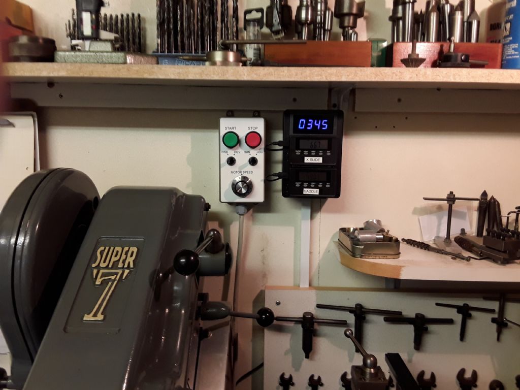

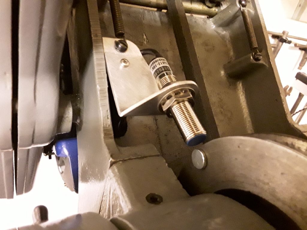

                  Finished fitting a tachometer to my Super7.
                  Interestingly the instructions state that the sensor will operate up to 10mm away from the magnet but in my case I had to close the gap to around 2 to 3mm before it would work.
                  Then mounted the display into an ABS project box which I'm also utilizing to mount the displays for my poor man's dros. To initially test the system I simply powered it with a 9volt battery (PP3) but I realise that the battery life would be a bit of a limitation so rummaged around in various places and found an old 12volt wall mounted power unit which is what is powering it in the photo. I did briefly consider powering the dro displays in a similar way but so far these have working for nearly three years on the original set of coin cells so I don't think I'll bother. I'm sure some of the purists on this site will wonder why I bothered but with a VFD driving the lathe motor it is difficult to to assess what the spindle speed is and anyway for around £8 it turned into an interesting project for a few afternoons.
                  Phil

                    Phil, Do you know if the tacho also provides an output pulse that can be used by something else? Perhaps the sensitivity was specified for a magnet flat on and would improve with the sensor facing the magnet, not that it matters now it is working.

                            I second the magnet orientation reducing the operating distance but as Bazyle says it working, so just leave it alone.
                            As installed the magnet is presenting the N & S poles equally to the sensor face so possibly have a cancelling out effect. There are lots of different sensor types and some which have an internal magnet might be upset with a moving magnet.
                            Ian P

                                Bazyle, there is an unused lead on the display but whether this is an input or output I have no idea, the Chinese data sheet that came with it tells me little except to confuse!! Also you are correct about the magnet, I have since tried the sensor at a right angle to the way it is shown in my photo and the sensitivity does in fact exceed the 10mm specified but as you say it hardly matters now as it is working.
