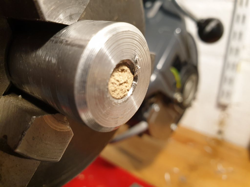

      And after a long, some would say eventful, "Career" in the oilfield, I have many cusswords, in quite a few languages . .

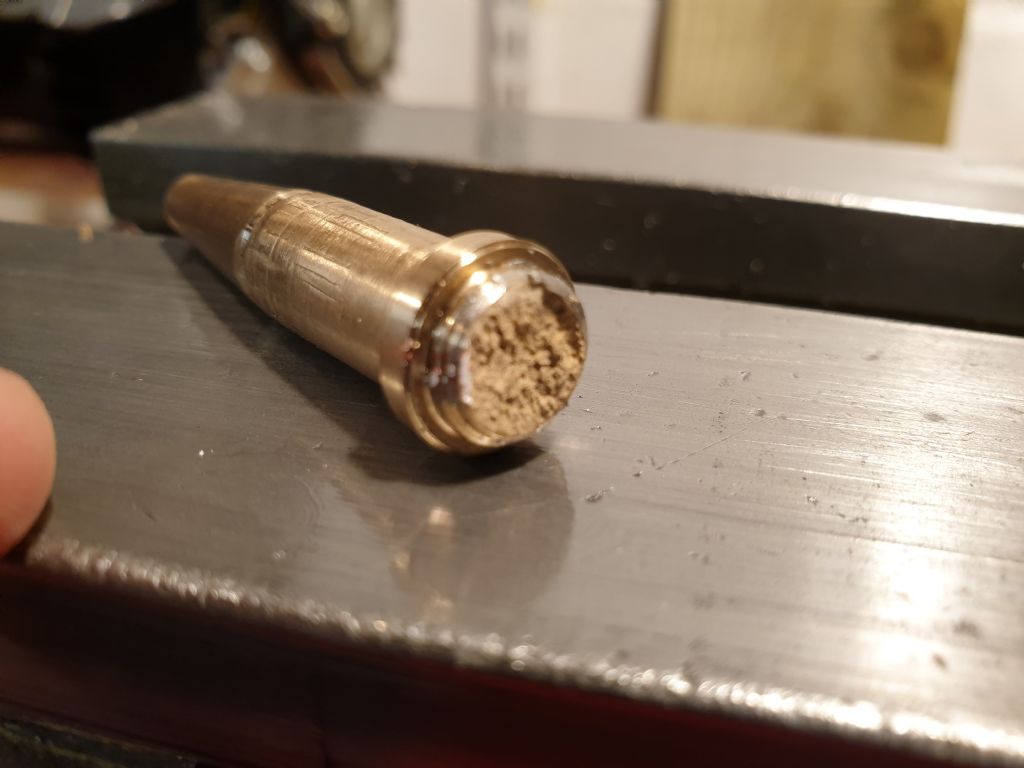

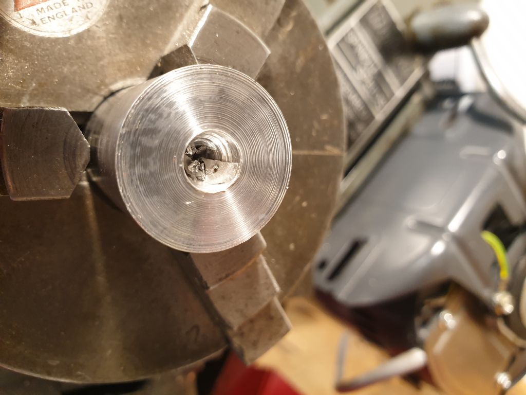

      20190528_143402.jpgDecided, (usually a mistake) in order to make "Sprag pins" Bronze load carrying pins.
      it would be best to make the threaded ends, then hold the pins by the thread to make the taper on the pins.
      (having tried to do the taper then tap the threaded end and had limited success )
      So, drill and tap some aluminium bar as a holder.
      cue "New and shiny" centre drills (from our favourite far east supplier, the one with a "bang&quot
      jeezo, both ends broke. the one in the work and t'other end in the chuck (it slipped)
      Finest "chineesium" not a great thing to make bits from . .
      sad
      Anyhoo, swap ends, drill and tap as planned, insert shiny (but too long) sprag pin and spin it to size
      All went well, for seconds and seconds . .
      Followed by loud bang leading to a "What the fark was that?!?" look on my face.
      20190528_143300.jpgoh, ffs . .
      20190528_143326.jpgnice shiny, if too long, sprag pin now in two pieces . . definitely short enough now, sadly, not fitting anything.
      Have tidied up, washed hands and retired to sulk on the 'puter.
      And write to complain to another supplier from East of Norfolk about the awful state of the dies they sent me.
      (This from a vendor based in a forest . . . a big forest)
      Tho it's 3rd party "drop" shipped.

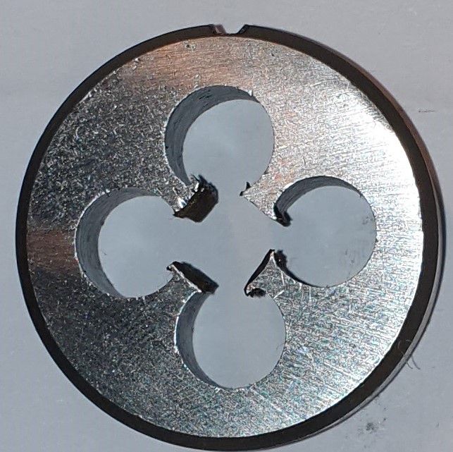

      20190528_143753.jpgUnused M10 x 1.5 die, absolute poop.
      Have written to complain.

        Ah, sounds like one of my days! Bronze is on my hate list and some varieties are far worse than others. Tough, hard, prone to grab and not straightforward to machine at the best of times. I wish I knew an easy way to grip a taper. Swearing at them doesn't work

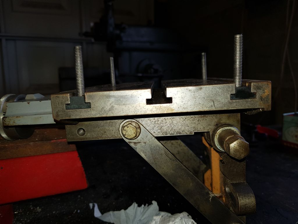

          Finished and blued up some tee nuts.

              Posted by Roy Garden on 28/05/2019 15:13:05:
              Unused? Seriously?
              Are you sure it's not a spare window for an OO gauge church?

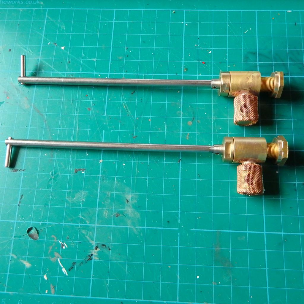

                After 2.5 hours of running and bending over the tender of my locomotive to reach the floor mounted water valves that feed the injectors i decided i had to change the arrangement so that i can sit upright whilst driving.
                So i made these which will be fitted inside the tender tank towards the rear of the tender. I have also increased the pipe size in doing so to get a good flow of water to the injectors. On the original pipe set up the injectors would starve of water and start to blow steam out of the exhaust. This always left me panicking that i might not get enough water into the boiler.
                Hope fully they will improve the set up.
                There 90 degree turn as well so i can now tell how open they are rather than the screw down type.

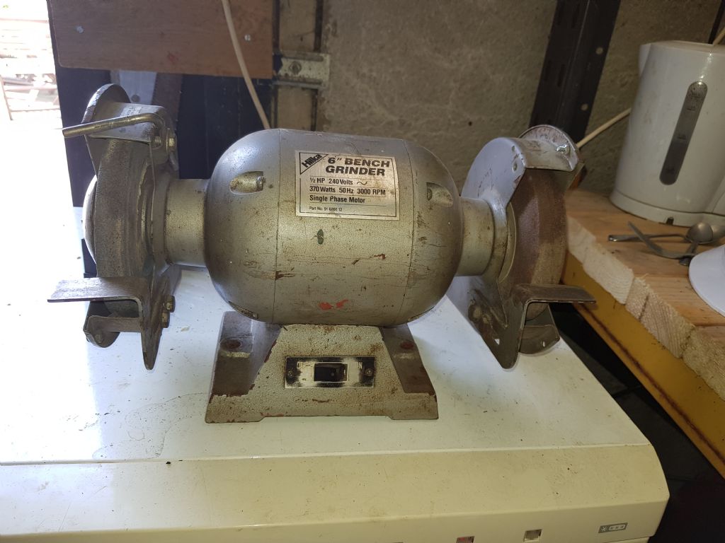

                          20190602_125636.jpg20190602_125641.jpgDragged the wife and kids around a car boot this morning and picked up a bench grinder £18, bottle Jack £4 and some g-clamps £4 for the 3.

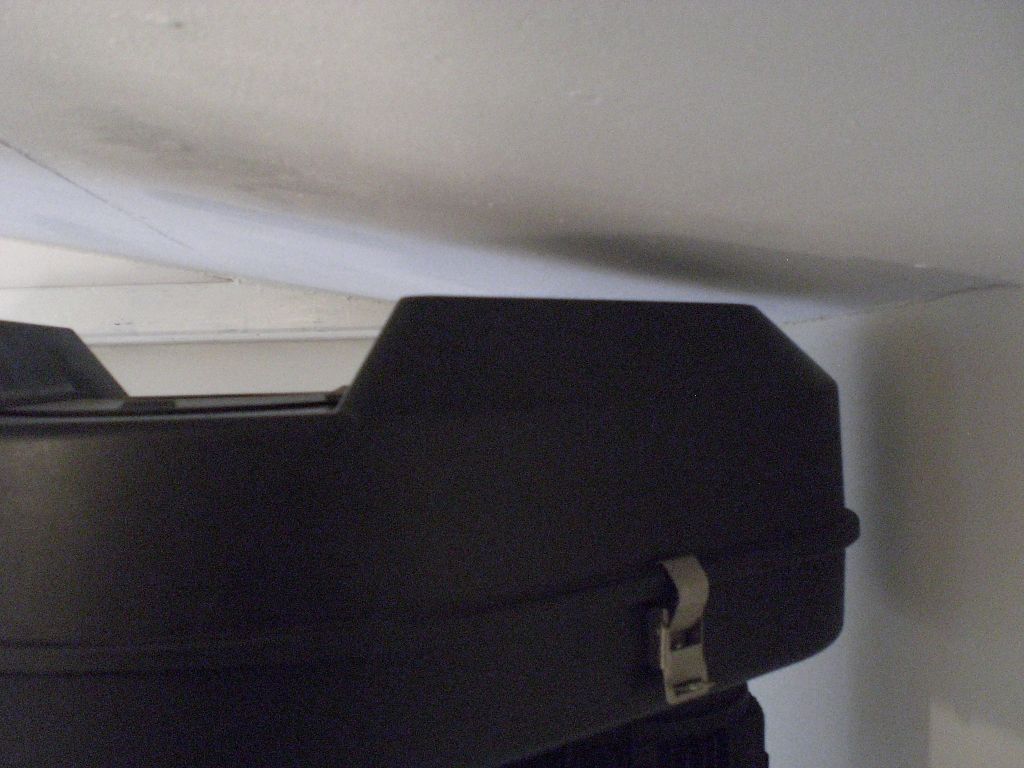

                                  Hi, it's been this week really, put a couple of top coats of paint on my milling machine stand and fitted the adjustable machine mounts, then fitted the milling machine into position. The green paint isn't a exact match, but it is very close enough for me and although it's no showroom paint job, it will stop the stand turning to rust.
                                  After giving it a bit of oil here and there, I raised the head up to it's maximum to make sure that I had positioned the stand the correct distance away from the wall behind it so there was clearance between the belt guard and the sloping ceiling.
                                  This proved to be OK, not that it is likely to be used at full height often. Just need to fit the DRO's and it will be ready for use.
                                  Regards Nick.

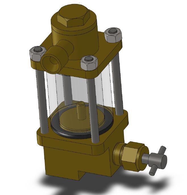

                                        I made a start on the hydrostatic lubrication today.
                                        New tanks made from 316stst.
                                        Whilst i was at it i decided to draw up the parts to check they all fit.
                                        I should have more control over the oil flow rate with this system. The original mechanical ones chuck out too much oil and the tanks on them are small.
                                        Bri

                                                Nick, regarding the belt cover and proximity to the slope of the ceiling, I have an older model of this mill/drill and cut the back end of the belt guard off, just behind the rear clips to allow the guard to be removed when the head is at max height.
