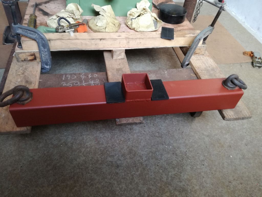

                                    Hi, today I did a test lift of my Warco Major milling machine. Firstly I made a suitable lifting beam to fit the machine, which is just a 660mm length or 75mm square hollow section which is drilled at each end to take an eye bolt and a short piece of the same section was welded on the same side midway between the eye bolts. The short piece locates into a square hole in the underside of the casting that moves up and down the column. Two pieces of self adhesive rubber are stuck each side of the short section, so as to act as a buffer between the casting and the lifting beam.

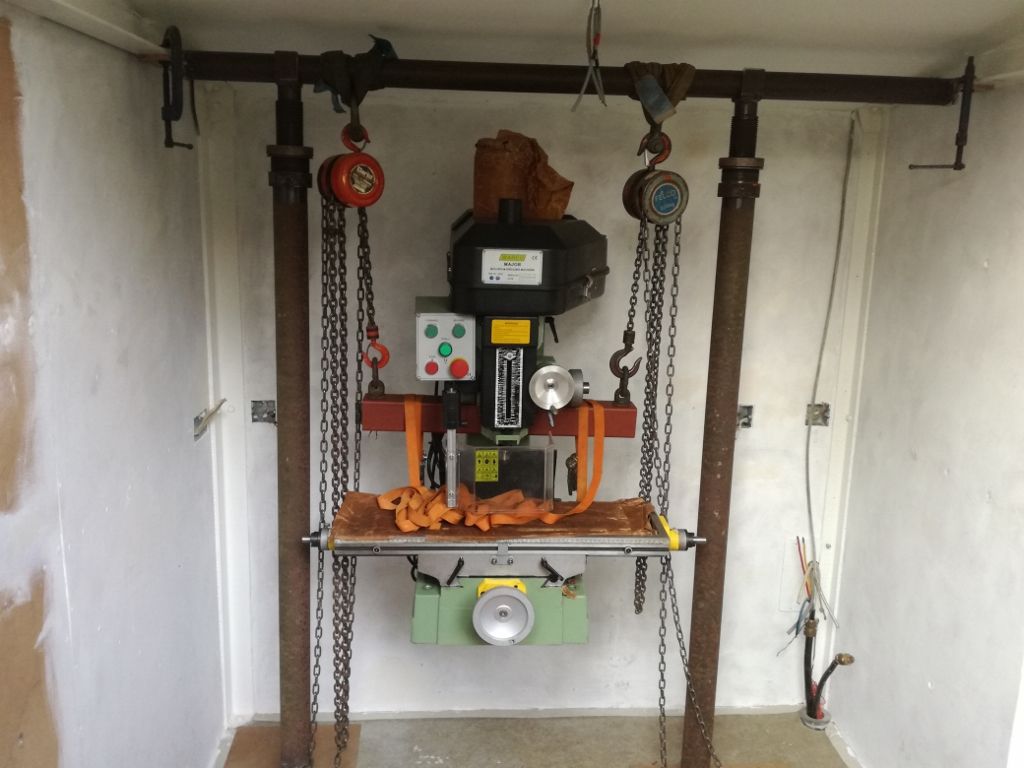

                                    A test lift was then done to test my setup and to ensure that I would get enough height for the stand needed. It may not be apparent in the photo below, but the tube that the chain blocks are hanging on, is only about 60mm or so below the ceiling, making difficult for any other way.
                                    Needles to say, it went very satisfactory indeed and I have a little extra height to spare if needed.

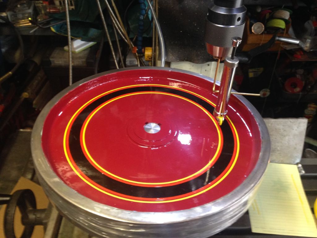

                                                      Today I added a new tool to my mill.
                                                      I am at the stage of painting the parts of my traction engine and for the flywheel, clamped a piece of round bar in the mill chuck as a pivot. Then used the DRO and a pen in the chuck to mark the outline of the black circle as a guide for applying masking tape prior to spray painting.
                                                      Additional colours were added with a Beugler striping tool held in the chuck.
