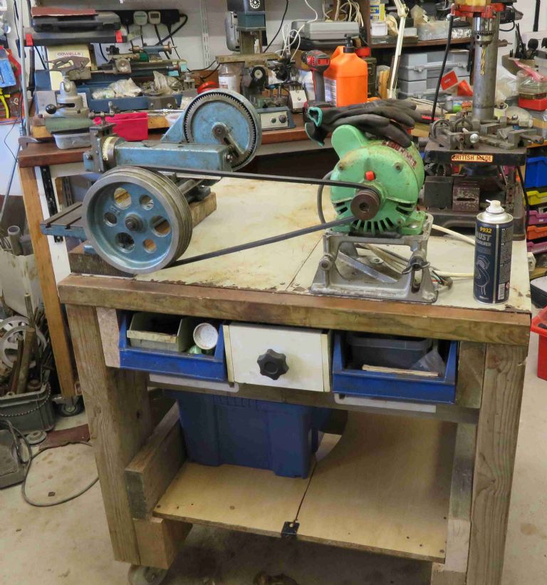

                                      I have finally resolved my queries re. the drive shaft centre separation on my Perfecto shaper, or rather, Robbo has.smile On the basis that his worked fine on an A350 belt, I purchased similar and it works fine – and fits easily into the space available.
                                      For those who don't subscribe to the GEFGW* school of quality and tolerance, I offer my apologies; however, the 'Flintstone' quality mobile bench suits its purpose admirably and, more importantly, I was able to construct it without assistance, in spite of the knackered knees and back. Next in line equipment-wise is getting the Myford back in service but in the meantime I'm trying to manufacture one of these …img_0038a.jpg

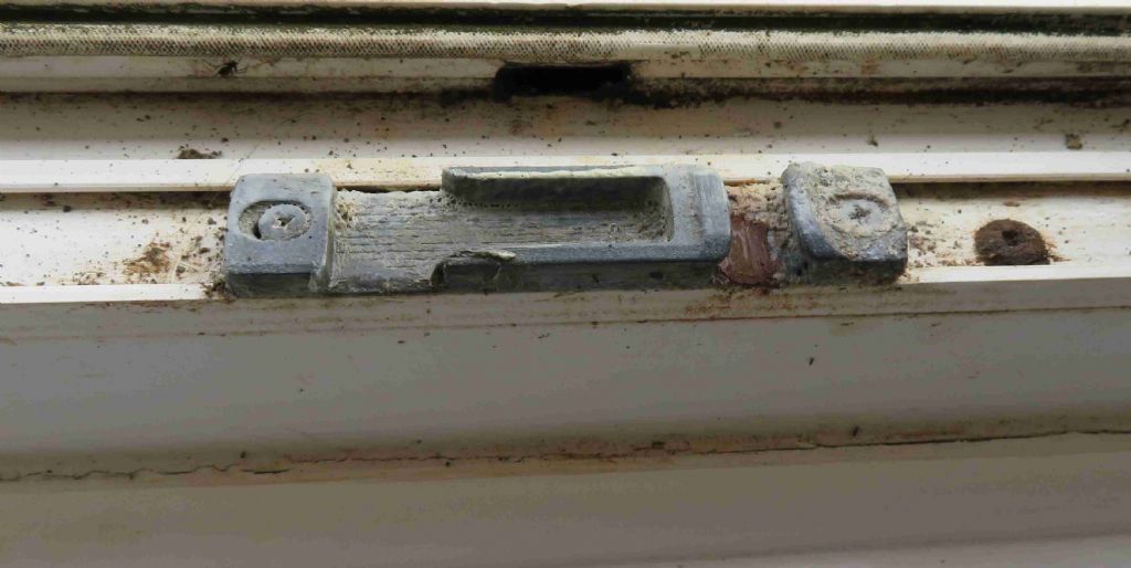

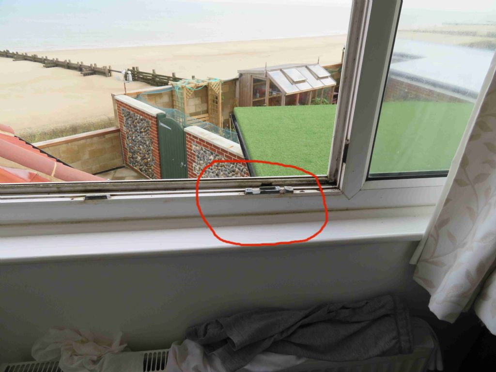

                                      … a 'turn and tilt' window tilt retaining bracket. We have two such windows in the bedroom and one of the brackets has corroded away. As the next photo shows, we are rather adjacent to the North Sea, so salt corrosion is a problem. I'm intending to make a new pair from some aluminium strip. The originals are cast from 'monkey metal'. From any of the experts' viewpoint is ali a reasonable substitute?

                                        Hi Bill, I'd suggest acetal resin. Blocks of Delrin brand acetal are readily available and not to expensive. It has a slippery feel , good strength, easy to machine, and is great for low friction hand-operated mechanisms like your window bits. No more corrosion either, sea or no sea.

                                            Bill, would bronze be a good replacement for the "monkey metal". For real salt water proofing of fittings 316 stainless is the way to go, but I think the bronze would look better and be easier to make. Don't know about plastics, but it might be OK.

                                              Thank you Jeff and Ian. I had considered Delrin but was concerned about the strength. Also checked on stainless but (at least on Ebay) suppliers don't seem to have any stock more than 6mm and I need 10mm minimum. However, thinking about the function, I reckon that all it does is provide location for the tilt axis – mainly vertical pressure rather than horizontal so minimal stress?? I'm halfway through lengthwise hand sawing a strip of tough ali to width so may continue , just for the exercise!!sad

                                                What, one of these? "Fuhr Tilt Tip Keep Striker Plate" – £10 inc vat.

                                                  Murray – to coin a phrase – BLOODY HELL!! I have been searching, in vain, for over a year for "one of those"!! The members of this site are quite incredible – is there NOTHING that they are unable to help with?? I have just ordered two off and will forgo the pleasures of another hour or so of hacksawing!! If you ever manage to venture into the wilds of coastal N Norfolk, there will be several bottles of sustenance waiting for you – you're a star!!

                                                    You have to get lucky with the search terms, like striker, latch, upvc etc – then peruse the "images" tab if using Google. When living in Canada, I found this aspect even more frustrating, as Mercans have different names for almost everything.
                                                    You can now apply the time and money to the purchase of some suitable workshop equipment by way of celebration. Just don't tell the domestic manager it wasn't required to complete the job!
